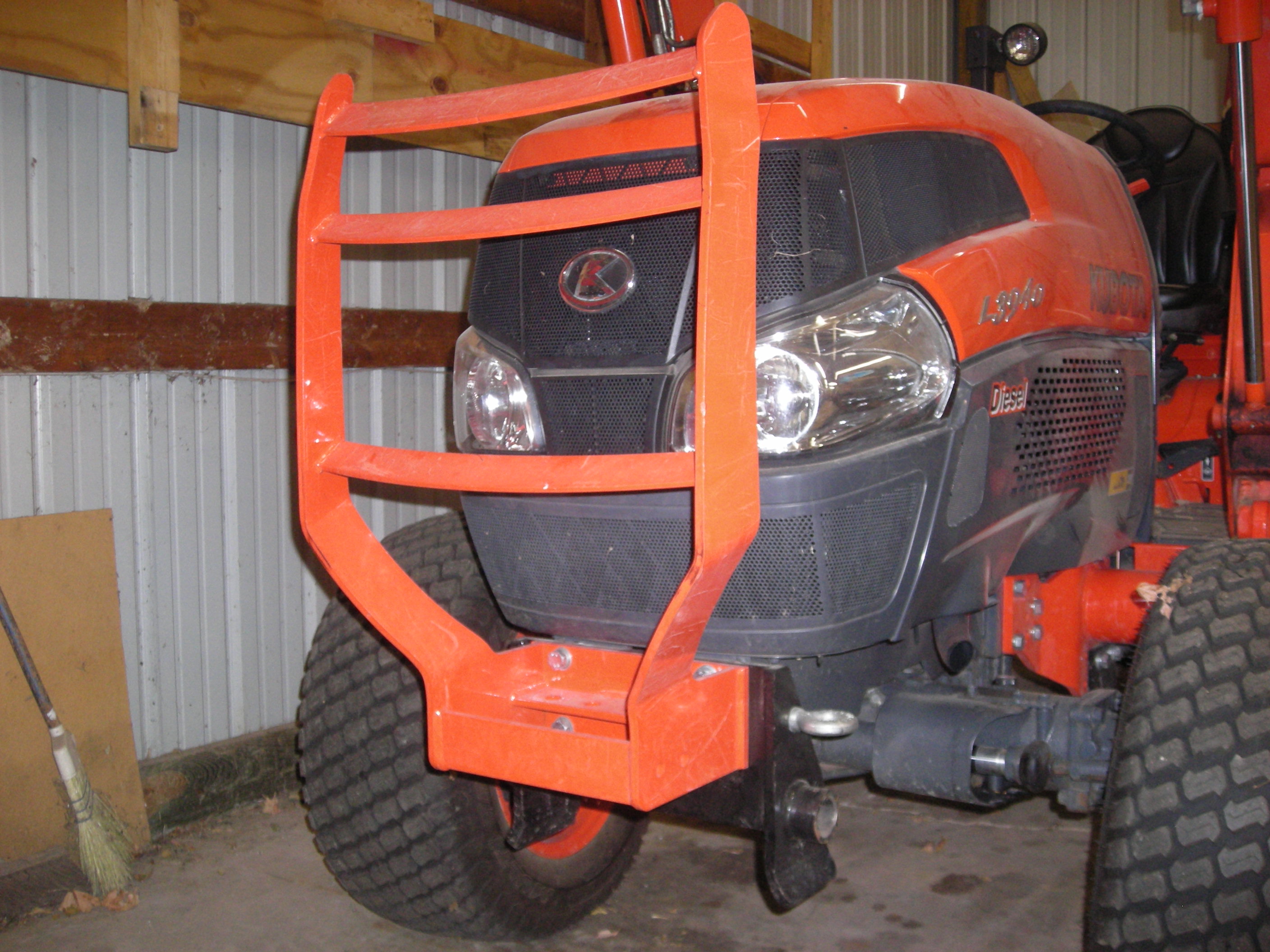

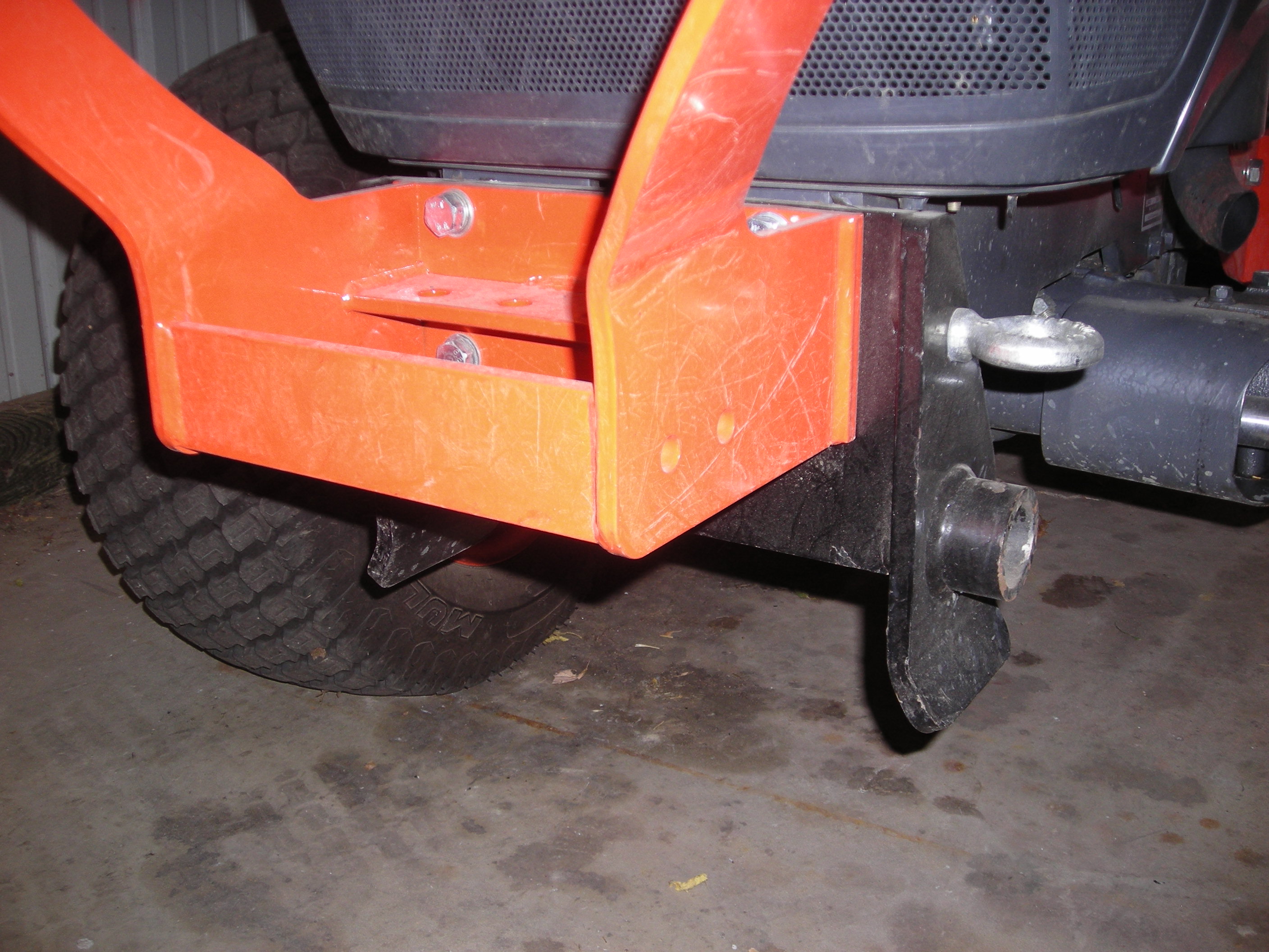

What do you hook to the eyebolt for a tiedown? The eye looks quite small as I use 3/8 chain. BTW, I wish I had a front blade for mine............:ashamed:
2" strap with hook. Philip.

Thanks for the pics. I thought that was what you would be using..........I use 3/8 chain and no straps..........

You could always add shackels to the eye bolts to loop the chain and grab hook around. I just hate seeing the paint scrapped off of his new grill guard by that chain. The rust will grow now. Philip.

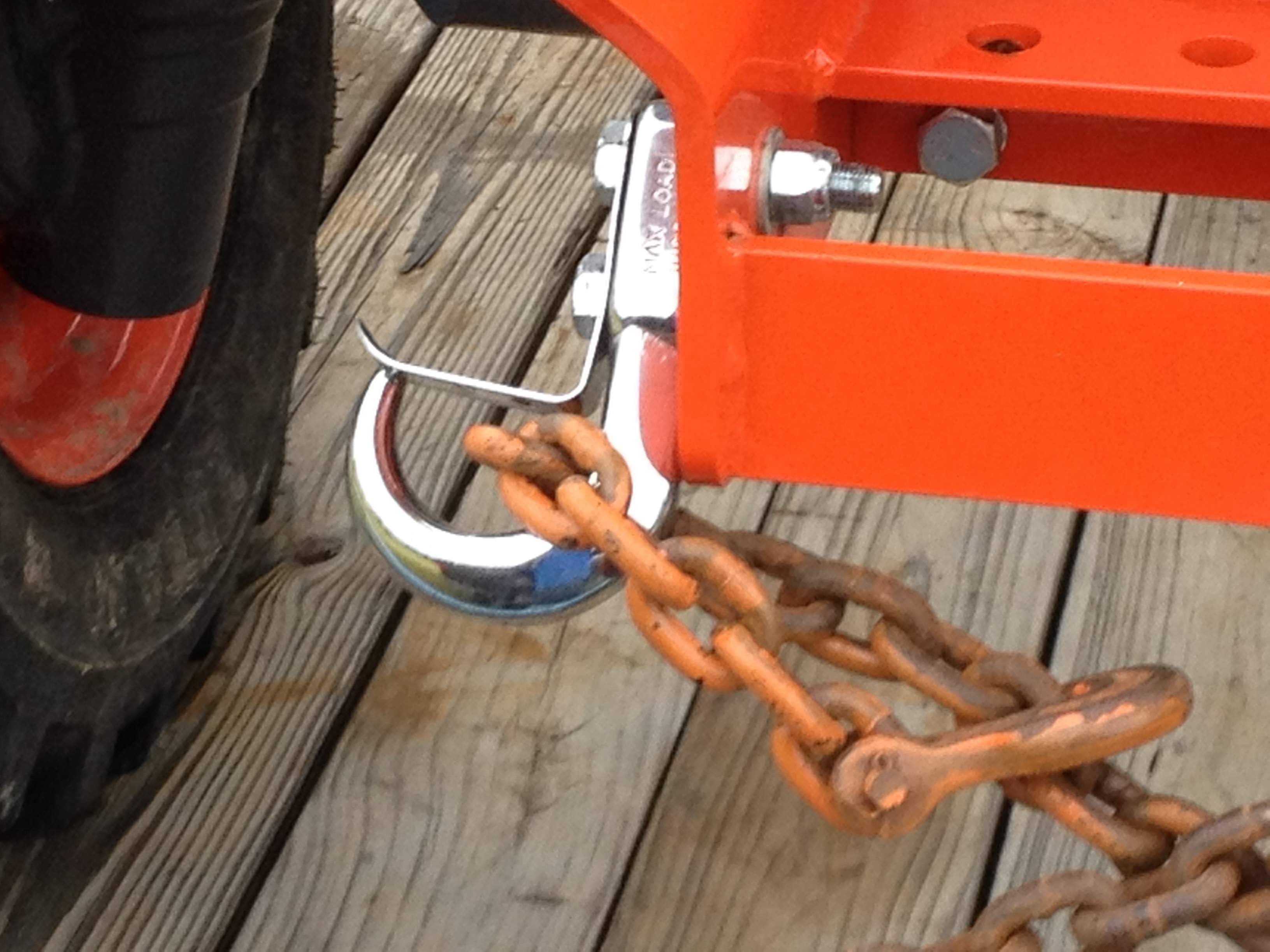

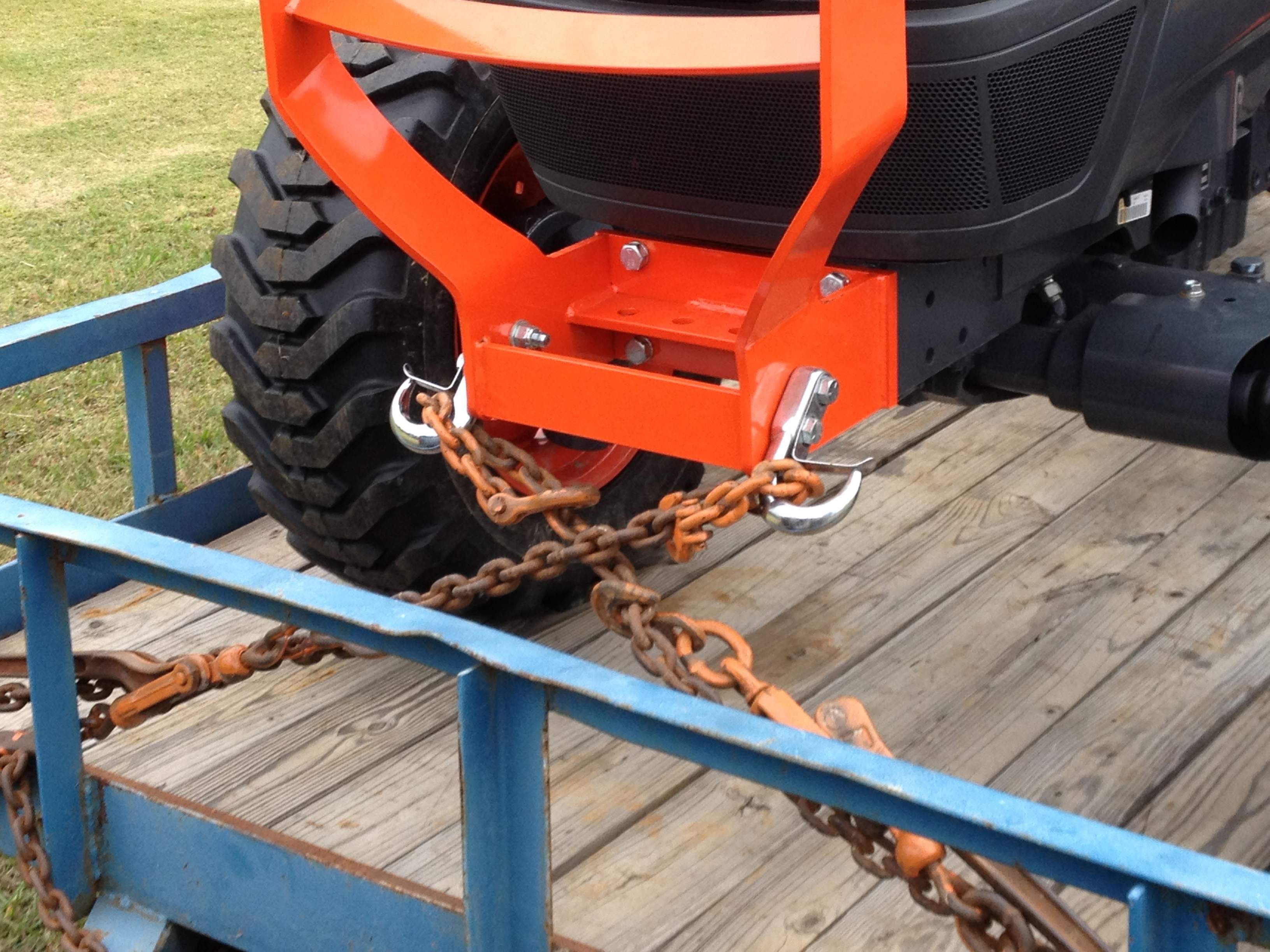

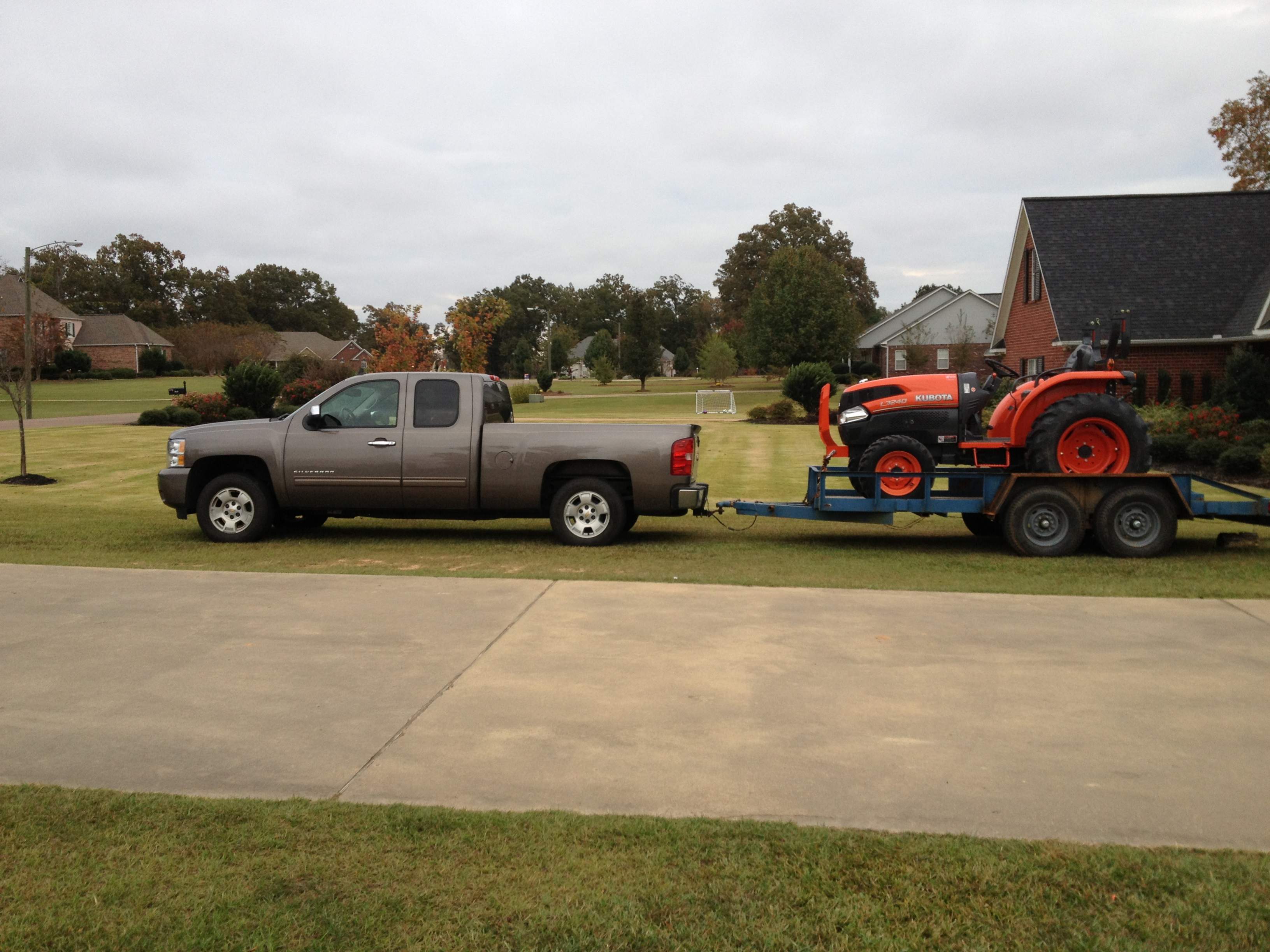

Nice tractor. But, who put that chain across your grill guard like that? Ouch! Philip.
Yeah, didn't like that either. Went looking for eye bolts around town like you and couldn't come up with what I wanted. Looking in the shed I found theseimage.jpg
This also gives me a good point to pull from!!! Not that the mighty 'bota needs it or anything!!!:)

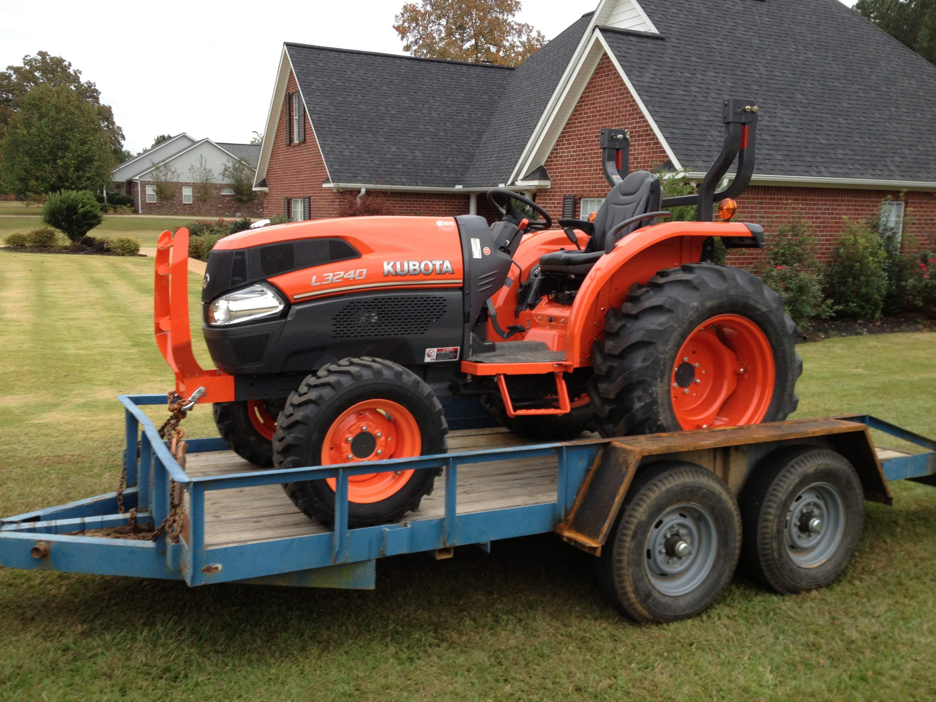

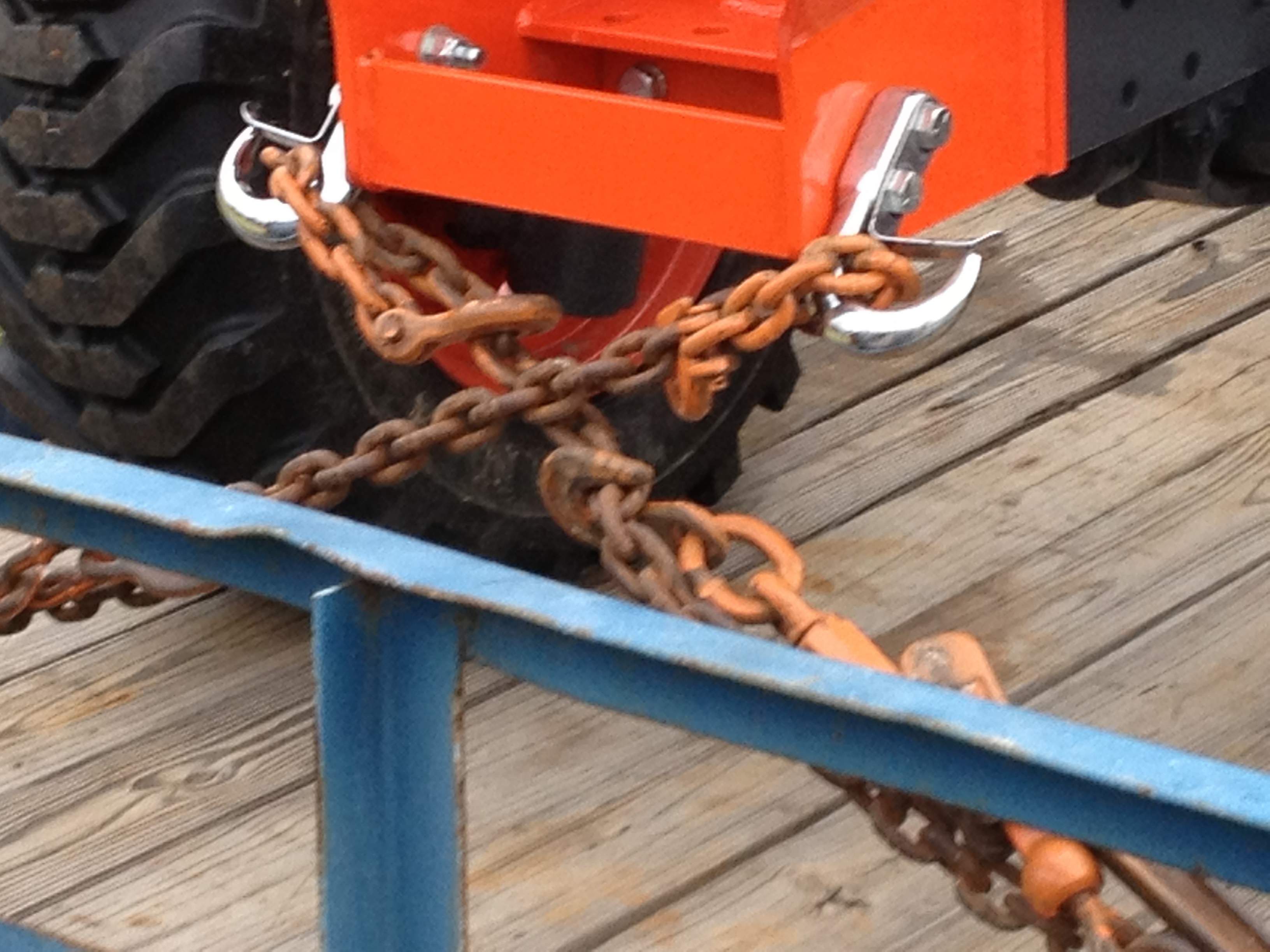

Sorry for so many of same image!!! These are the other pics...
/ My new 3240 #35
Looks good and looks safe. What do you use your tractor for??

Awesome solution! Much stronger than my eyebolts. I got the forged eye bolts, bought them online at Mcmaster Carr. Philip.
