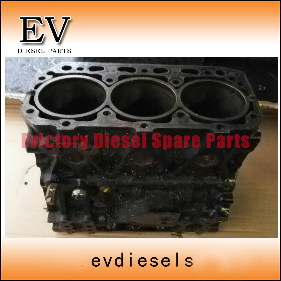

I'm thinking/hoping I found the problem. The bosses for the between cylinder head bolts were higher than the cylinder wall. In a couple of spots I was able to get a 0.0015 feeler gauge under the cylinder wall when going between these bosses with a straight bar. I took a large file and ran it across the entire engine deck and got these spots down to level with the top of the cylinders. Generally 0.0015" across a deck or head wouldn't be a problem but because these spots are only 1/2" away from the cylinder wall, separated by the cooling passage, I'm suspicious the the head gasket wouldn't be able to make it up. I'm going to spray all 4 surfaces with a recommended application of copper spray before reassembling this time.
Steve, if your head is still off you might want to check the block. I first noticed when scraping the old gasket residue off with a razor blade the blade hung up on that boss. All 3 cylinders were similar.

That's what I'm referring to, but the area around that bolt is not connected to the cylinder wall by the casting and the entire boss was high, not just the area around the threads. It's an "open deck" block. The 4 "thumbs" in this picture are the bosses I'm referring to as being a little high.
I don't think the threads are in any danger of pulling or failing, the head hasn't been off enough times to start causing any issues, especially in cast iron. I've seen threads start to pull in aluminum blocks with TTY bolts after 10 or so head swaps, but this head had only been off once when the gasket went.
