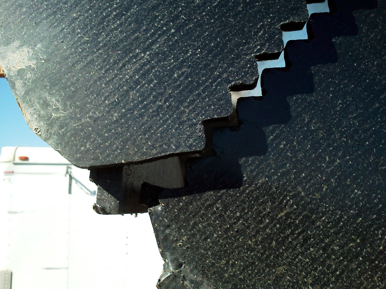

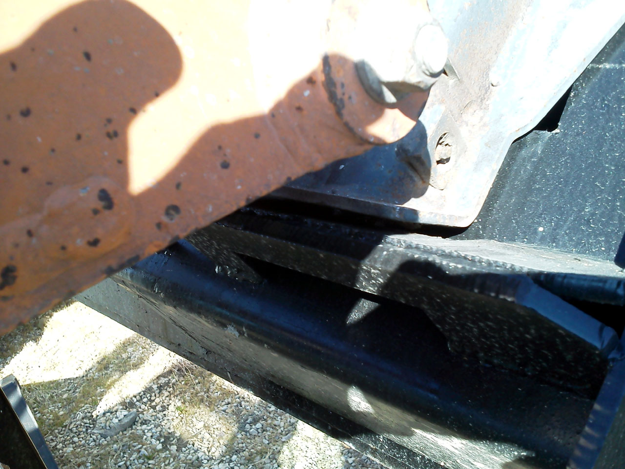

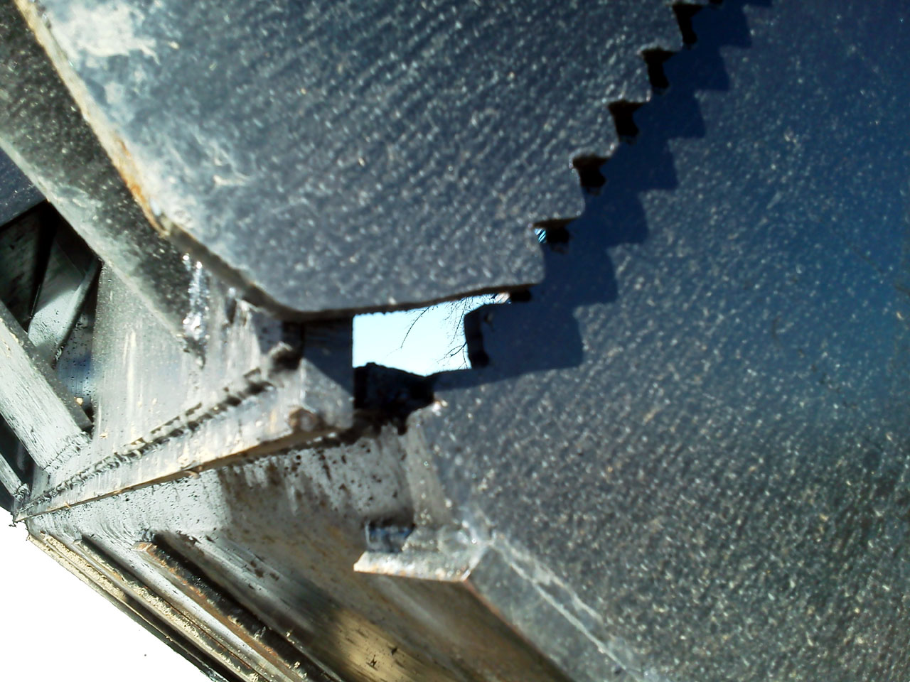

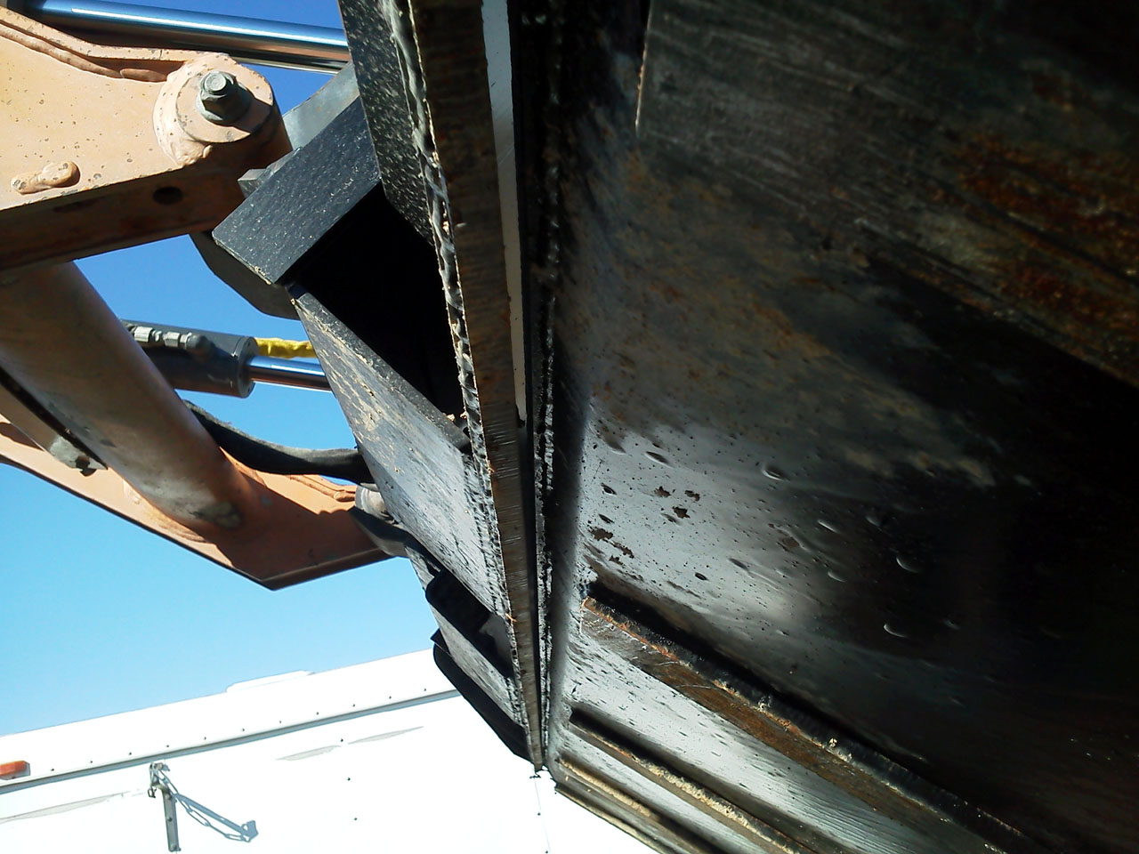

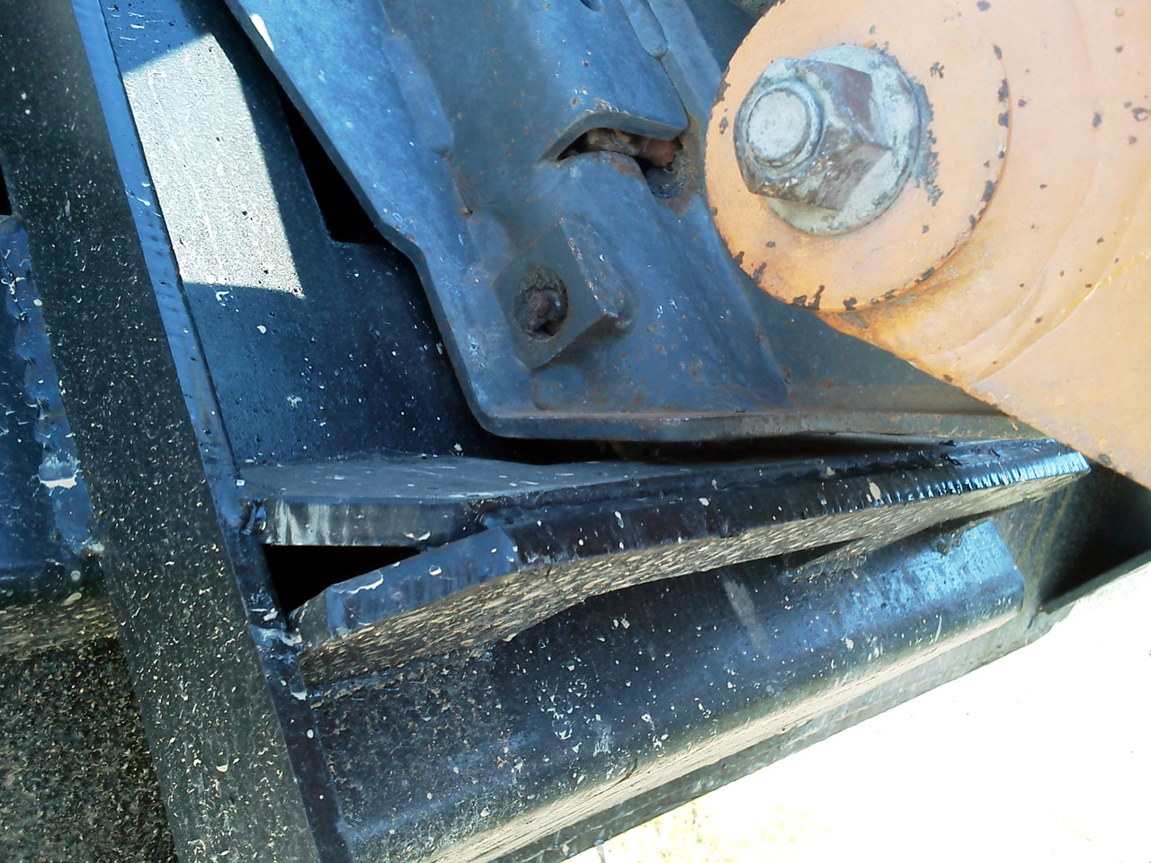

No bashing here, just the plain and simple truth.
I was going to let this go unless someone asked, but my devotion to the great members (and their great FREE advice) here on TBN won't let me. This is a place to share both the good and bad, and that's helpful when it comes to shelling out you're hard earned cash.
While the owner of the company was great to deal with, I can't suggest them as a source for attachments. You indeed get what you pay for.
Two things raised their ugly head when I finally got the chance to use the bucket for the first time. There was a major gap in the left side QA plate and a little smaller one on the right. Up and down and QA face to face. Not a little "lets shim it up" gap either...we're talking a bunch! Also, the clam wouldn't stay even remotely closed with the bucket in the dump position. The weight of the clam was too much for the cylinder. All of these flaws together made for a very heavy rattletrap of a bucket. I was informed that I must have accidentally been sent a "second". He apologized and said that their quality control department should have caught it. The bucket was returned and another sent out.
The second bucket (no pun intended, cuz I ain't laughin') was far worse than the first! The jaws weren't lined up at all with a 7/8" daylight gap on one side. The clam and dozer cutting edges were way off, closed on one end but 1/2" apart on the other as well. The fitment of the QA plate was once again horrendous.
When I contacted the owner he related that he hadn't actually inspected the bucket before it was sent out and that I must have accidentally been sent a "second" again! I'm thinking...you already sent out a flawed bucket and have an unhappy customer...and you don't even check it out first? Quality control my butt!
The owner related in another email that neither bucket should have been sent out to me...then said that I would have to pay for the return of both buckets! My response was NO FLIPPIN' WAY! :mad:
So I ended up only being out the shipping on the original bucket and finally got my check in the mail today.
What I don't get, is that I told him that I had started threads here and on an equipment forum. You think he would have made sure that (at least) the second bucket was right! I'm just figuring that he doesn't care. :confused3:
   / My New 4in1 Bucket Came In!
#69
They say the proof is in the pudding. So to remove any doubt...here's the pudding.
The first bucket.
The second bucket in the fully closed position.
I tried both buckets on my tractor for QA fitment. Same thing.
