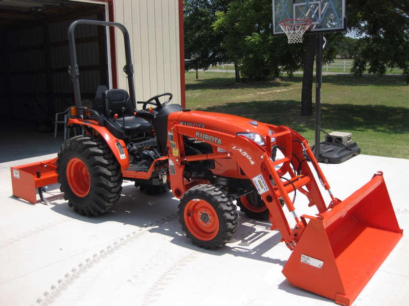

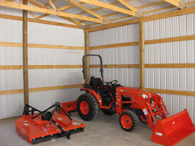

Finally got my new B3200. It is awesome! Bad thing is it is 107 degrees outside.

Real perrrrttttyyyy. Hope you enjoy it. Take a lot of pictures, it will never look that good again.

Congrats!!
I really like mine, wish I had hooks on my bucket like yours
Enjoy

I just noticed the hooks myself. I am somewhat new to tractors, but there are many threads on this site that say you should never mount the hooks at the far ends of the bucket. They specifically state that the hooks should be in line with the loader arms, or the arms can get twisted and off level with each other. True or not, I can't say for sure, but why take a chance with a brand new tractor. At the very least, I would do some research.
/ My new B3200 #8
Also, if the chain swings around the end of the bucket it will slide right out of the hook. With the hook in several inches from the end this is much less likely to happen.
Regardless, looks like a nice setup, what kind of box blade is that?
/ My new B3200 #9
Very nice tractor and cutter.:thumbsup:
As to the hooks, a lot depends on how you use them and position your chains, there is a good thread on here, but I can't find it right now. I like to loop a chain between the two outside hooks and then hook a chain to it to spread the load as shown by another member, but I don't lift anything very heavy usually.
/ My new B3200
I haven't used the hooks yet. I plan on looping a chain to both hooks when I use it. I don't plan on lifting anything real heavy.
The box blade is a Land Pride BB1260.

Very Nice Unit, Like its Home a lot also, I thinking about something about that size also, to keep my B3200 in. Have lots of fun, and I hope it cools off soon. I am currentley working in up state New York, and its very nice, but I get to go home to Louisiana at the end of July, and I know the heat is going to get to me.

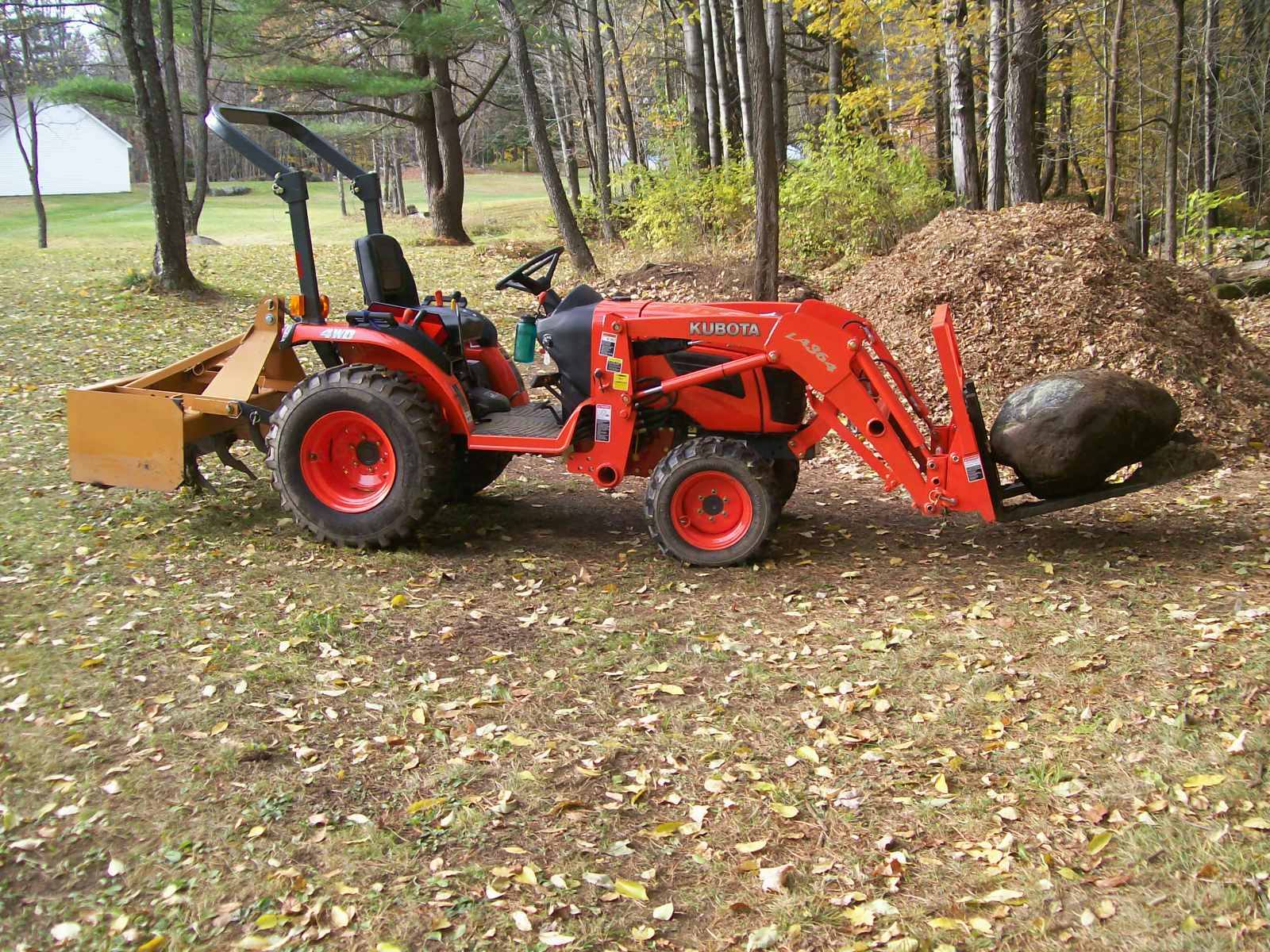

I used the outside hooks on my loader quite a bit, but normally the load was pulling the chain tight towards the center of the loader. For moving large rocks I would get the bucket lip under the rock, and loop a chain from one outside hook, around the rock, and to the other outside hook, and then use the curl to lift the rock, and tighten the chain before lifting it. Now, I often use my pallet forks instead since they are so much nicer for loads like that, and I can get the load closer to the pivot pins.

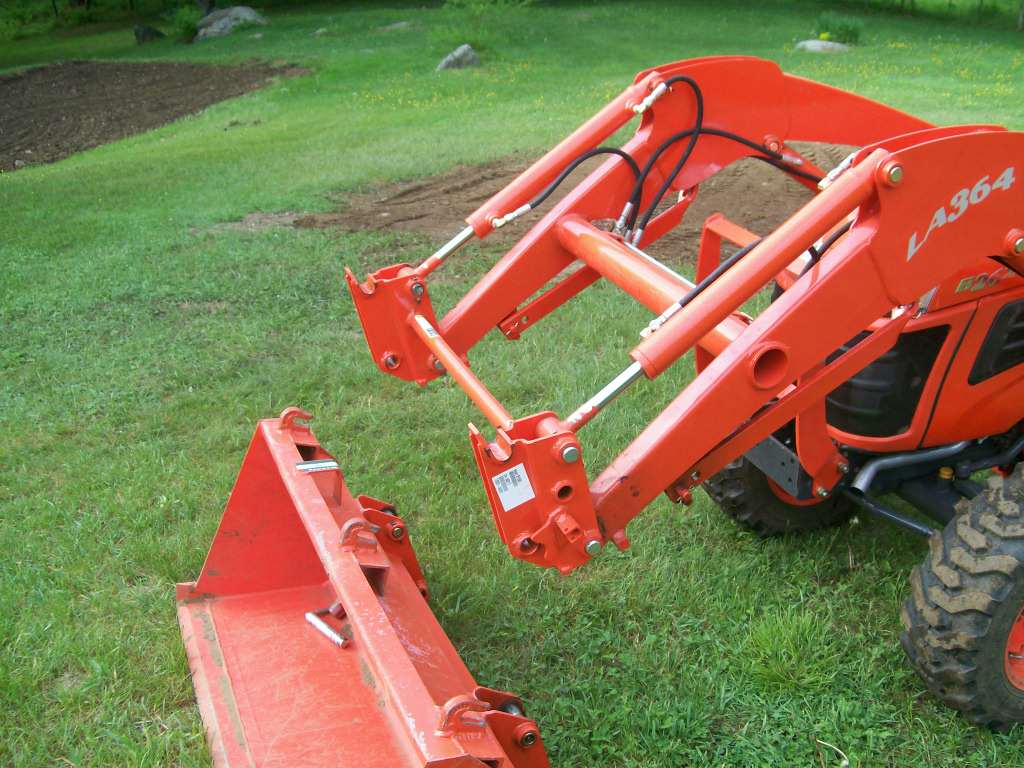

ChickinNH... that picture of yours, is that the quick attach coupler setup?
Oh and Sackperson... that's a great looking tractor and a nice looking setup you got there!
Yes, that is the Kubota QA that sells as an option on the B3200, etc. I found that the loader was the same dimensions as mine so I bought the QA, and a set of Kubota forks. The lower pins still take a little tapping, but it sure beats taking the plain pins off. I had both the forks, and bucket on a couple of times today, and I sure like being able to do that! Here it is with the forks installed, and being used.

ChuckinNH, What did you mean (the pins took a little tapping?} Did you mean the pins needed a taping with a hammer, or you had to tap out the pin holes to make the pins fit. I am very insterested in a setup like yours. Thanks.
/ My new B3200 #20
When you install the QA there are two pins that remain in the implement in the top two holes, and two pins with handles that you pull out to remove the implement. The distance between the top holes, and bottom holes on my QA were just enough different that I can't quite install those bottom pins by hand, and need the assistance of a hammer usually on at least one pin, and sometimes both bottom pins. I need to clean those holes up with an expansion reamer, or perhaps just a wooden dowel with some emery cloth around it. Both my forks, and bucket fit the same way so I'm sure the interferrence is in the QA itself. It is close, and if the planets are in alignment only one pin requires slight tappiing. My dealer probably has a 1" expansion reamer that would fix that right up, and it is on the list of things I want him to look at the next time he has the tractor, or is here servicing it. Some have reported that their's fit just fine with no assistance needed, and some have to tap a pin like I do. On the top of the QA there are two hooks, much like the JD set up that you can see in my pictures, and it helps put the planets in proper alignment, of course if you make sure those are clean before you try installing the other implement.
