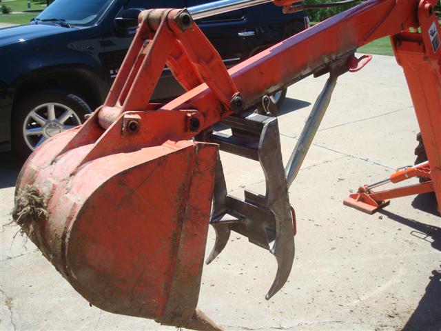

I AM somewhat limited from picking up very large rocks, but if I can
not get my thumb and bkt around it, it is prob too heavy anyway. I am not
limited at the small end, as you can imagine with this photo. When my
thumb is perpendicular to the boom, the middle bkt tooth meets the end
of the thumb near its tip. If I put much more curvature in the thumb, then
long thin objects like branches or pipes would not be firmly grasped.

/ My new backhoe thumb #26
ahh your "full crowd" coment had me confused, i thought you meant when the bucket was fully curled the bucket would clear the thumb.
i plan on mounting mine where when the bucket is at 90 degrees from the dipper stick the teeth will contact each other, much like yours in the pic

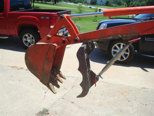

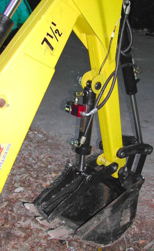

I put a very slight curve to my thumb jaws, but teeth quite a ways up, not knowing what I'll end up grabbing with them.
You can see them folded out of the way and then how they meet the bucket teeth.
Here's how I made mine.
/ My new backhoe thumb #28
dfkrug said:
Looks fine, RCR. Simple, effective, and you got to recycle some leftovers.
My first thumb was straight, too, and the subsequent ones all had just
a slight curve. I also found that I had plenty of grip with either no teeth,
or just a few small teeth.

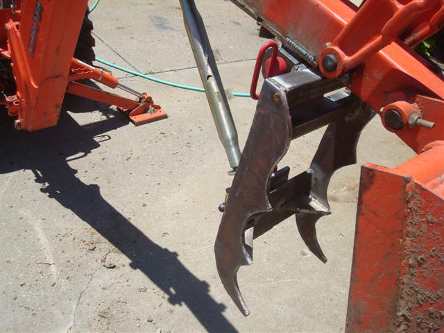

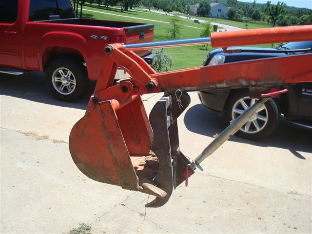

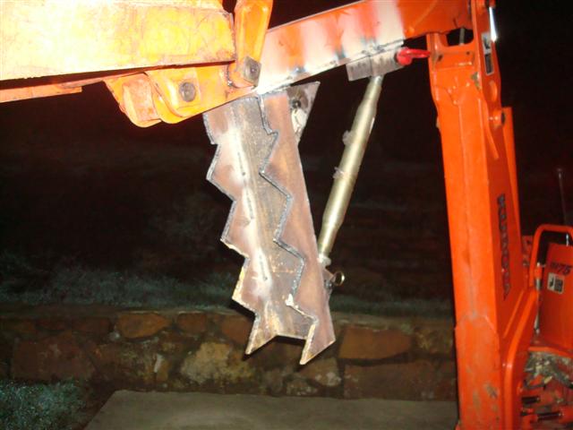

so from what your saying i really did not need to spend the time to make such agressive teeth on mine. how about the webing between the teeth, i noticed some have nothing and some are almost solid. Have you noticed any advantage either way? now that I have the rough in done and looking at some of the other thumbs a little closer on here i am thinking of 2 things, make it lighter and wider. light part is easy, wide part hmmmm

If you want to pull t-posts, or god forbid a 4x4 with those mean teeth, you'd better do something where the bucket tooth hits the thumb teeth.

I grabed a sandstone by the corner and it just shattered, it was awsome. lol
now im going to have to do some dental work i guess, want the thing wider, lighter, and painted

I enclosed the center part of my lastest thumb with steel plate because
it made the thumb stronger and it helped to hold dirt in the bkt when digging.
The thumb undergoes tremendous off-center forces when you grab things
like rocks. The wider you make the thumb, the more twisting torque it will
need to endure. If you go more than 4" wide, I would suggest using a 1"
or larger main pivot pin.
RCR also has a good point. Some jobs you have may be easier with the
thumb shaped a particular way. I found that a wide thumb tip made of plow
steel held up better than pointed mild steel. Mild steel wears fast when it
encounters lots of rocks.

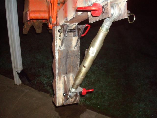

did not have time to paint it yet but here is the rework on the thumb, was to anxious to get out and try it out. went from 5" wide to 10" wide, bottom teeth drop below bh teeth, less agressive also.
works like a dream on rocks and ripping out brush

Ah man! You went and made it prettier. So, give us the lowdown between narrowor vs wider.

Forgot to ask, do you ever adjust the Top link length?
/ My new backhoe thumb #38
narrow vs wide hmm, id have to say with the wider stance it easier to grab and move the stuff while your working with it. I spent the day ripping out weed trees and moving rocks and it performed perfect. my biggest thing on the first design was the solid bottom and the way the bottom teeth were made it was dificult to grab things pusing the thumb foreward, with the open design there is less mass moving through the dirt and things flow better. I also went slightly below the teeth on the BH with the teeth on the thumb, weather or not this is good or bad is yet to be determined. i was able to use those bottom teeth many times today to help position things.
have not adjusted the "top link" at all and I have to do some adjustment on the top brakets so i can fold it out of the way. I am also have not used it with my grade blade yet to see how that works out
