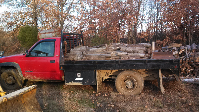

With all that work, its going to be a "new", old truck. Ha. Used nous today to haul firewood. Had to install a new door after a run in with a tree, but no big deal.

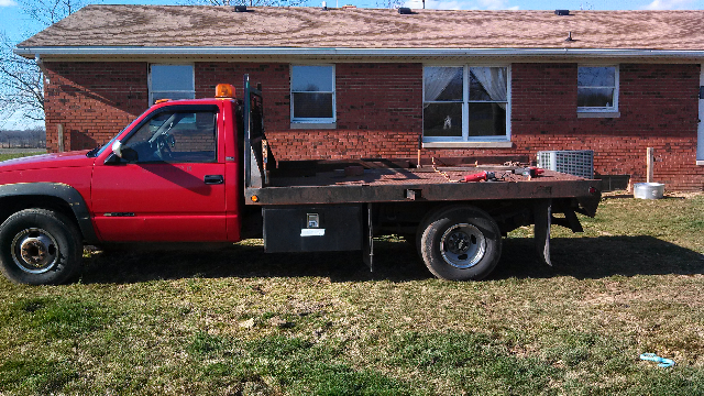

Another update! I got the front of the truck back together today! New breaks tie rods shocks and steering stabilizer! Just need to get it aligned!

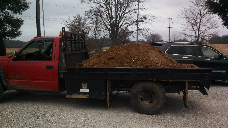

Its been a wile since I've gave an up date on this truck but it has not changed much still working out the bugs and took the big tool box off the top of the bed! One question tho! If I go out in the morning after it has set a wile it fires rite up but if I drive it somewhere shut it off come back thirty mins later its hard to start? It is a vortex 7.4 454ci thanks

Timing is off.

If the check valve at the fuel pump is bad it can cause a 'vapor lock' type condition, common in some vehicles.

I second the fuel pump. The check valve leak will also cause the first start issues after sitting. Try cycling on the key for 3 second intervals a couple times before cranking and see if that helps.

my buddy had the exact same engine in a suburban, and the fuel pump went on that thing a few times...seemed to be a weak point.
other wise, the truck was bulletproof.
huge amount of torque
