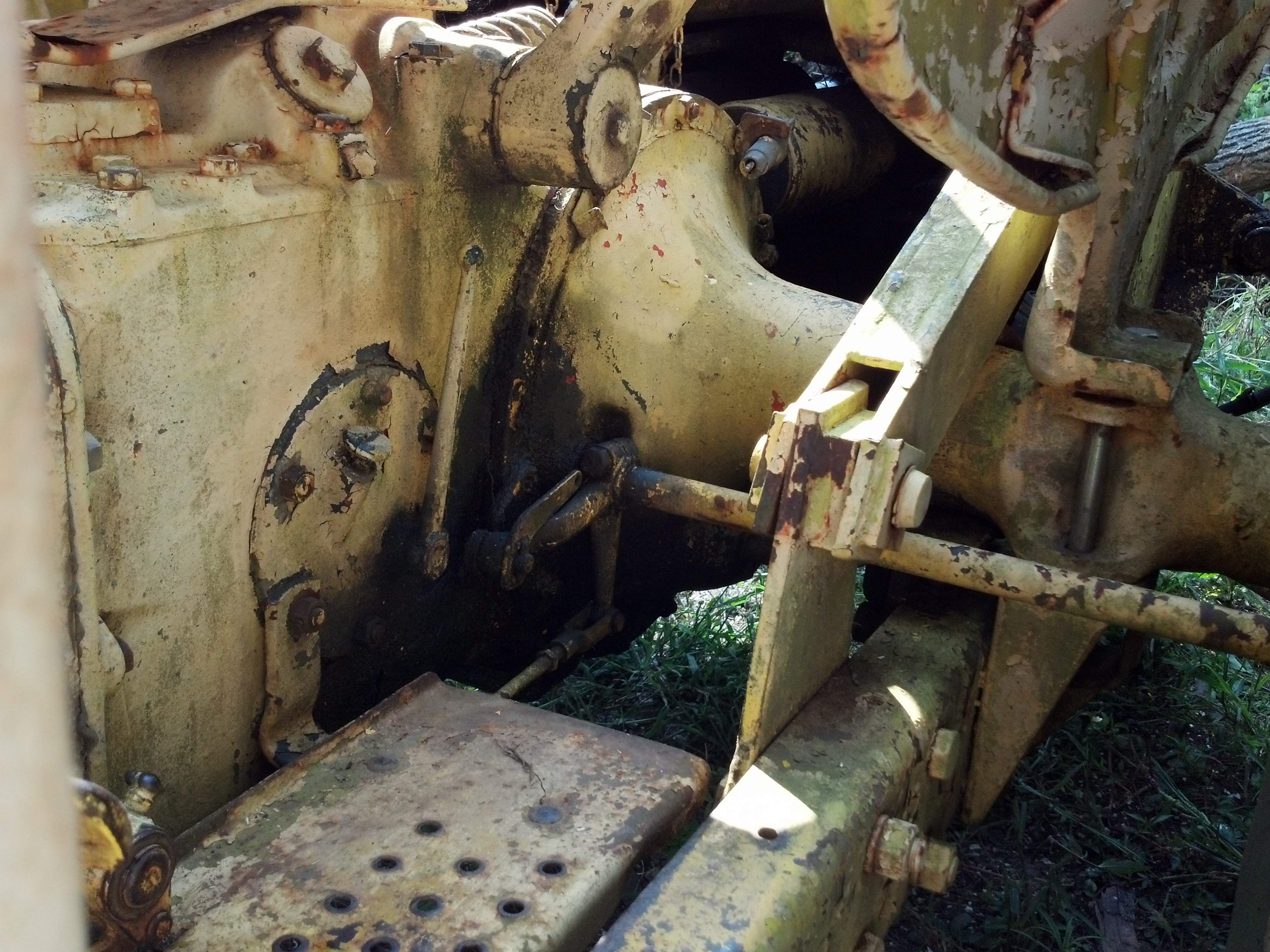

This is your PTO shift lever. Pull forward to about 10-11 o'clock to disengage.
This lever beneath the seat determines how your 3 point works. The position it is in now is called Implement Position Control. If you flip it so it points down that is called Draft Control. Your touch control lever (runs in a arc just above this selector) functions differently based on a position of this lever. A moot point anyway, as you cannot hook anything to the 3 point with the hoe on it.

onthe brakes. it's just mechanical drum brakes. it has a star wheel adjuster under alil clip / plug on the brake back panel.
as for the hyds.... that lil mushroom cap with the dip stick is the hyd sump..
