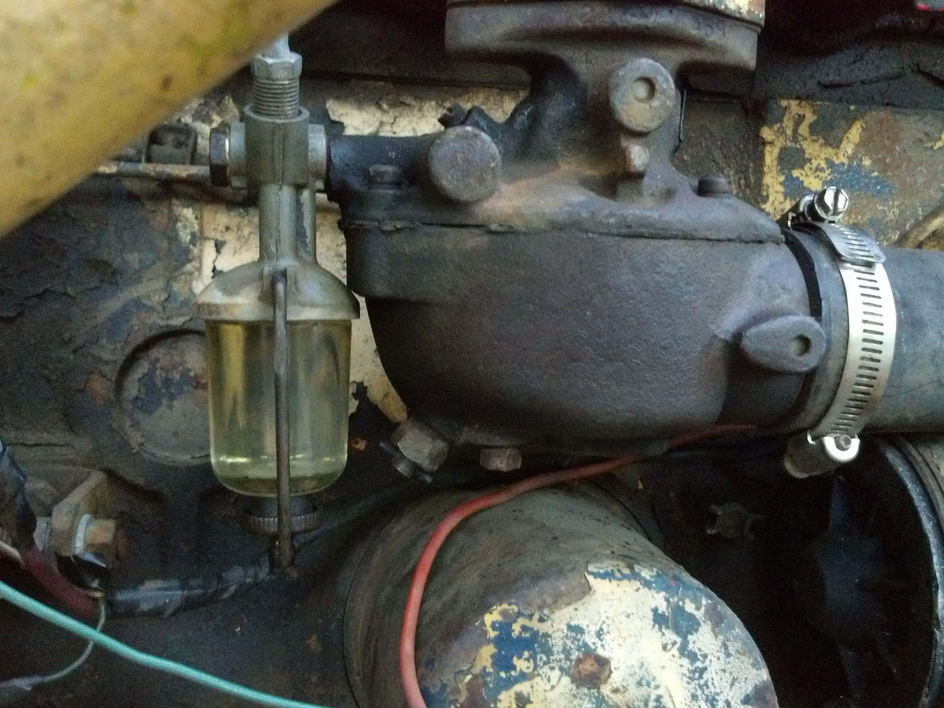

OK Problem today... I was working on stuff in the yard, had it in first gear and was going down a slight grade. I was letting the engine act as a brake just like a car going down a hill it was working fine and then near the bottom it puttered and stalled. I have checked everything I can think of and still nothing is getting it started. I have plenty of gas I have checked the bowl filter and gas is flowing perfectly.
I have drained the gas out of the carburetor (not sure if this is a mistake or not) but it made no difference. I checked all the spark plugs and they're fine. It fires 2 or 3 cylinders if you leave it sit for a few minutes and then nothing... Almost acts like it's getting no gas. Do I have to prime this or something? Using Ether on the air filter I get it to fire about 4 to 6 cylinders but then nothing again... almost acting like it's getting no gas????
Suggestions? -It is sitting slightly toward the left so the carburetor is on the low side ...but we're talking a very small tilt to the side maybe 3 or 4 degrees at most. Without proper manuals I am at a loss as to what else to try?

Everything seems to be working fine from a linkage standpoint. I have not removed the carb yet to see if things are moving properly inside. Perhaps I need to clean the carb out really well? I was reading other threads and perhaps that is the issue?
OBSERVATION: I drained the fuel out of the carb and the sediment bowl. Put the bowl back on after cleaning it out and checking the screen. Replaced the plug on the bottom of the carb, then I opened the fuel line. The bowl did not fill... I thought it would fill up to the top and then proceed to fill the carb up until the float shut off fuel flow. If this is not happening I suspect something is clogged in the carb which is preventing the carb from filling properly. -Am I right?

Yes, sounds like something is clogging the carb or your float is stuck. Carb is simple to take off. Take off hose from air cleaner. Do you still have the metal fuel line all the way? If so loosen the fuel line to carb and then undo the two nuts and take off carb. Undo choke and throttle while slide carb down.

My fuel line has been partly changed over to rubber so I can just loosen the hose clamp on that. But I think I need to remove my little bowl filter fitting anyway so I can properly remove the bottom of my carb. Here are some pics.
