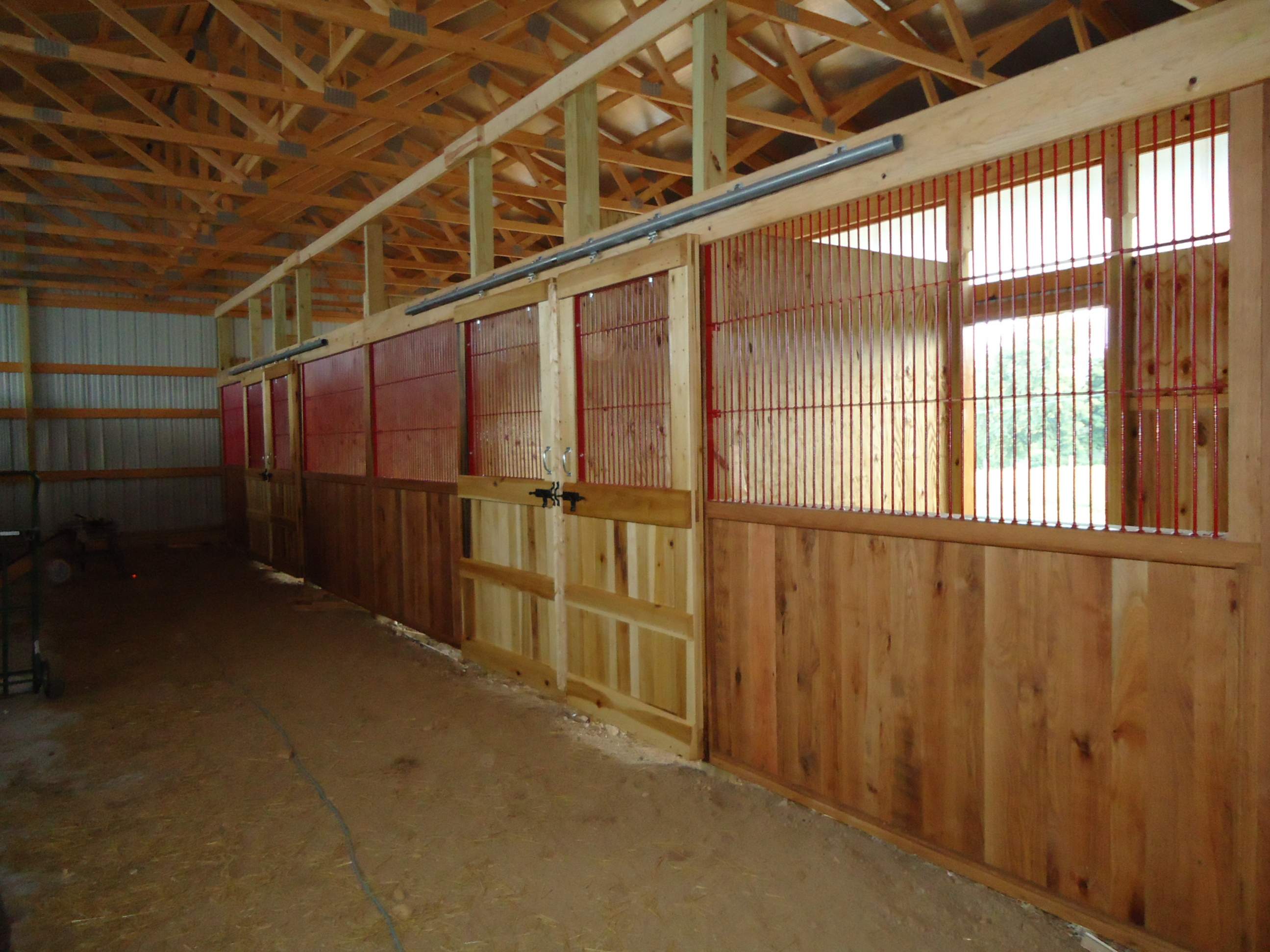

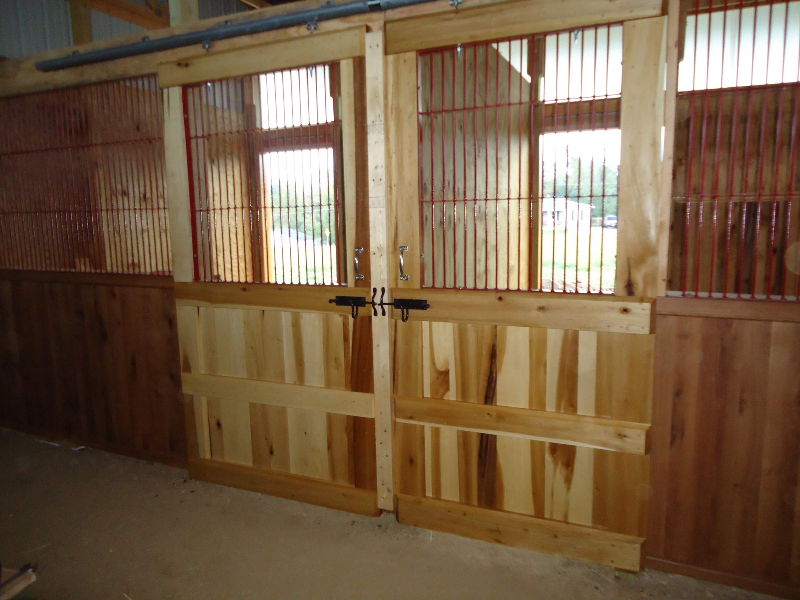

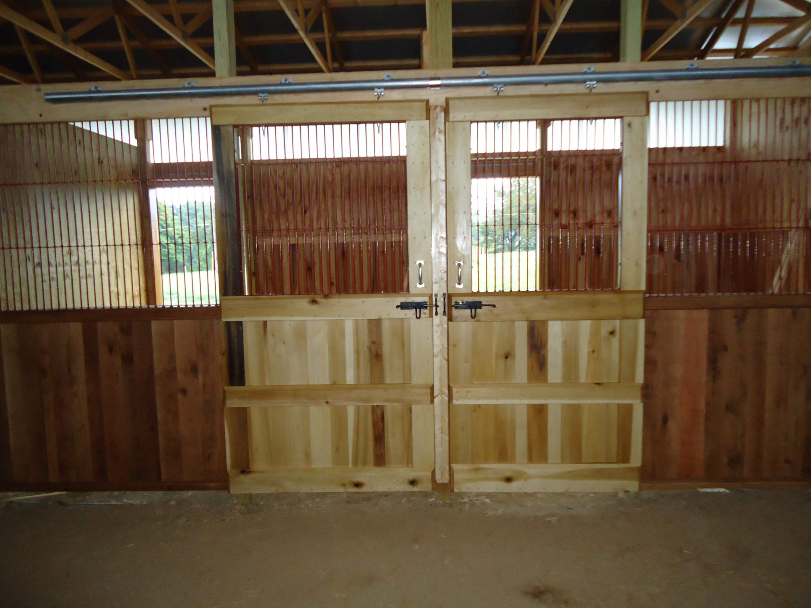

Got the hardware on my last two stall doors yesterday,and a coat of sealer on them... Love that Cannonball track..!!

I really like the narrower grill work, I assume it's steel? Usually they use something about the size of 1/2" conduit and it looks like a prison. Did you buy those doors as a kit, or did you make all that from scratch?

Got the track and trollies from a local lumber store, not big box type... Should be able to Google Cannonball track, and find a local supplier in your area. Those doors probably weigh close to 125-150 lbs. apiece, and you can push them with one finger...
Sure you got horses good enough for this...!! Love them long ears too... One of the stalls is for my mammoth donkey, Percy... He is a hoot..!!
Everything you see, except hardware, is built from scratch. Grill work is simply 1 1/2" X 1/8" flat strap. Rods are 3/8" round stock. Cut straps to length, tacked together on the ends, then measured, and center punched 2" O.C., then drilled in a stack. Inserted rods, and tacked on the bottom, then seperated the flats, and spaced at 16" with spacers.
Stall fronts are white oak, all ship lapped. Doors are Poplar, panel ship lapped too...
I need yet to set a stubby 4X4 on the one end to hold it in. I usually set a piece of 1/2" plywood between, for a spacer. These are much like I have here at the old place, and have held up very well for 12 years.
I'll get some pics of the finished interior today, as it is all ship lapped Poplar too, at least the bottom half.

I prefer the pendant bolt type trolley, because the bolt is bent in a configuration, so as to adjust the door in and out for clearance.

Every rod, is welded where it goes through a flat. I cut 2X2's, then cut a rabbit in the center to go over a rod, and space the flats @ 16", except the top. Lots of holes to drill, and lots of welds to make..., LOL... But they are very ridgid..!!
Welded tabs on, made from the 1 1/2", 2" long, and put a 3/8" lag screw through it, into the poles, bottom, and header across the top.
