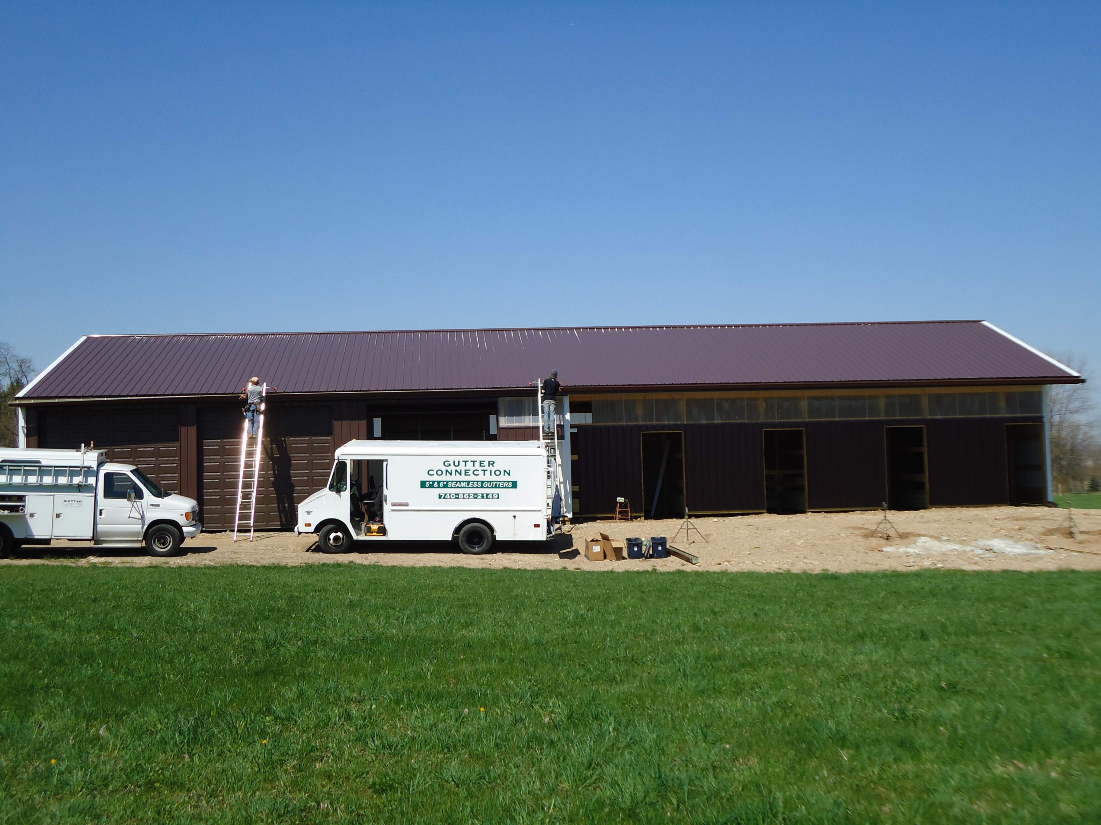

Guess maybe I should have posted a pic of the outside first... Here is a shot of a buddy of mine, and his son installing the gutters. Kinda' puts things into perspective, as to it's size. (42' X 96') The two bays to the left will store my 3 trailers. The 3rd is a straight shot though, with another OH door going out the back. No more digging out snow from around sliders for me...
Stalls to the right. Still need to get the white vinyl brick mold on to trim them out the door openings, and set them off.
If you look, there is a 6' free standing overhang in front of the stalls. Kinda' like their own front porch. Provides shade on sunny days, and can stand with their heads out on rainy days. They always seem to want to see what's going on, LOL... It worked so well on the one I have here now where I live, I decided to incorporate it into the new one.

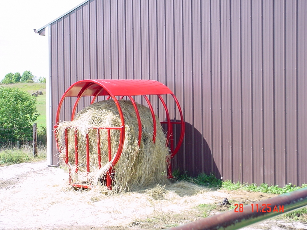

Here is a picture of my hay rack(made that too, about 8 years ago). Big enough to hold my 4X4 round bales, but my gelding has a tendency to waste hay, so now I just put in a little at a time, usually what ever they will clean up between feedings. Low enough to eat in the natural grazing position.
When the weather is nasty, it is fed off the ground in the stalls.
