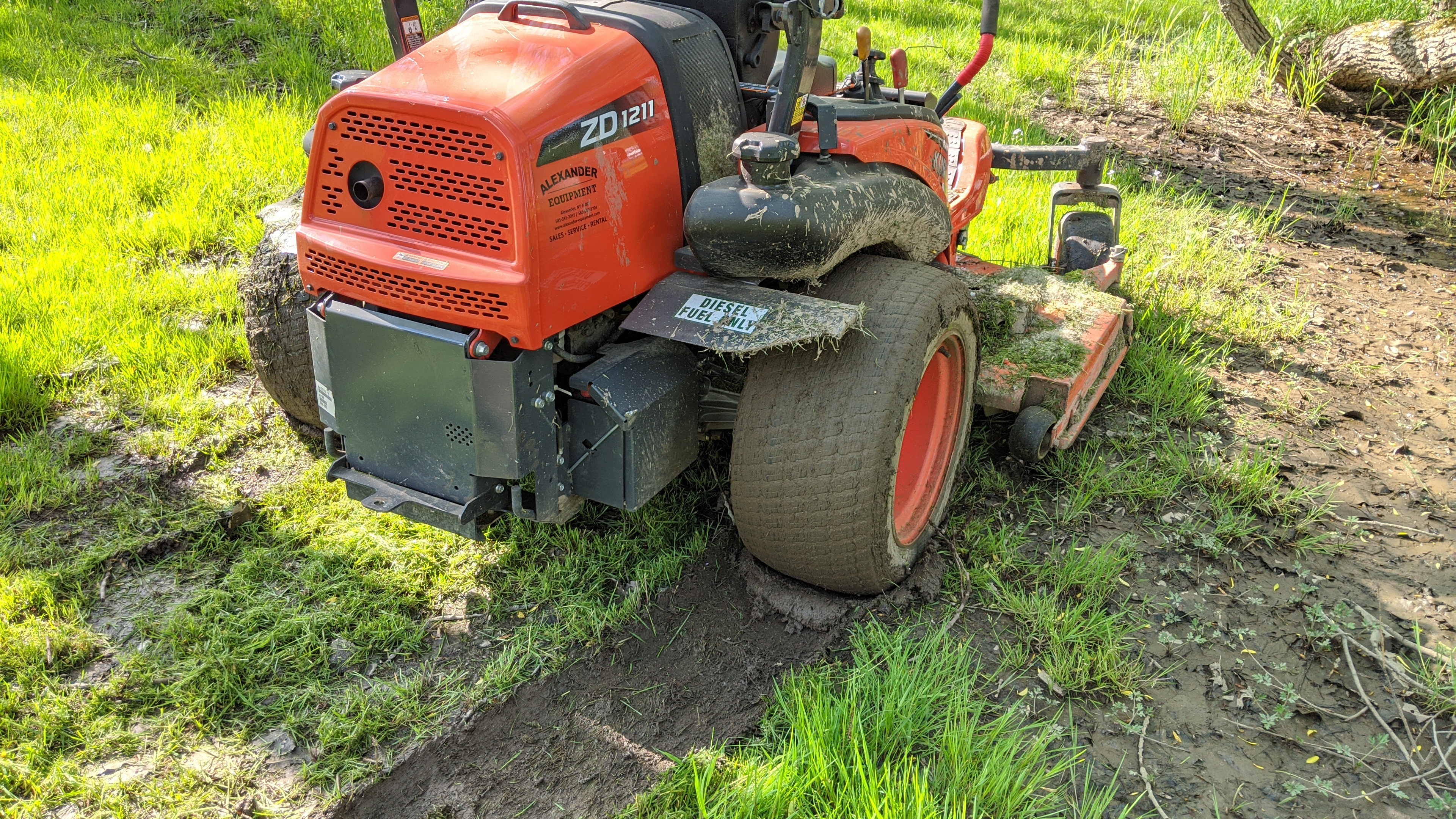

That grass is not tall enough to mow and you are out flogging around in the slop?
You do not need new tires, you need a hobby.

ZD1211R constantly getting stuck. Tires load up with mud and spin.
Anyone changed to a different tire? ...
No but I completely fluid filled mine & made a world of difference in mine.
   / My New Kubota ZD1211 Mower #253
They do get poor traction. How much weight is added with loading tires? Does it seem to strain the mower much ?!
   / My New Kubota ZD1211 Mower #254
It adds roughly 100lbs per tire.
It robs a little power only when your climbing Steep Banks.
I wouldn’t suggest this on a lesser Gas powered machine with hyd pump driven wheels.
The ZD diesel with a transmission handles it fine but I’m Super Easy changing directions & starting off from a dead stop.
   / My New Kubota ZD1211 Mower #255
I got rid of the crappy turf tires on my 60" Toro Titan HD 2000 and put bar tires on it. I now can mow through slightly damp grass without getting stuck or marking the ground.
In fact, I mark the ground less with bar tires than I did with the turf tires. Can't believe dealers aren't offering bar tires as an option when selling new.
