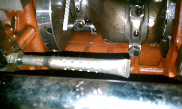

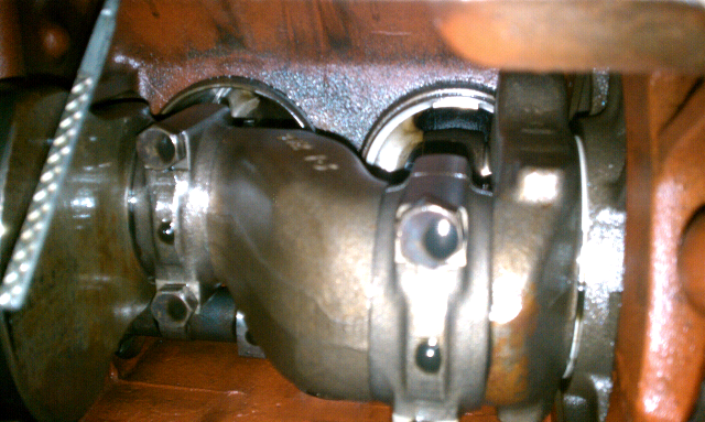

Ok purchased new head and took your advise replaced rings. Parts came in finally. So I am in the process of reassembling now.
Had to pull pan back off so got pictures of oil pick up tube for California. Its amazing how clean inside the block is for 30 yr old tractor, that I'm not sure how well maintained it was.
Cylinder walls looked good did a light hone on them. Should have head on back on and back together this weekend.

I'm amazed how clean that is.
The manual says to drop the pan and clean that tube periodically, but with today's oils it doesn't seem necessary.

Bowinelk, there is a post right before this one about oil level and easier cold weather cranking. If you haven't already put your pan back on I wonder if you would look at the oil level on the dipstick in relationship to the throw on the crankshaft when in the down position. I have always believed on most pressurized systems the crankshaft does not dip in the oil. I really can't tell from your pictures. Thanks.
   / My New/Old 240D
#25
Ok. I measured from the bottem of the crankcase to the full oil level on the dipstick it measured 3.25 inches. So the oil level is about 3.25 inches. The lowest point that the crank shaft reaches is about 3.75 inches. So your right the crank does not dip into the oil.
