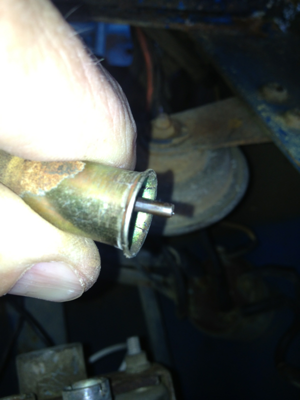

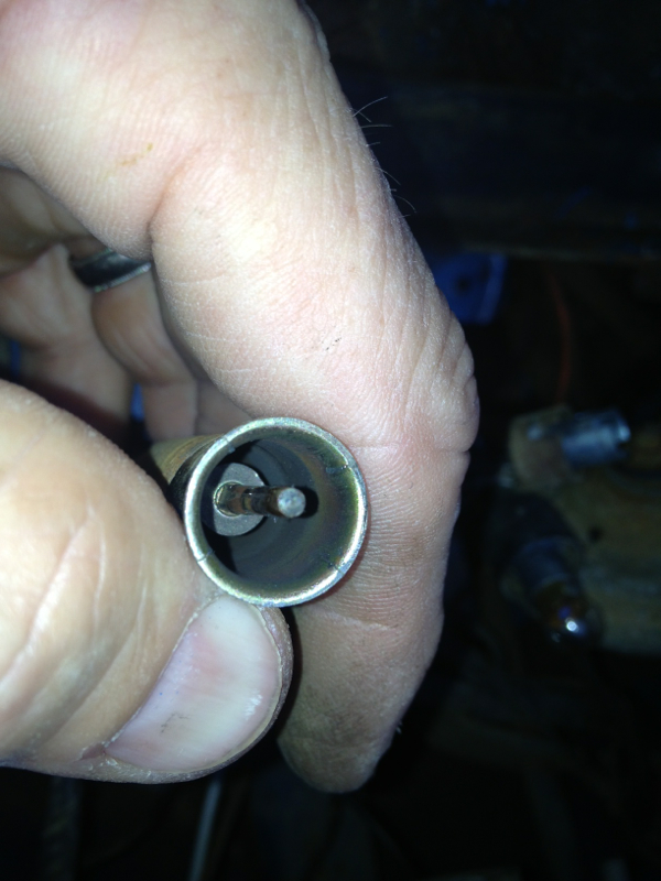

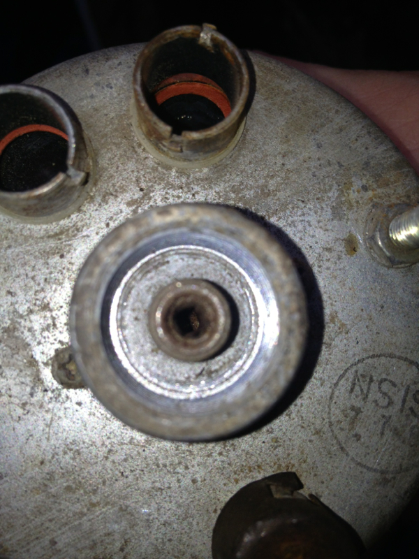

Another new question.........i bought a used proof meter to replace the dead one that came on the 1600. The tach needle wiggles alot but does not register engine speed. Attached are pics of the end of the cable and the back of the gauge. I am thinking the cable is supposed to be square and not round?

There are significant differences between the 1600 proof meter and your 1700 proof meter. the 1600 has a female thread to accept the cable, the 1700 a male thread (although you cannot see that from my pics).......and the shaft on the 1700 uses a kindof 'notch' to drive the proofmeter gears. I think if you look at the 1600 shaft pic I posted, you can see way down at teh base that it's square........so that's a bummer, it means I cannot use a 1700 cable on my 1600 proofmeter.

I have seen them with squared end like you have shown on your pic. I wondered if the cable was rounded off due to your meter internally being jammed. I'd suggest you find a square end screwdriver head, put it on a drill, insert it in a hole and gently turn the drill on. I put the drill clutch pretty low so it would not cause too much torque. I'd then verify if the meter responds.
Have you considered to put the end of the cable in a vise and squeeze it to a more square end? you can use a dremmel tool and a small stone to shape the end to look more squared to fit the square peg.

Member Listzeljko zoricic told me about ncwtractorparts.com, a place where he gets parts. I talked to Winn, very knowledgeable, and he has the right proof meter cable for the 1600. In case the cable is not correct, i will try and square off the end of my existing cable.
