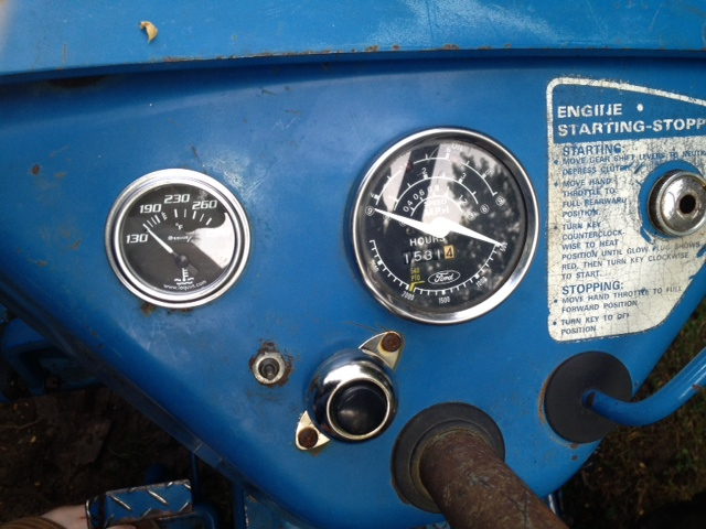

Got the new proofmeter, temp guage, and horn button installed, thought i would share a pic if a 1600 dash with al the stuff installed

Very nice :thumbsup: good job. What is the black button switch? is it horn?

Yep, its the horn. Its a generic button. Not seen a pic of the original horn button or the original light switch. Anyone got a pic of that?
