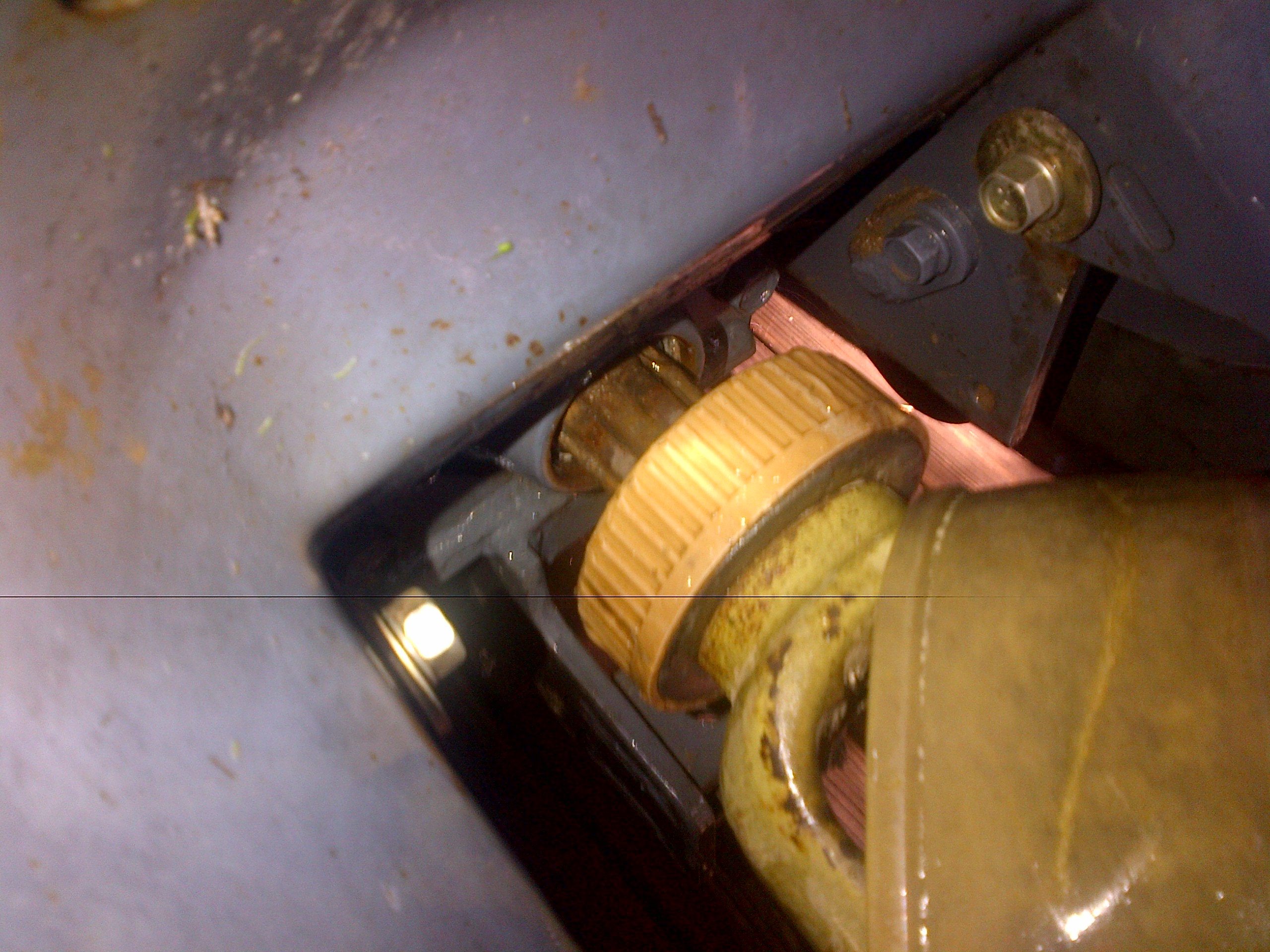

It is in really good shape. Not a ding on the thing. One owner and spent its time just cutting about 20 acres. Looks like the bush hog had never been taken off. Especially with the time I had getting the dam n PTO shaft off.
It has one of those "quick release" couplers that was locked up so tight you'd need a 20 lb maul to drive a toothpick up its arse...... Finally crawled under there and saw the snap ring. Pulled that and took the twist release apart to get to the push pin. It was so full of crap. Not sure that is the best design and not sure I am going to put it back on there. Will clean it all up really well and grease it and see if I like how it works. May just leave the good ol' push pin release there alone. We'll see.

Is the quick coupler for the pto part of the pto shaft?? The Pto shafts are relatively cheap to replace certainly cheaper then spending hours at a time to unhook your brush hog.

A squirt of Eureka FLUID FILM on the PTO splines, before you hook up a powered implement, will help a great deal getting the PTO shaft on and off.
There is nothing else that compares with Fluid Film for use on the PTO splines.
Eureka fluid film isn't that a rust proofing or under coating?? Is there any build up on the shaft that has to be removed after a dozen uses or is it a one time spray application? ?
Yes it is part of the "drive" shaft and that will be the solution if cleaning it does not help. It just has a bit of crud built up around the pin so cleaning it really good and a little grease should take of it. We'll see.

Oh, cleaned the quick release PTO really well today and greased it up. Put it all back together and it works like a champ. Just takes a light twist and the pin goes right in to release. I'll give it a shot for a while and see how I like it.
