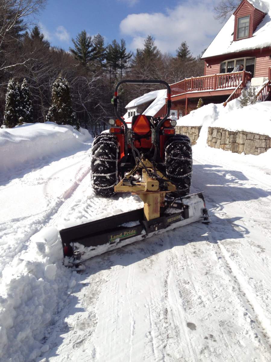

Nice! Looks like a lot of blade for a ct235 - do you think you'll get tossed around a lot on those R4s, or do you have chains?
Oh I see your rears are filled, that must help a lot.
I also have chains. Tractor weighs in at about 3600 lbs.
