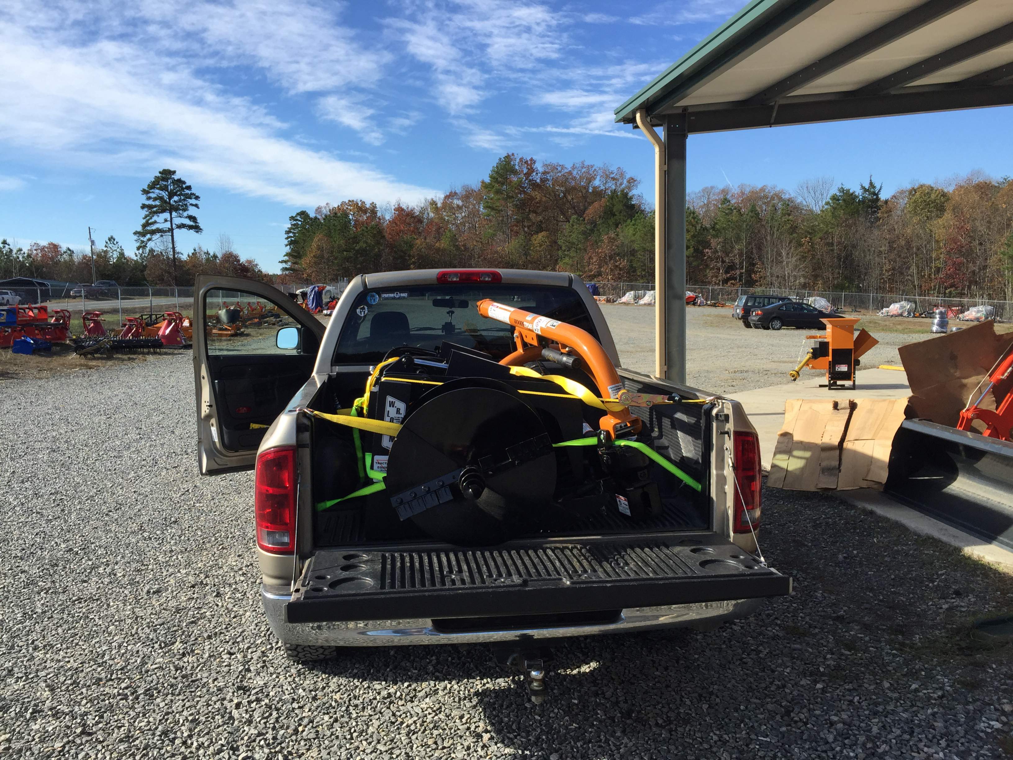

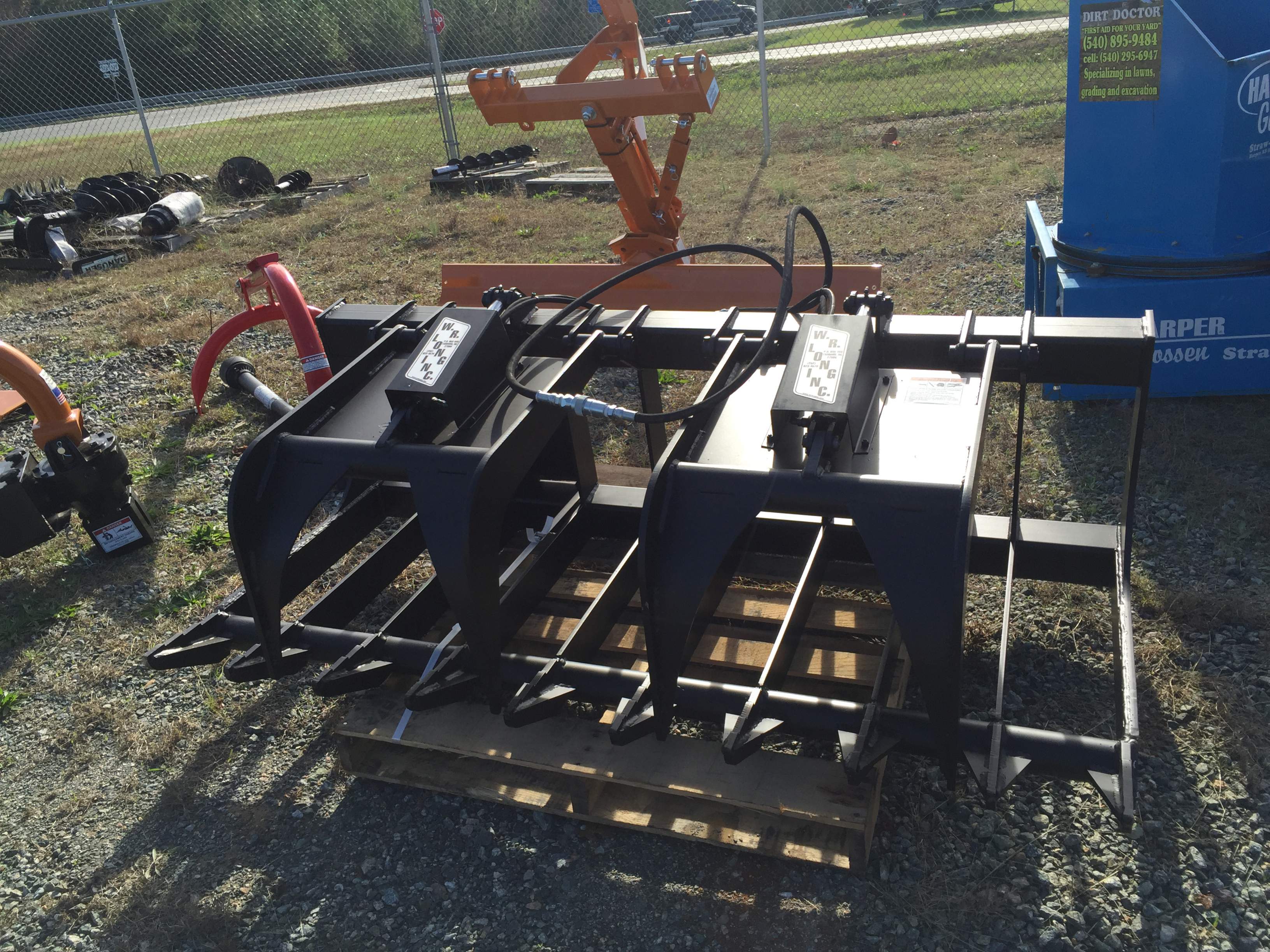

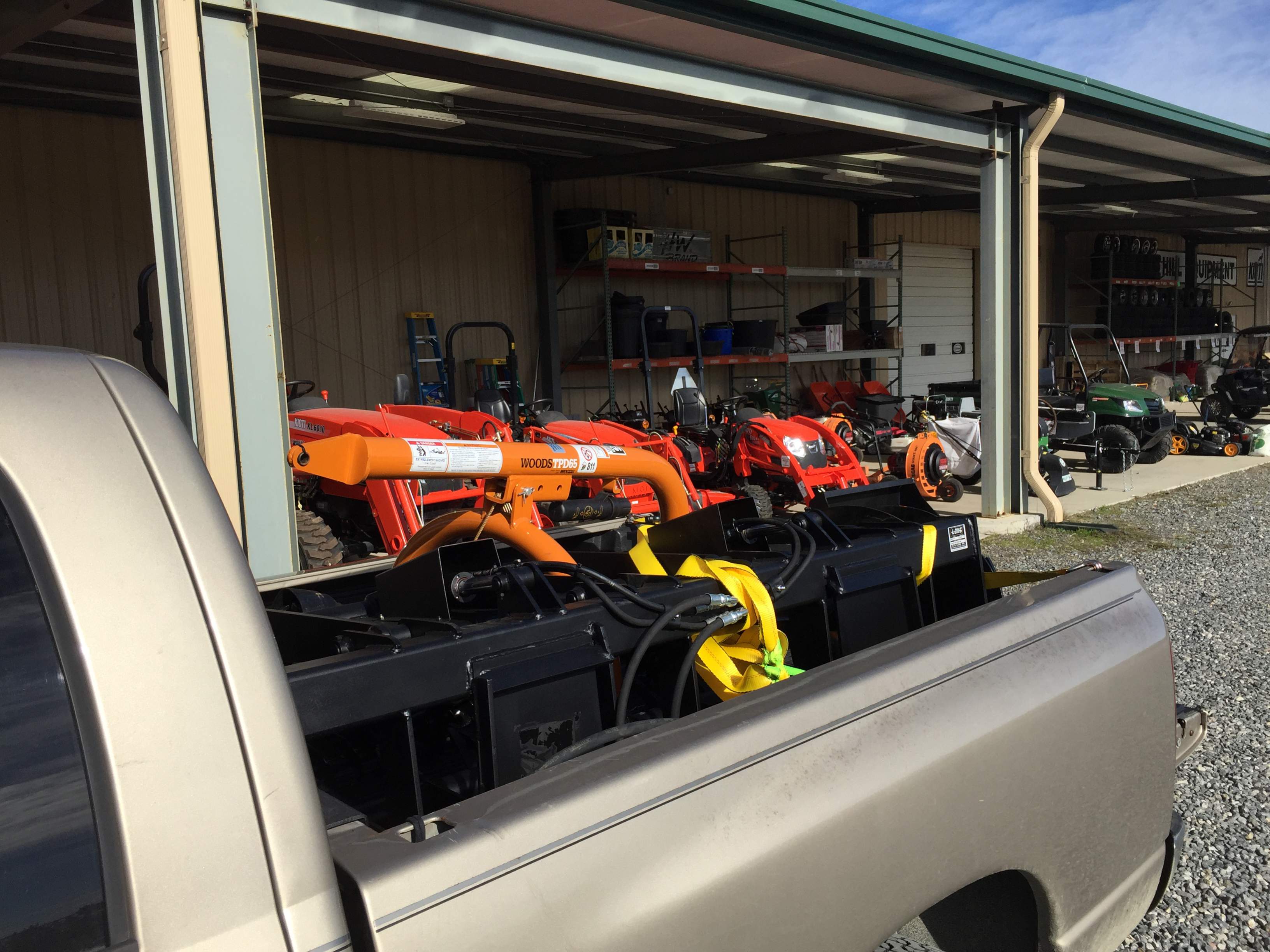

I bought 20 feet of 3/8 inch chain with a working load of 6600 lbs and 2 clevises on it. Made in Kentucky...got it at the tractor dealer for a better price than I could have gotten lesser import stuff at lowes. I don't know the grade. Will look tomorrow. The pickup was loaded down pretty hard. I Getting it out alone was fun. Can't wait to put the post hole digger to work to build a shed for the tractor.

Looks good, WoodChuckDad! Look for seven or 70 stamped on each link.
   / My NX6010 #1,017
It is schedule 70. And I have to correct my previous statement. It is made in China.
Could still be better than what's available at the home imrovement stores. :thumbsup: The importer's manufacturing requirements and QC are more important than country of origin. The Chinese can make stuff as good as most anyone.
