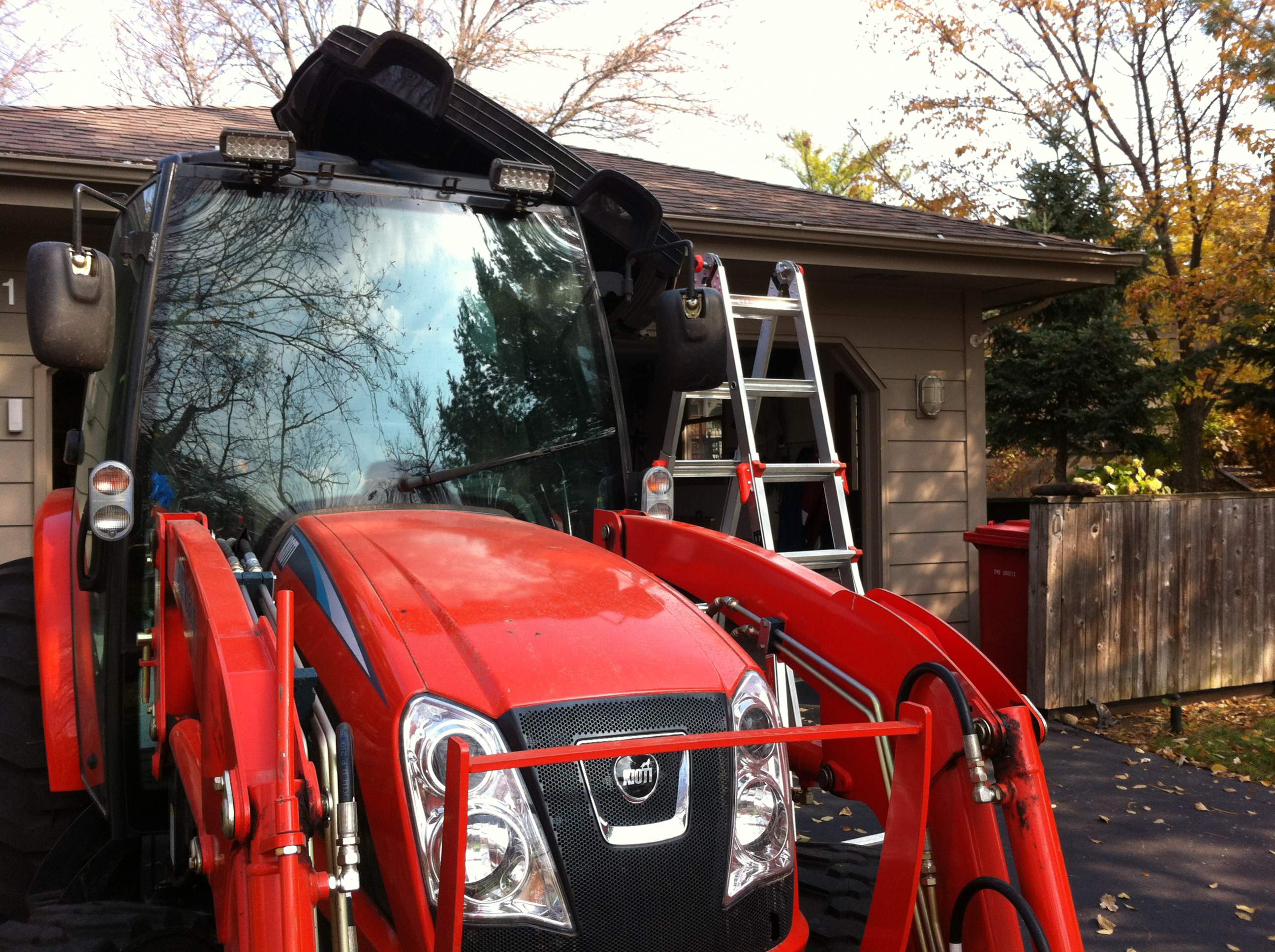

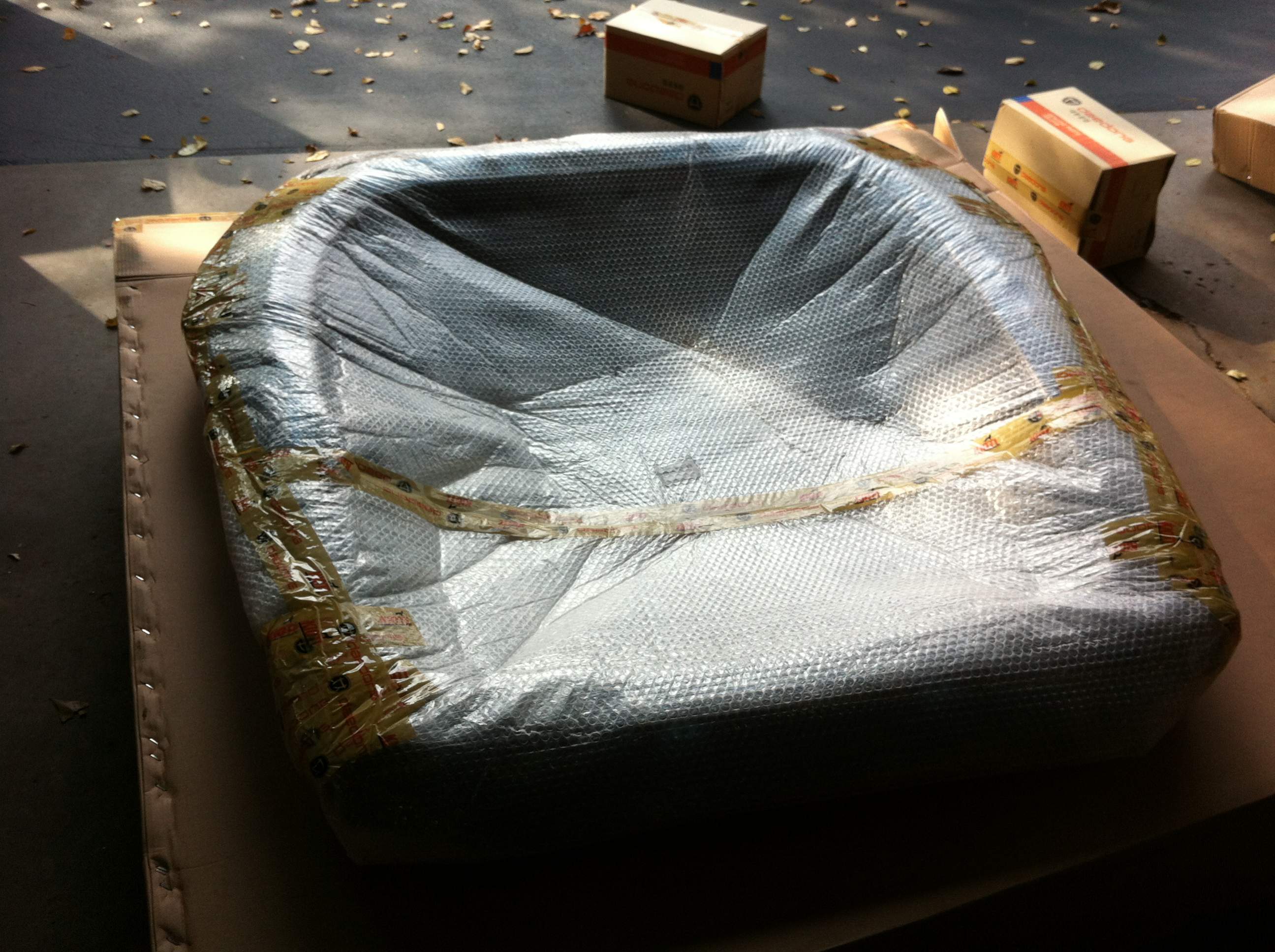

Since this thread has been idle way to long I thought I would ask a question. On the NX top, to remove it do you remove the bolts facing down around the cab perimiter? What about the bolts on top of the cab? ...anything else? does it just lift off then? Thanks
   / My NX6010
#1,022
Remove the six bolts on the underside to remove or loosen the top and pop the red, blend air nub off by slipping in a small adjustable wrench above and behind the red num and pulling straight down.
The bolts on the top of the cab top separate the cab top's inner lid from the cab top itself which is not needed to remove the cab top for access the HVAC system and roof wiring.
I never made a direct video but photos are buried somewhere in this thread in October of 2014.
Although not the subject of the video, the following video shows the underside of the cab top when it is removed.

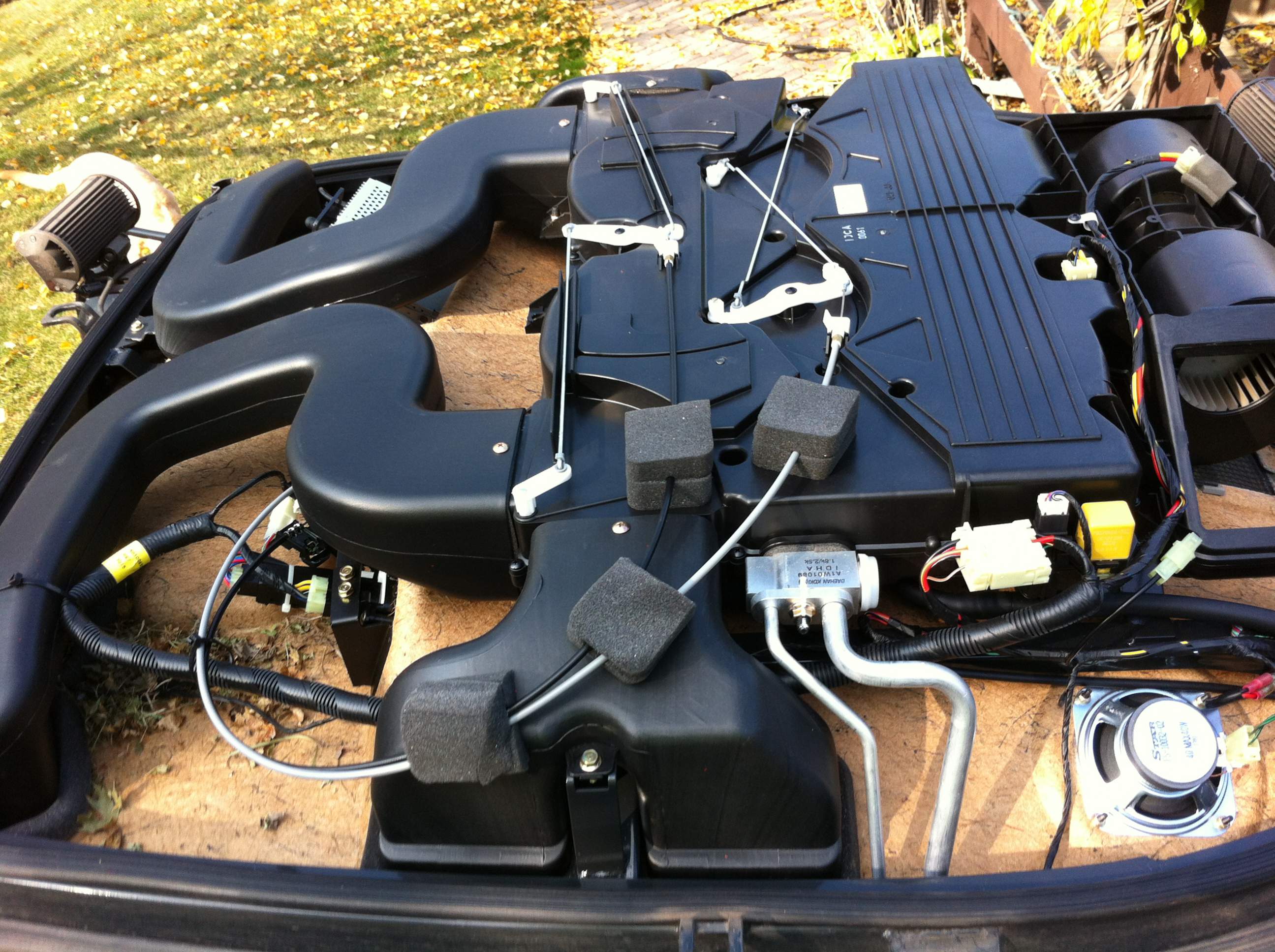

I think that was Threepoint who installed the Kenwood Speakers as I remember he had asked about removing the cab top. I still have the stock speakers that for me are fine.
Here is what you can expect to see when you pop the cab top loose or off.
