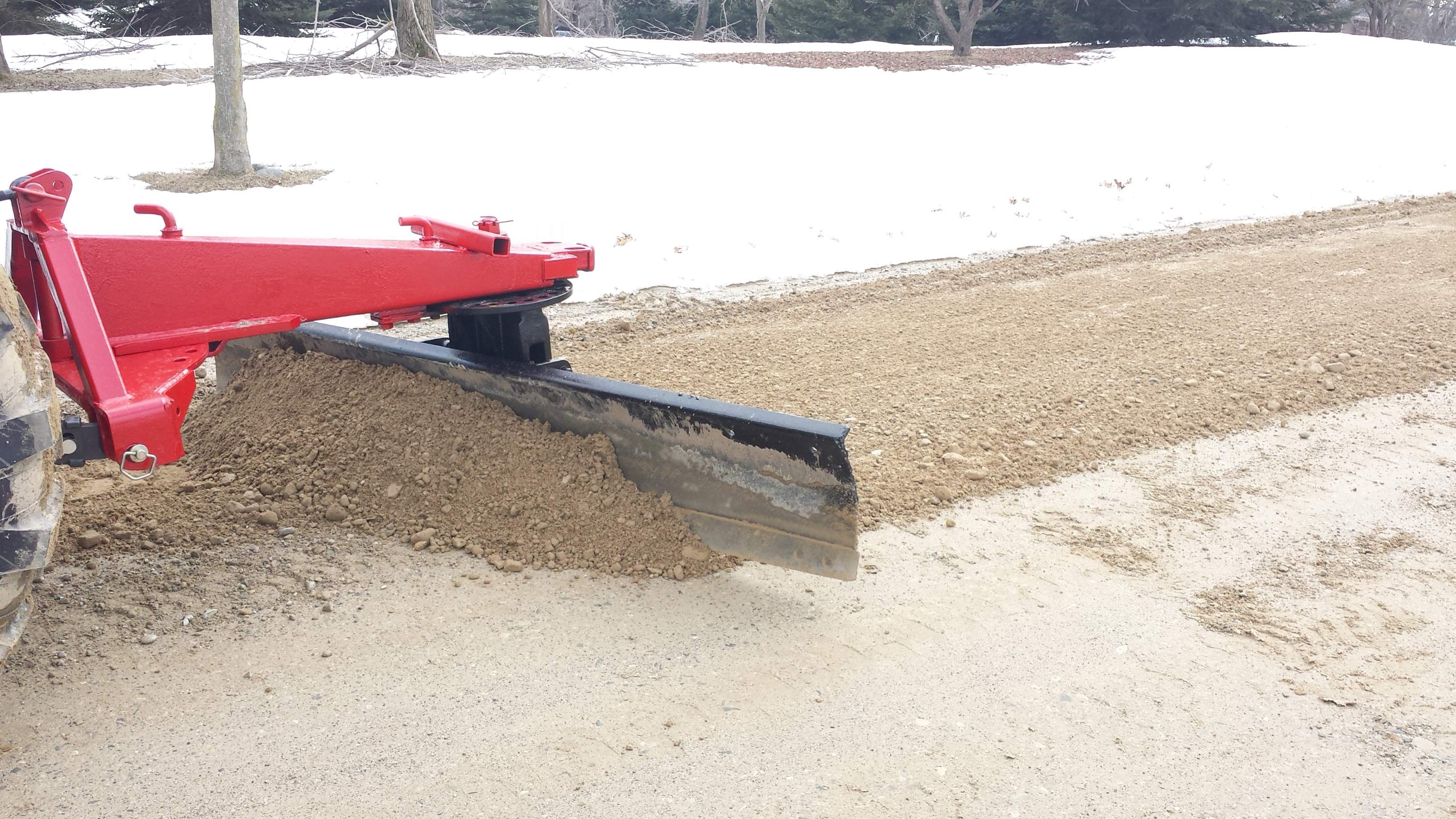

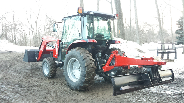

While my 8ft back blade (actually made by "The Servis Company" probably 30+ years ago, before they were bought by, or converted to, Rhino...) is practically indestructible, and made for a much heavier duty tractor than mine ... the box-blade is more more like "everyone else's box blades on the market". It's a good blade, and it has seen it's fair share of work this season, but I managed to break it in the spring on a grading job (bent the whole 3pt linkage assembly when I accidentally backed into something I shouldn't have!). Of course, I was able to remove the damaged pieces and re-weld everything and it's right-as-rain now, and it's been worked hard since, but I think during the winter I'll reinforce it some more.
I don't think you need to purchase a super-expensive box-blade. Find something decent on CL, and weld some scrap metal onto it for reinforcement. Back-Blades are harder to find (in the class that mine is anyhow). It's very heavy duty. I found it used for a great bargain (actually it was part of a trade) but to purchase THIS blade new (they sell a similar design configuration today) would cost somewhere around $2000-2500.

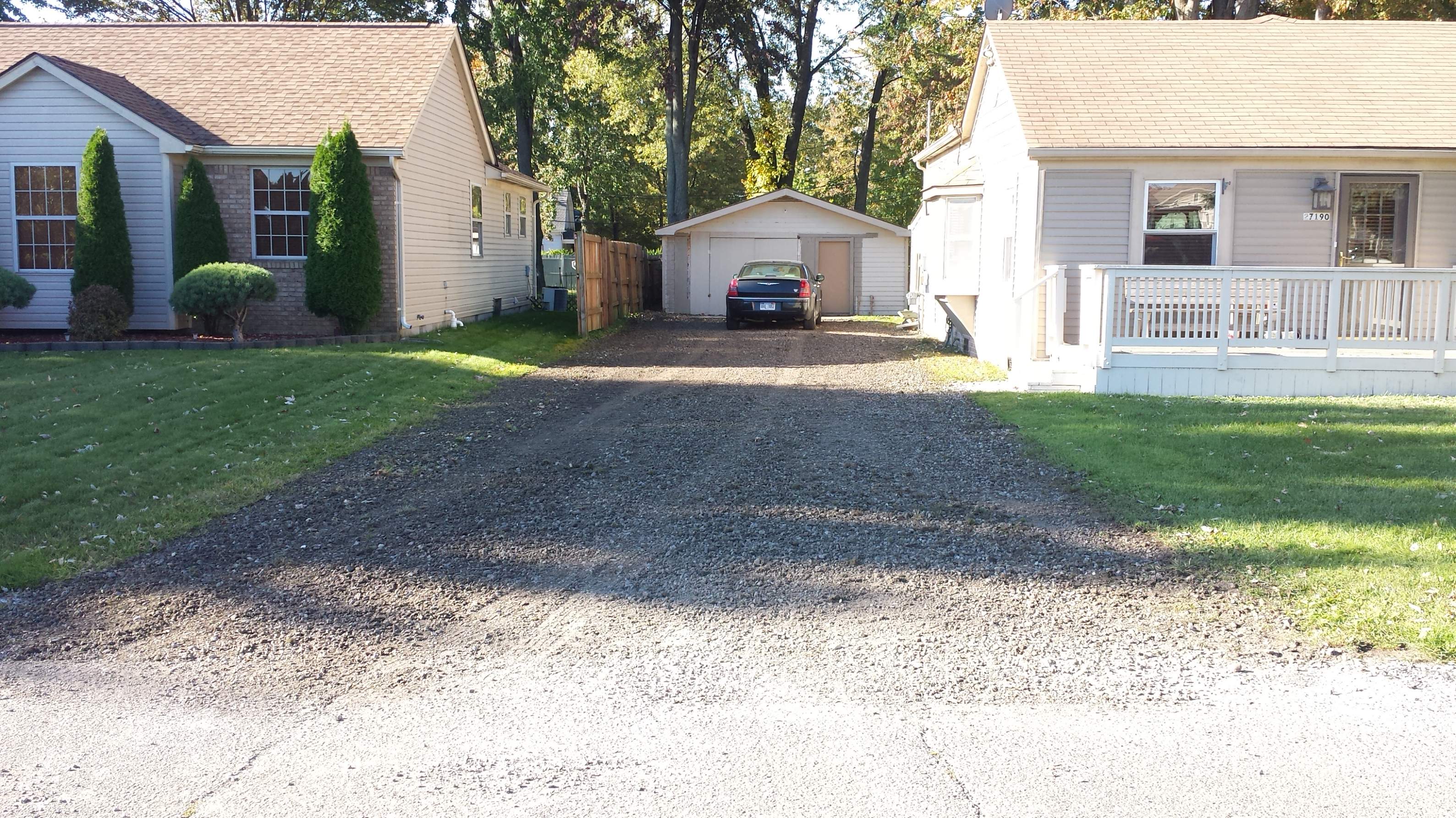

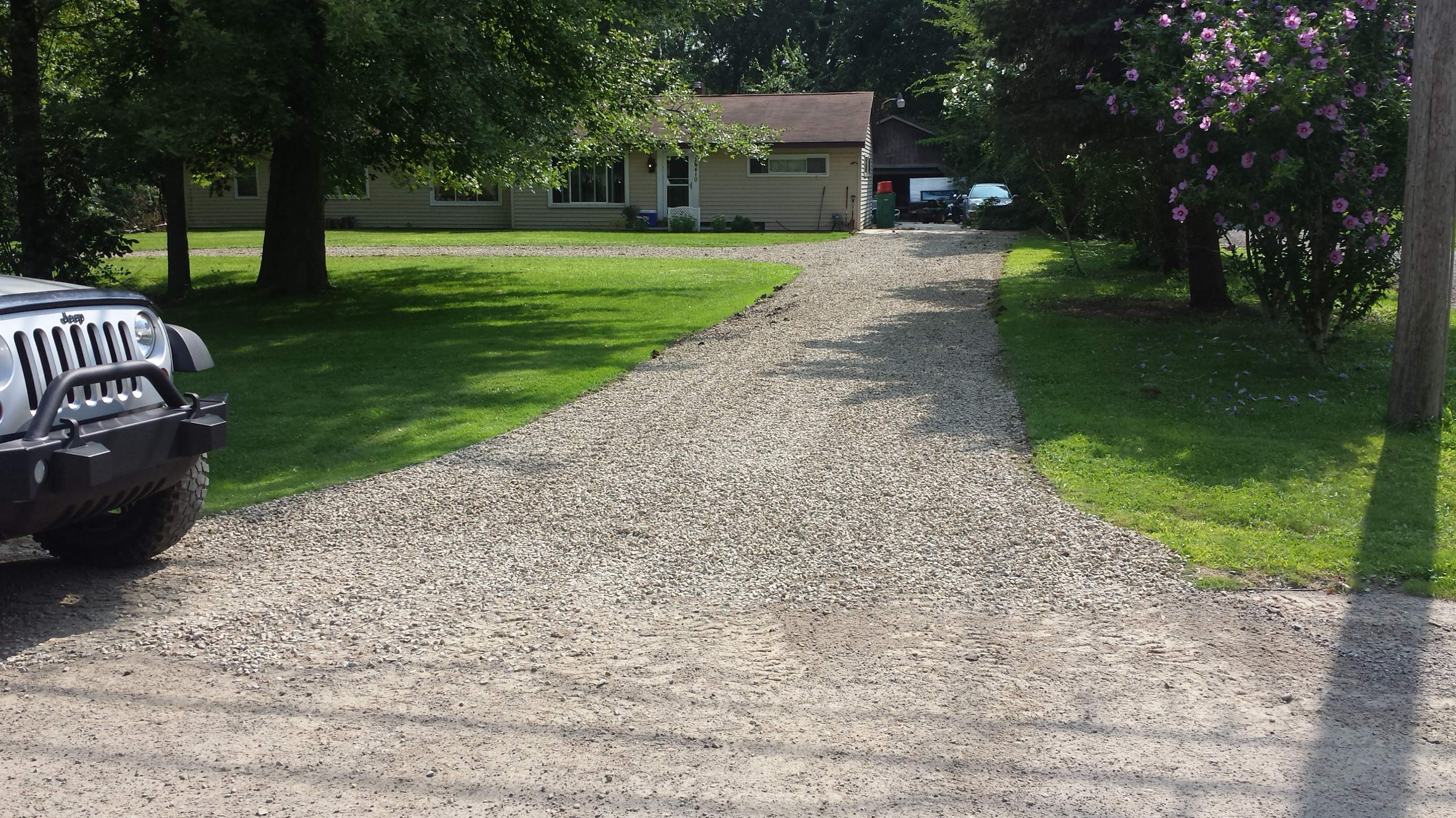

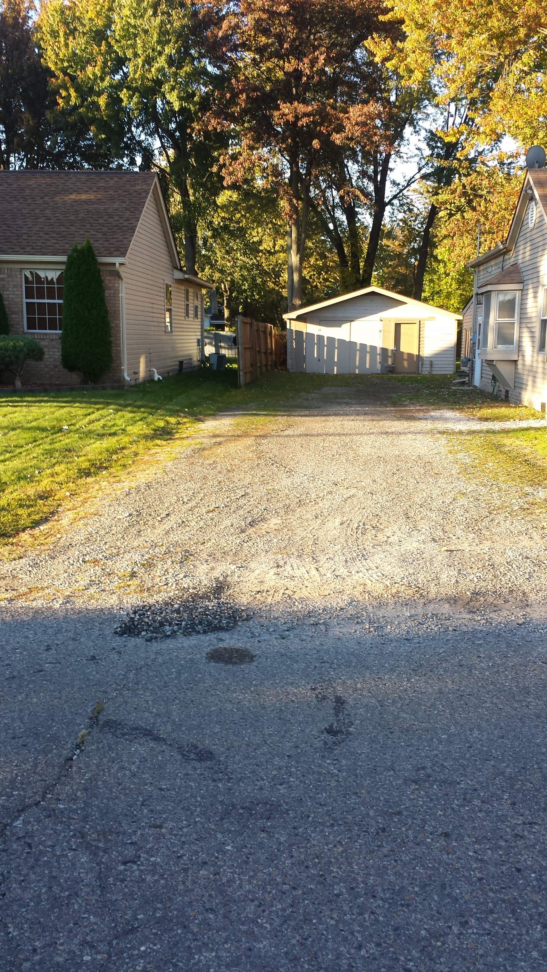

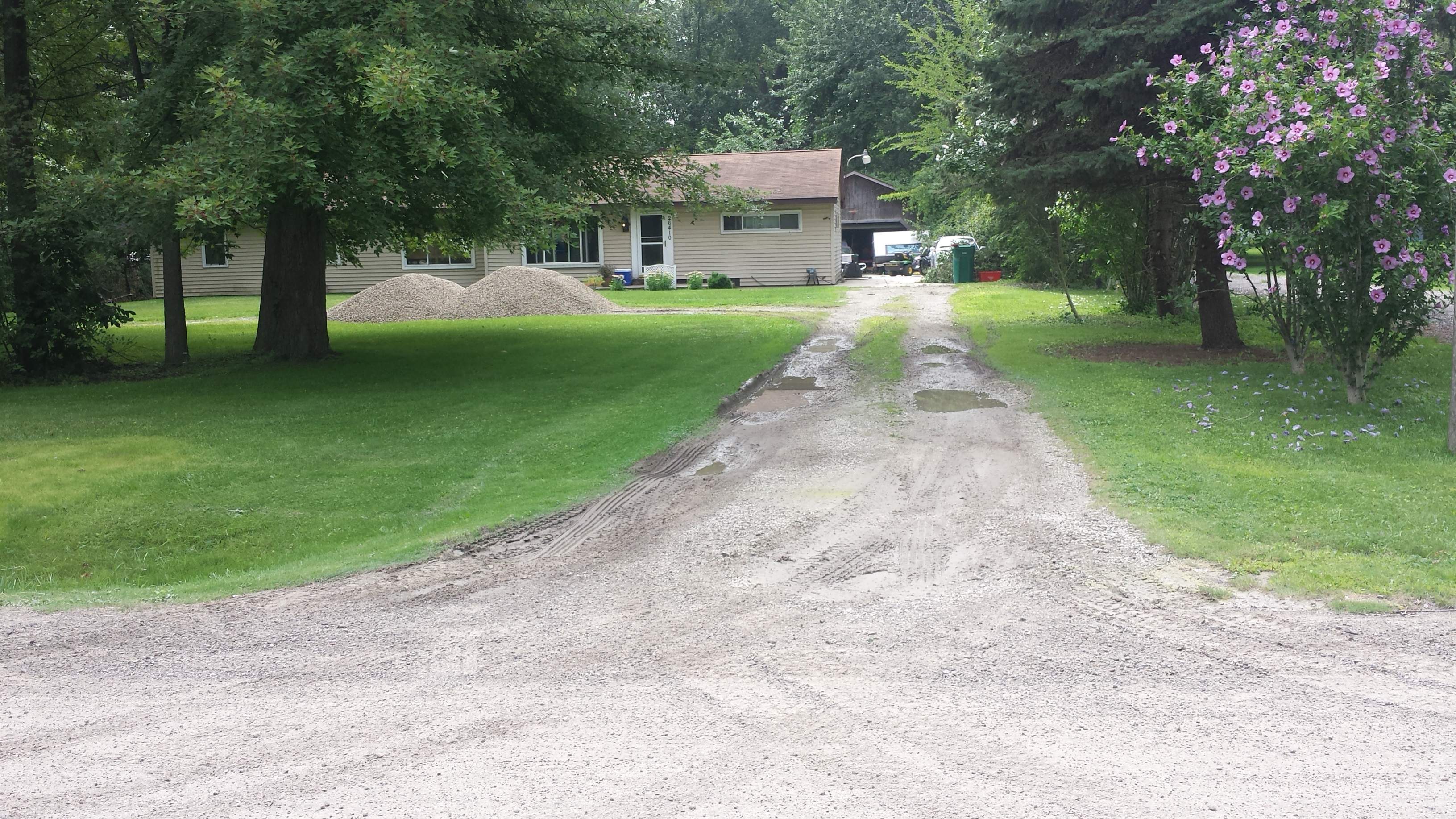

In my experience (I've constructed several new driveways, and have maintained-graded probably 30+ driveways this year alone), a good box-blade AND back-blade are both good tools to have. If I have severe pot-holes, I use the box-blade, and it also helps with moving bulk material. I use the back-blade on larger jobs (private roads, subs, etc) after they're already "churned up" with the box-blade, and I can get a really smooth, packed finish with it. It also works better when trying to "crown" a road.
My best advice, don't be afraid to add material! The more you have, the easier it is to work with. And, there's nothing wrong with going with crushed-concrete. It packs and "sticks" together well, finishes nicely, and is cheaper than the other aggregates.
Here are a couple small driveways I recently did using just a box-blade (and my bucket)...
(added about 20 yards to this one)
(was able to re-claim and churn-up all this material)
(this is the back-blade)
