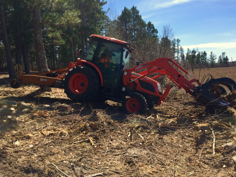

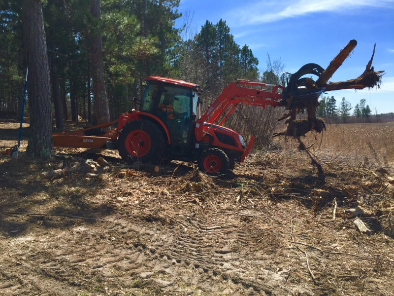

   / My NX6010 #783
Quite heavy CUT(or mega CUT), Cab, Loaded rears, big heavy woods cutter as counterweight pushed rearward even more with a QH. Man, you're testing it! Travis
You ever see the size of the front axle on a Kioti? Those puppies are not designed to mow lawns. Besides, he only has one rear tire in the air. My CK 20 could get both loaded rears and bush hog off the ground when pulling stumps. My DK40 just gets one tire up with a BrushBull on the back, same as the NX.
Still, it would be easier to do that work with a BH and ripper. MIE could set it up for a modest pile of Franklins.

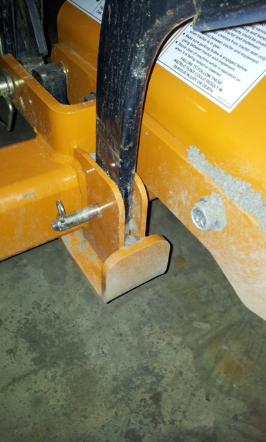

After some fiddling drilling a new mount hole in the lower clevis and replacing one of the hoses that had a bad factory crimp, I finally got everything working!

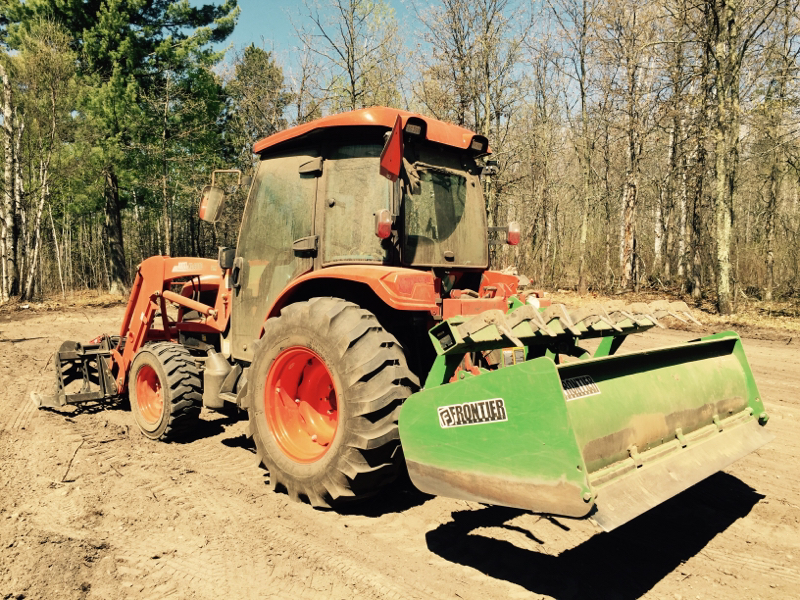

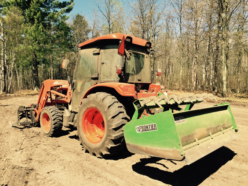

A weird, new issue has cropped up: last year a tree took out one of my rear factory quick disconnects. Since Kioti doesn't offer the QD as a part, I slapped on some German version (because it is a German metric thread, as I recall). Anyway, this replacement German valve is popping off the box scraper's double acting ram on the compression hose. Unaware it popped off (since i wasn't using the scarifiers), I wrecked the hose, and so I have not had a change to swap things around. While in town I will get a new hose and chase down to the Parker store to see if they can get me a different QD.
Damage report: apart from the stuff in happening in my Frontier commercial box scraper video (that I'm uploading as we speak), a twig, or maybe a sapling, somehow tore up one half of the Woods BB720X driveshaft guard, and Woods doesn't seem to offer a replacement that I'm aware of. While I'm all for allowing toys that can kill or maim so that the stupid babies either get hurt and wise up, or culled out so they cannot grow old enough to accidentally kill us all, I like that the safety shield doubles as a great dust cover. Anybody know were to go to get Woods PTO shaft bits?
In other news, I've been informed that my double door, high cube container is finally on a train getting closer to me as we speak. I've been prepping the road into the new parcel as prep for receiving the container, but our local commercial enforcement state trooper started poking around wondering how all the class 1 got on my driveway while the road restrictions are still on. So we're shut down until the restrictions lift and I'm back home. Just as well as my 88-year-old mum has health issues that need to be prioritized as my high nail anyway.
At any-rate, here is a video review of the Frontier BB4284H commercial box scraper.

I had to do some fitting of the 3" tilting cylinder that I got from MIE. By eyeball (and that's all you can do), it looked like the lower clevis hole was the same length at the longest (or bottom) clevis hole on the fixed link (18.5"), but when mounted, the three point sagged on the right side even when the ram was fully retracted. As a result, I drilled a new hole at an eyeballed 17" and used the fixed link's middle hole which measures 17.5" center to center. With this change, my three point was level when fully collapsed. My thinking is that hydraulic side links may all require a little fitting. Buy a 3/4" drill bit.
I also had a bad crimp on one of the included hoses.
