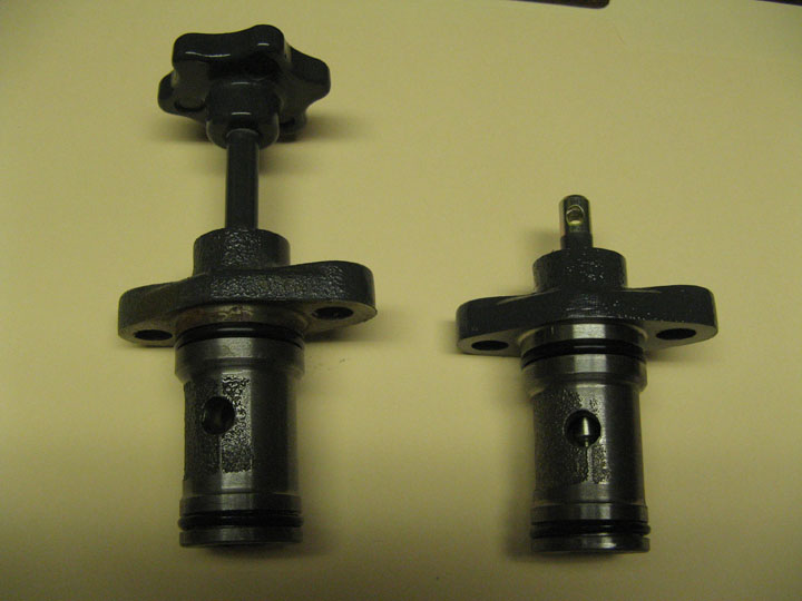

I checked our online service center, the last change to the 3pt looks like it was to an anti-fall valve.

Thanks for looking into this. I'm not sure what an anti-fall valve is? I can't speak from personal experience but from the few, and I admit few, complaints coming in, it sounds like the L3400 took a step back. I know they upgraded the position control valve to a new model number. I haven't seen the parts breakdown for it so I don't know if it's really a new valve.

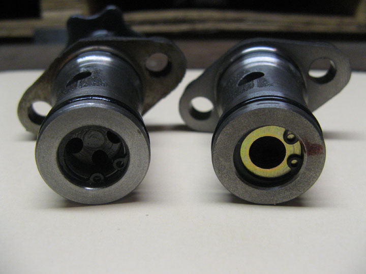

I love the input from you guys and ht1, wow, why didn't I think to try that. Because of this discusson, I've reevaluated the LSV components and I think they may support the new flow rate theory.
I still think the fluid goes through this thing like an adjustable check. The LSV with the spring has a washer that I thought retains the spring. Now I'm not so sure. The washer limits the flow by obstruction, reducing the opening to approximately half what it is without. I'm starting to consider that the spring retains the washer and the washer is the key component.
The L3000, a much older model had an LSV VERY similar to the L3400. I think to improve it for better performance in later Grand L's they may have added the washer. Since it was a simple retro fit, they had to throw a spring in to hold the washer in place. When they decided to create the "Economy L's" for what ever debatable reason, they removed the flow restricting washer and the spring.
I'm now thinking that this LSV slows the flow. More importantly, even if it doesn't, installing a washer with an even smaller hole may create the desired flow reduction rate, right at cylinder.

This is just a theory...but I was thinking that a quick fix could be as simple as replacing the input pipe (steel) with a rubber hose. This could absorb some of the hydraulic hammering that we are experiencing. Again...just a theory, haven't decided if a smaller or larger diameter rubber hose would help.
