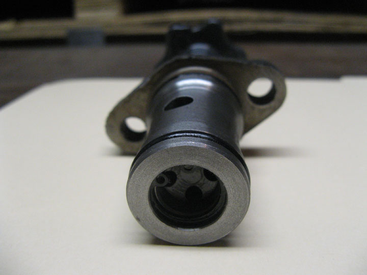

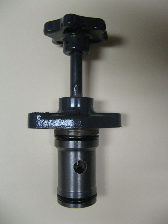

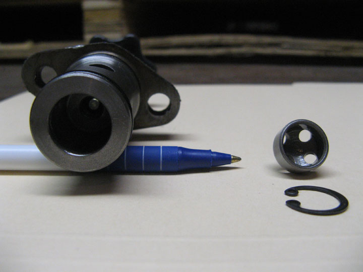

I pulled the original valve today. Except for care to avoid a spill and some concern about the amount persuasion needed to pull it out, it's really a 5 minute job. Didn't loose any fluid except what dripped off the valve. 12 mm wrench, a few paper towels and 1"x1"x12" oak lever is all it took.
I took apart the business end of the valve and it's definitely a check valve with a limiting adjustment to allow the hitch to fall at a selected speed. If we could reverse its function we could slow the rise with the knob. Ultimately this valve could be modified to have a smaller port and a slower rise. But that is beyond my determination and would require a good machinist.
My optimism took a hit when I saw that the port the fluid passes through is already fairly small and the theory on the washer slowing the flow is nearly useless. It would be easy to put a blank in to replace the washer with a predetermined hole size but I fear the spring clip could fail under the pressure and let the components burst into the cylinder. Not a risk I can afford.
Thanks to a post by jfay regarding the resistance of the relief spring being somewhat compressible I still hold hope for the original spring theory but again, how stiff could it be, being held in by a spring clip. The port in the valve is solid cast metal and looks like it was designed to handle 3000 psi. The spring clip doesn't look like it could handle 50 psi of force against it. My latest hope is that the spring keeps the check from slapping and flopping around in there more than anything else and results in smoother function by default.
I doubt anyone will ever convince me that there isn't a reason the valve on the more expensive and better performing tractor has a spring but today I can't really see how it will help us with the L3400 and L2800.
I'm almost reduced to my original observation that several other Kubota models that have this valve have better performance with the same PCV as the L3400.
Here are some photos of the valve and one of it's home.
I'm expecting the new valve soon, between Monday and Wednesday. It should not take more than 5 minutes to install, although if it goes back in as tight as it came out it might be a little disturbing.

The thing with the 4 holes in it in the third picture is called the adjusting collar.
What you can't see is that the other side of it has a cone shaped top to it. This cone acts like a floating needle valve, when the flow is reversed to lower the hitch this cone tries to block the port in the valve. The external knob adjusts a pin that restrains the cone on the adjusting collar from fully seating unless the valve is set to the lock position.
