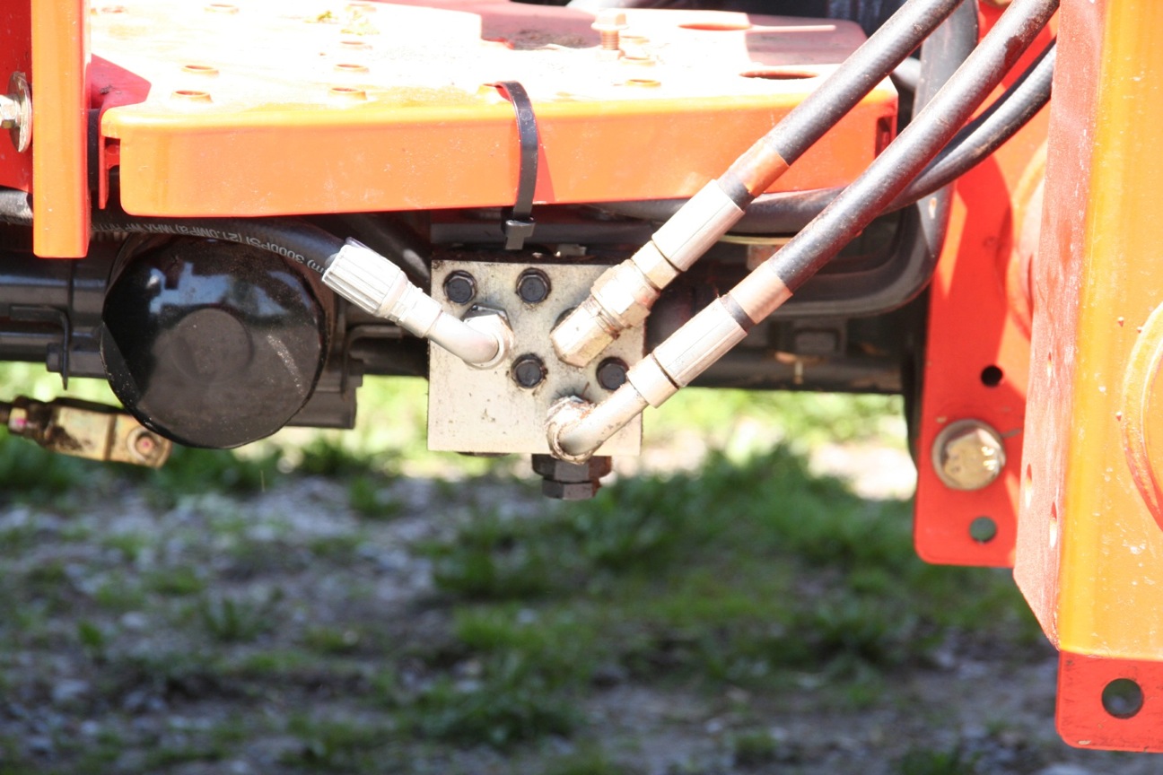

Here's a photograph of my hydraulic block. The port furthest to the left (towards the rear of the tractor) is where the pressurized fluid from the loader (or rear remote in my case) PB port goes in to feed the 3 PT valve.
The 3PT valve is the last valve in the circuit.
In my picture, you see a hose that hooks up to this to go towards the rear of the tractor. This is because I have rear remotes. If you don't then the hose from here goes to the loader instead. In my case the loader is the first valve in the circuit, then my rear remotes then the 3PT valve.
The port that is furthest down on the right hand side is the return to tank from the loader. Depressurized fluid that has been used up by the loader valve is returned to the tank here.
So the theory is:
- What we need is a flow control valve in between the loader (or rear remotes in my case) PB port and the PB inlet on the hyd. block that I have pointed out.
- The tank port that I pointed to (furthest down on the rhs) can be teed to so that it used fluid from the loader and excess fluid from the flow control valve can be returned to the tank. This is is the only line that can be teed.
Easiest way I think to do this:
- There is a nice area just under the loader valve where a flow control valve can be attached. The loader valve is bolted on to a plate that is welded onto the loader frame. The plate that the loader valve is bolted onto serves as a good spot IMHO for those that don't have rear remotes, to mount the flow control valve on.
- Simply follow the hose from the PB port of the hydraulic block (furthest to the left), to where it connects to the loader valve. This is the PB port of the loader valve.
- Disconnect this hose from the loader valve and connect it to the OUT of the flow control valve.
- Then connect a new (small - 1 to 2 ft should be plenty) hose from the PB port of the loader - where you unhooked the original hose, to the IN port of the flow control valve.
- Then connect a new hose from the EXCESS OUT port of the flow control valve and route it to the hydraulic block.
- Tee the TANK port of the hydraulic block, reconnect the hose that was already there (from the loader) back to it, and then connect the hose from the EXCESS OUT port from the flow control valve to the other opening of the tee.
- Open the flow control valve all the way, fire up the tractor, and adjust the flow control valve until the 3PT jerkyness goes away.
I would estimate that the total for parts - flow control valve, shipping, one extra hydraulic hose, fittings would probably be ~$125. Maybe a couple bucks for hardware to mount the valve to the loader's bracket and a can of Kubota orange paint to paint the flow control valve - say another $10 to 15 bucks, so that it looks like it belongs there :). Total probably $150.
Not sure when I will try this out as I'm not suffering nearly as much as you guys with the new jerky 3 PT valve. I'd like mine to be smoother just so I can feel warm and fuzzy on the inside. This setup REALLY needs to be tried by someone with one of the newer jerky 3 PT valves. I predict that the difference to my setup since I have the improved 1/4 inch at a time valve will be more suttle.
Bear in mind that I have written the above note with a user who does not have a rear remote setup primarily in mind. The EXACT same thing could be done if you have rear remotes and your rear remotes will also get the reduced flow - in addition to the 3PT valve. Now this is not an issue for someone line me who uses rear remotes for a top n tilt + snow blower chute. However if you have a log splitter or something that is hyd driven and needs the additional flow, it might be best to modify the above so that the flow control valve is installed between the PB port of the rear remotes and the hyd. block, instead of the PB port of the loader and the hyd block.

But, is it still just a guess that changing the flow rate to the PCV will solve the problem?? And if it is a fixed rate pump, does it mean anything that the PCV seems to function the same at different RPMs like teg pointed out?
I'm guessing the proof is in ht1's post, has anyone else tried this:
I prefer to call it a "theory" rather than a guess :) I have some confidence that this will work given that restricting the flow by installing 1/4" hoses on my TnT setup works to give me feathering control on them. But you are quite right - this is still a theory and I am certainly not 100% confident. This really does need to be tried by someone with one of the really jerky setups to see the before / after performance.
