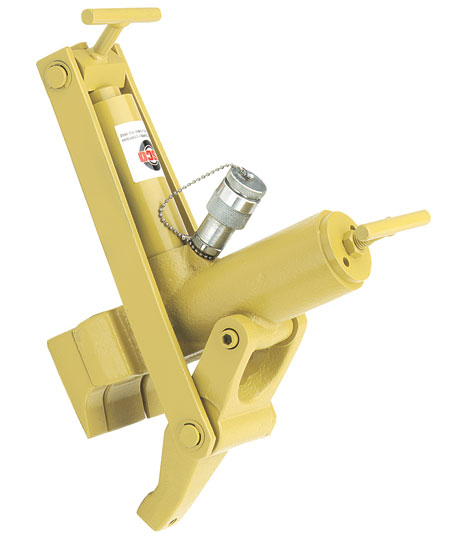

I have one of these, can anyone verify whether it is pneumatic or hydraulic. I changed the input fitting to a hydraulic fitting that would work with a hydraulic jack, but after looking at the picture I am not sure. In the above page of bead breakers, I believe that the yellow foot control box is an air powered hyd pump. On the same page, they show one with what looks like an air fitting. The blue one. The way I thought it worked was that you placed it on the wheel bead, and applied air or hydraulic pressure, and the breaker would clamp to the bead rim, and push out another cylinder to push the tire off the bead. Any body use one of these breakers before, and if so, please provide operation details of the unit.

We used to have a bead breaker like the blue unit pictured , it was hooked up to a air over hydraulic pump which had a foot pedal to extend and retract the cylinder . Worked very good on rusty split rim wheels .

You are right on some repairs, but did you read about some of the charges that the tire repair people charge. I bought mine at a flea market, and the person probably did not know what it was. I believe I gave about $10 for it. I still don't know how to use it. One of the handles is for holding the bead breaker, the other handle is threaded. I hooked it up to a hyd pump, and the clamping cylinder works.
