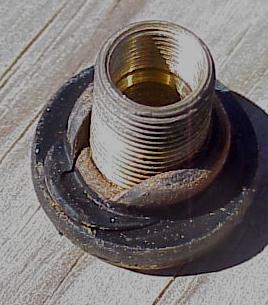

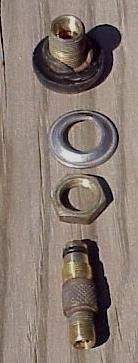

   / My Rear Tire Is Leaking Air? #14
Improper installation of that type stem causes stem leaks.
