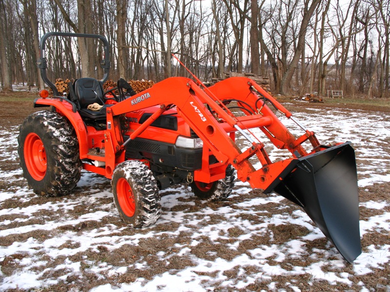

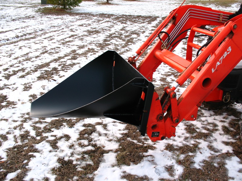

I need a little help here...should I go with the more pointed tip like the black one in the photo or should I go with the more rounded looking tip like the yellow or red ones? Any thoughts or opinions on this?
The black one is commercially designed so it must(?) be de-bugged but the other ones look like they would work better especially in popping trees out of the groumd.
I took some sketches to the welding shop today and am taking my tractor front loader bracket tomorrow for him to get started. Sure, I could weld this myself but it's 1/2" plate and still winter, here. This is cheap money spent.
I'll post pictures along the way but am having the shovel welded on to a plate and then either having QT loader brackets welded to that plate OR U-bolting the plate to a bracket I have that fits my loader QT brackets.
For now, any thoughts or opinion on the shape of the tip of the shovel itself? More pointed or more rounded on the tip portion ?
Thank you.
The Kubota with the black bucket is my machine. I recommend the slightly flattened tip. This allows the bucket to cut the roots. A sharp tip bucket tends to push the roots to one side or another and not cut. That's my opinion.
Thanks.
I did decide to go with the flattened tip and a welding shop is working on it now.
