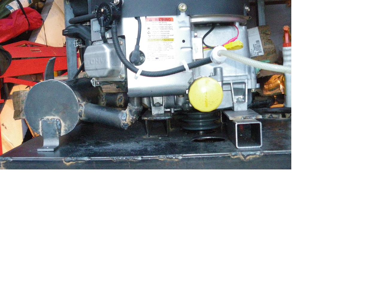

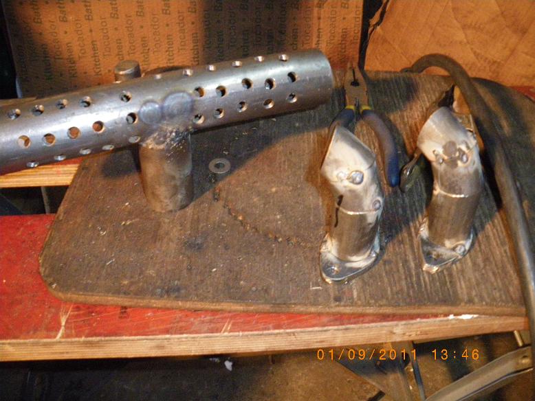

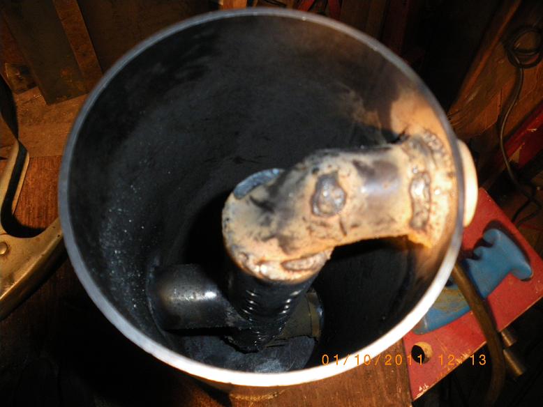

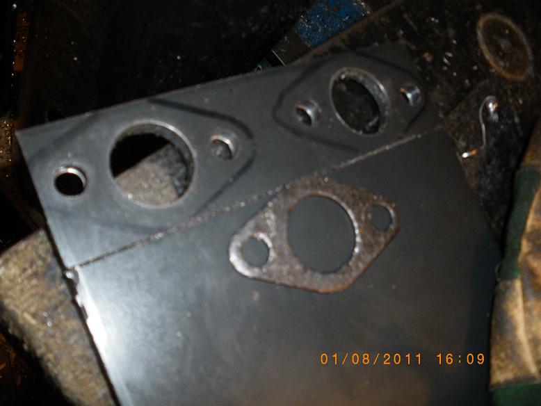

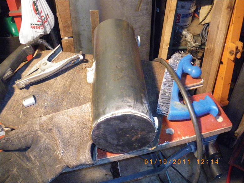

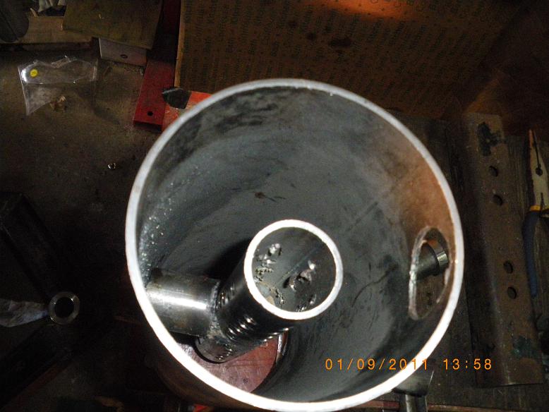

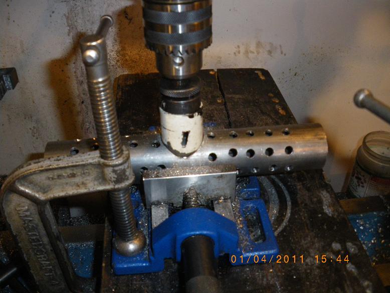

Been working away on the Dumper, taking cold medicine at night and working out in the -5C weather by day. :confused2:
At minimum wage this is my $250 dollar exhaust, but I rather think of prison wages so maybe its a $15 exhaust. I was really hoping to start the motor today and see how the muffler sounds but I ran out of daylight. Even though there is only 4 wires, that are supposed to connect to a key switch, I was unsure how to rig things for a test. Guess I have to do some Googling.

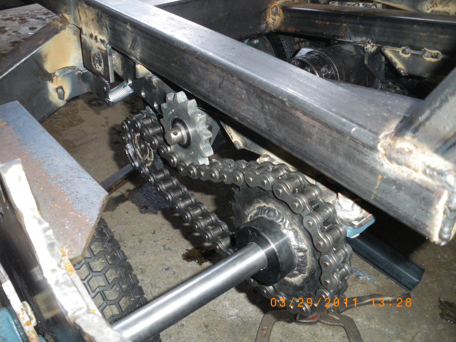

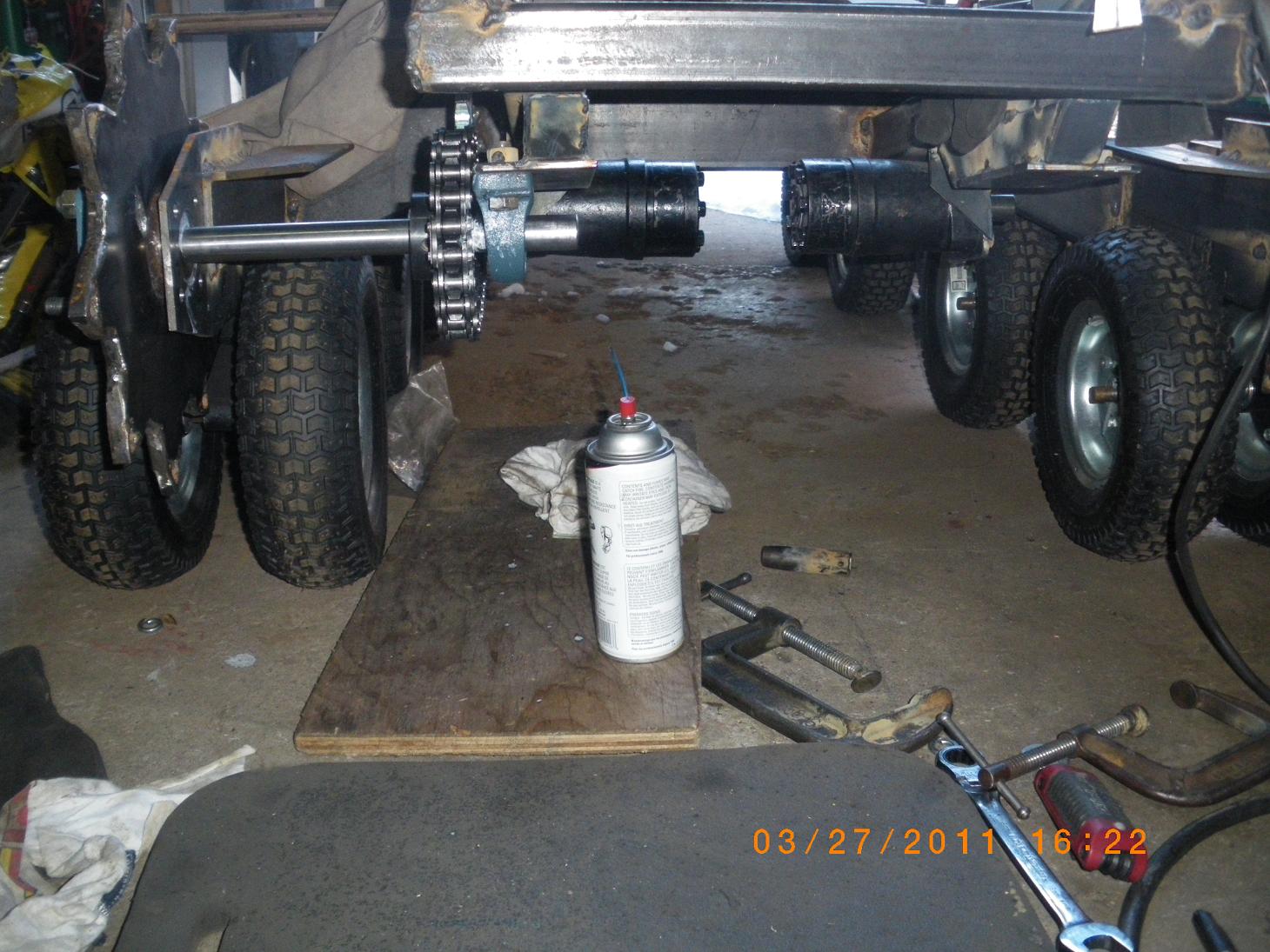

Started working on the machine again. I have been studying 2/5 scale or paintball tanks to come up with ideas. I decided against direct driving my tracks and have added 2:1 gear set using 60H chain. I have started the roof, but will have make it removeable because it will be too tall to get out the 7 ft garage door. I have completed the 4 way front blade. I'll work on some pictures next week.

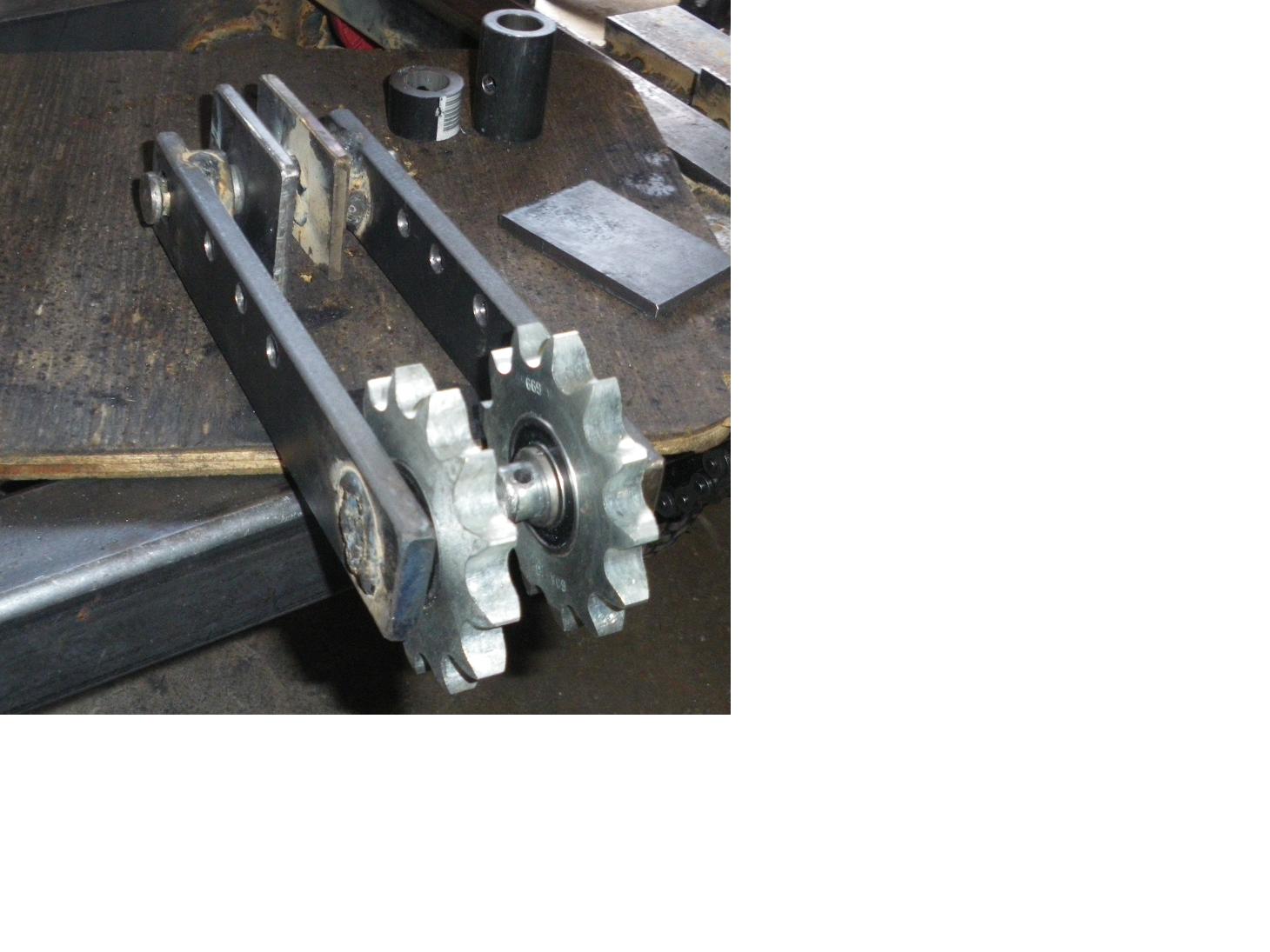

Completed both chain drive and idler sprocket install today and got a good start on the main control levers. Chain is 60H with 8,800 lbs breaking point. Pretty soon I will be ready to buy some hoses (28-ouch). Next hurdle will be, do I buy all the hoses, fill it up with at least 5 gallons of hydraulic fluid and see if it works, or when I get the welding finished, break it down, paint it, reassemble and then do the hydraulics? Problem I see with testing the hydraulics before painting is, major mess to clean up will all those hydraulic hoses.
