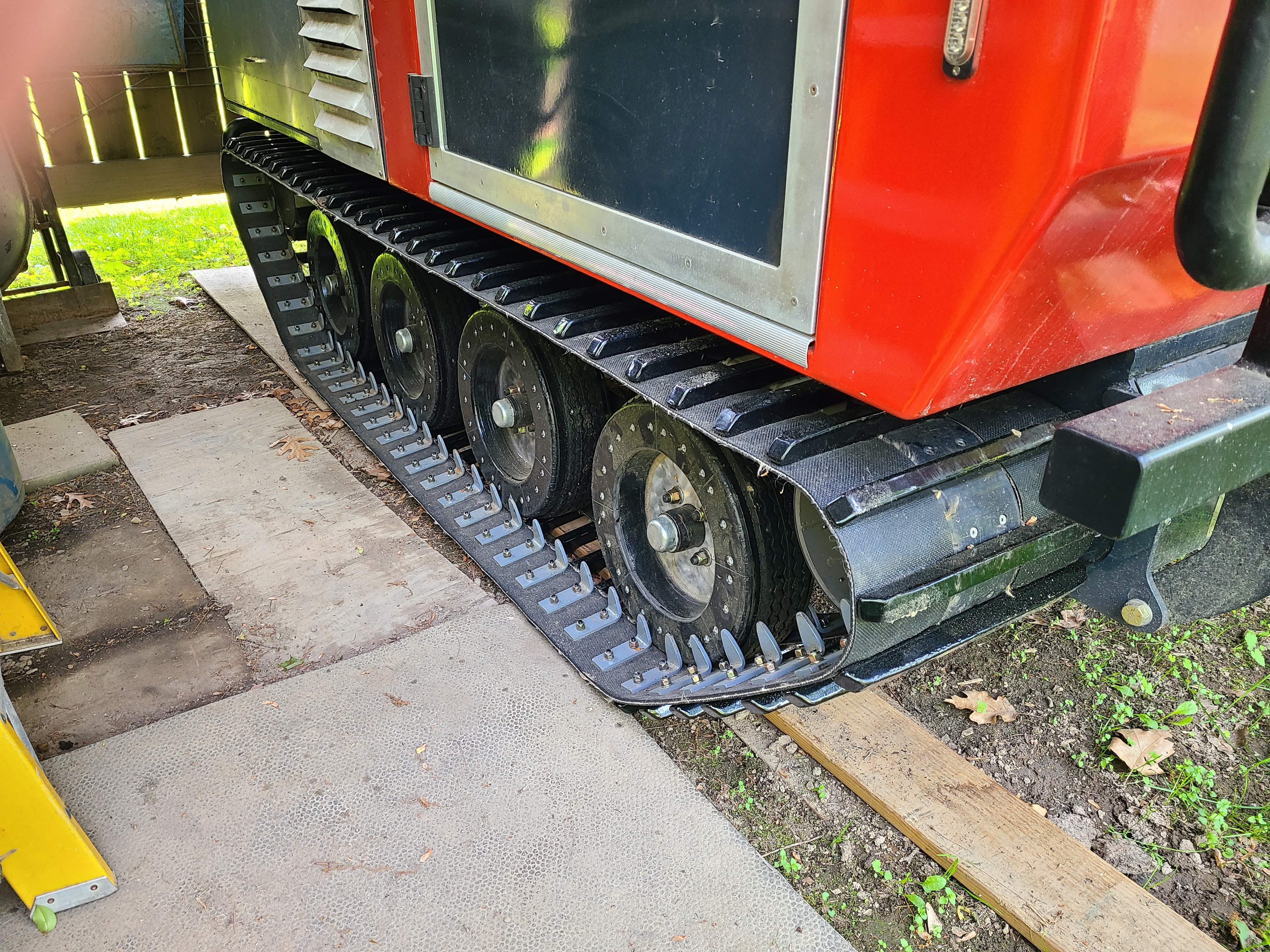

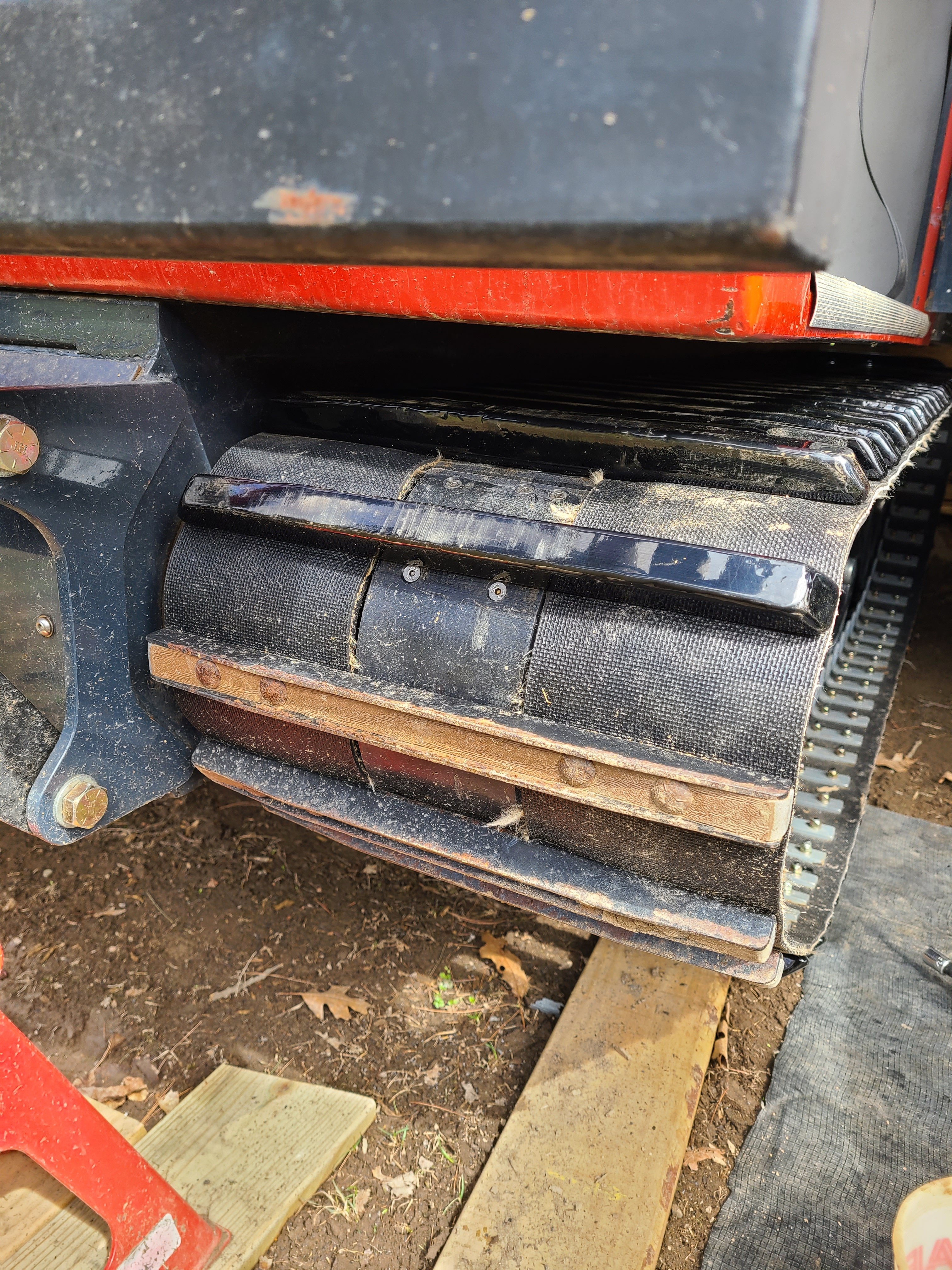

June update - last week, I finished welding strips of steel onto each of the 126 track bars thus closing them off so as not to be so aggressive to my lawn. The ground is still pretty moist from all the spring rain we received so I plan to take it out when it finally firms up a bit to see how bad they terrorize my grass.
In process:
Finished:

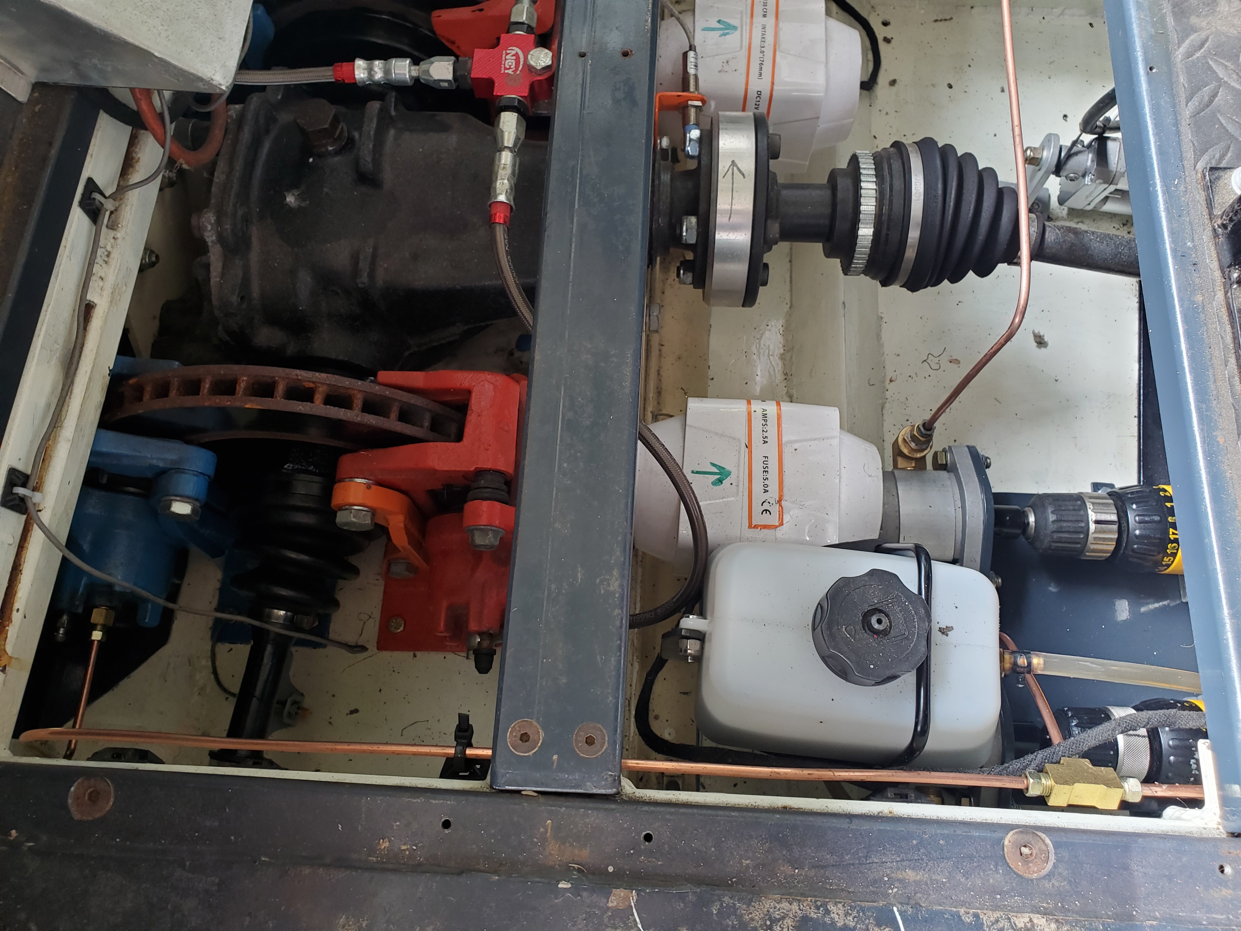

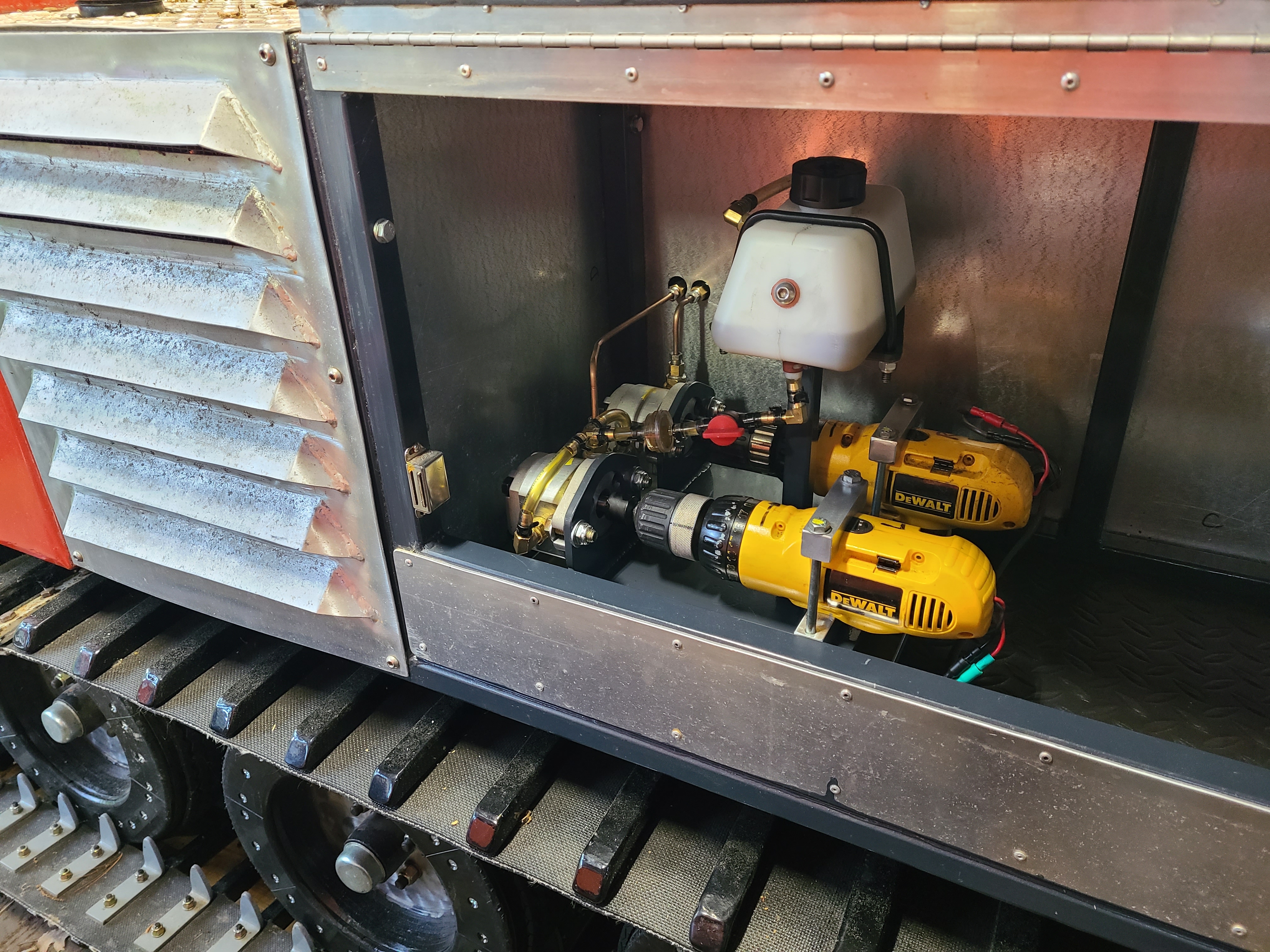

I finished relocating and piping up the hydraulic steering pumps from under the driver's seat to the left hand cargo storage box where I should have placed them originally. They will now be much more accessible especially to check the oil level and look for leaks.
Before:
Now:
