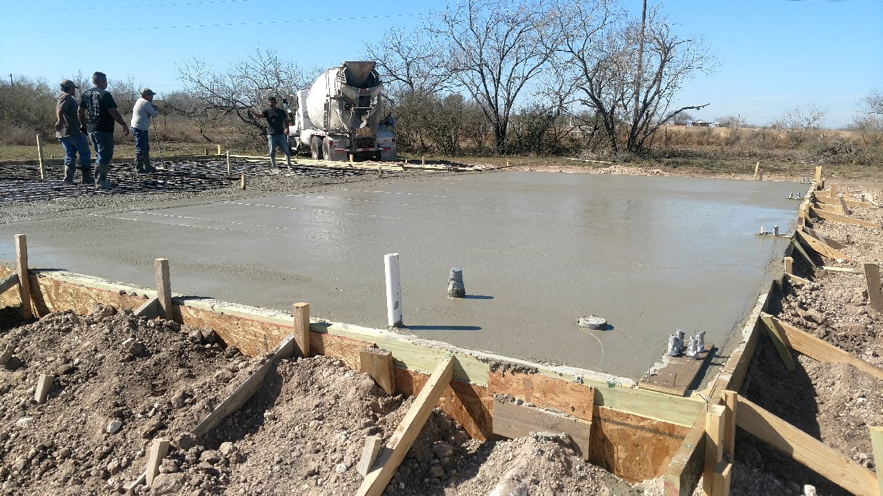

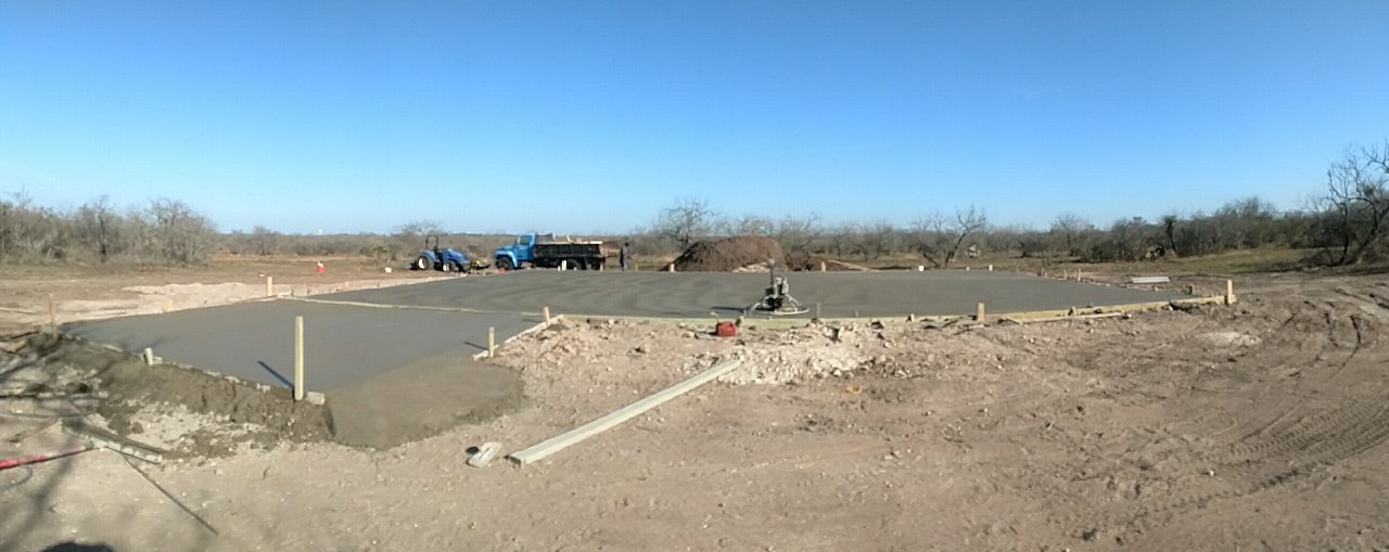

3 yards extra is better than 3 yards short. That is a good looking pour. Will you be sealing it, polishing it or epoxying the floor at all?
No, I had them finish it to this level so that it would still have some texture/traction. I just want it slick enough to drag stuff around on but, not so slick that if I spill something on it it becomes slippery. I'll be doing some maintenance on equipment and vehicles in here but, primarily it'll be a welding/fabrication shop.

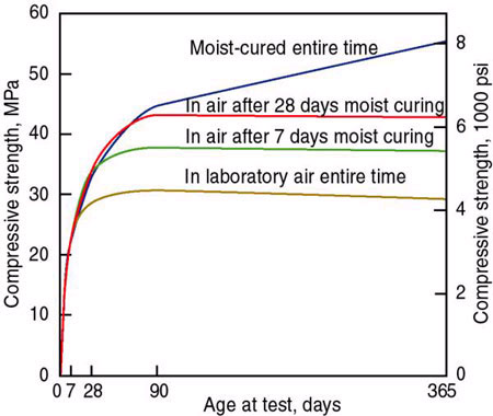

Congrats on the pour. I've never waited more then a day or two to start framing and always take off the forms the day after the pour. Nothing wrong with waiting longer, but if I remember correctly, you are somewhere at 90 percent cured in a couple of days, 95 percent after a month, and 98 percent after a year. While I'm sure that's not completely accurate, it's close enough for understanding how quickly the slab is ready for working on.
Concrete gets 75% of it's strength in the first 24 hours.
Full cure is achieved at 28 days.
Easy to remember! That 28 days has some other meaning as well!
/ My shop build #28
In actuality concrete continues to cure for around 100 years, granted at a very slow rate but it cures for a very long time.
They say that the Hoover dam is still in its cure phase
/ My shop build #29
Well that's because of all those bodies embedded in there.....
Sorry, couldn't help it.
I agree concrete cures very slowly. In the first 30 days you better refrain from dropping heavy sharp objects on your shop floor. :(
My shop is 7 years old. I work on it almost daily. I haven't noticed a distinct difference in a couple years. The first five I did.

The charts I've seen seem to agree that 7 days is the spot where things start to level off. I've left the forms on and they added some chemical agents to slow curing a little. I've also been wetting the surface a couple of times a day to reduce the heat and increase strength.
/ My shop build #31
I think that is very important in the long term. The first few days you need to slow the curing process all you can.

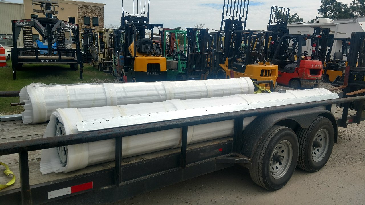

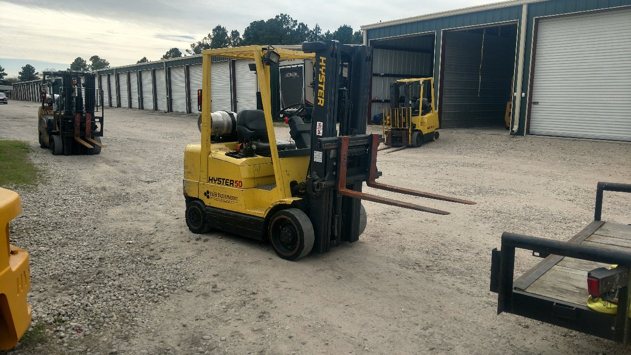

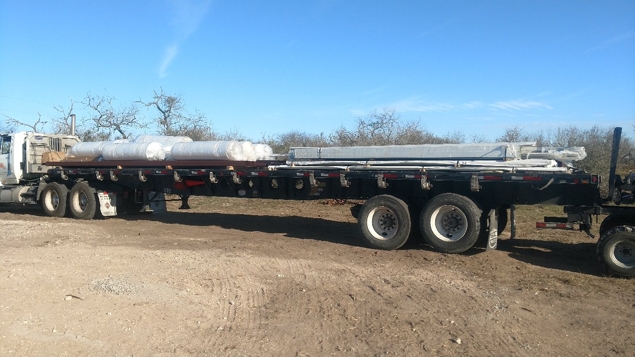

Building was delivered Thursday.
Went to Houston Thursday afternoon and spent the night at my daughter's place. Picked up my roll up doors and a forklift Friday and headed back South. I'm not sure if I'm more excited about the building being here or having a forklift again. Once you've had a true forklift, a tractor is a pretty poor substitute. I got a 3 stage mast, 4500 pound lift with side shift and 6150 hours on it for $3800. I need to replace the warehouse tires with traction tires and know that's going to run me another $500 - $700 but, I still feel like I got a pretty good deal. I'm hoping to be able to use this to do the building erection instead of renting a sky jack.
View attachment 496793 View attachment 496794
That's a good deal for sure. Even by auction standards. I love my forklift. 1978 hyster 3 stage. Bought it 3 years ago with a cracked block. Just keep the oil changed and it just keeps on going!

Isn't it just a bit disappointing when you look at the building materials laying on the ground and consider the amount of the check that had to be written. ;)
/ My shop build #38
Honestly, I didn't mind writing the check for the building, it's above ground and I can see it. The concrete, on the other hand, that check hurt.
