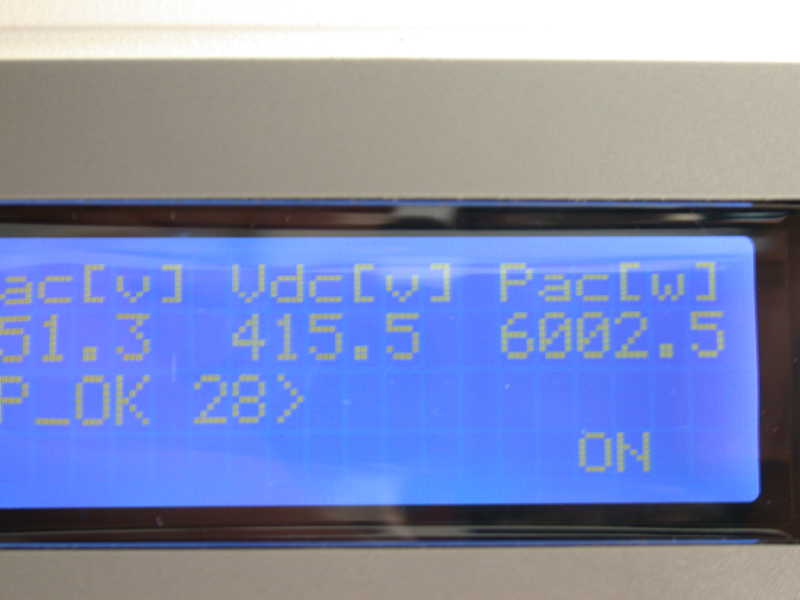

I have two systems, an off grid of about 2k and an interite from a grant that's 6.8kw that just went in in August.
rob
