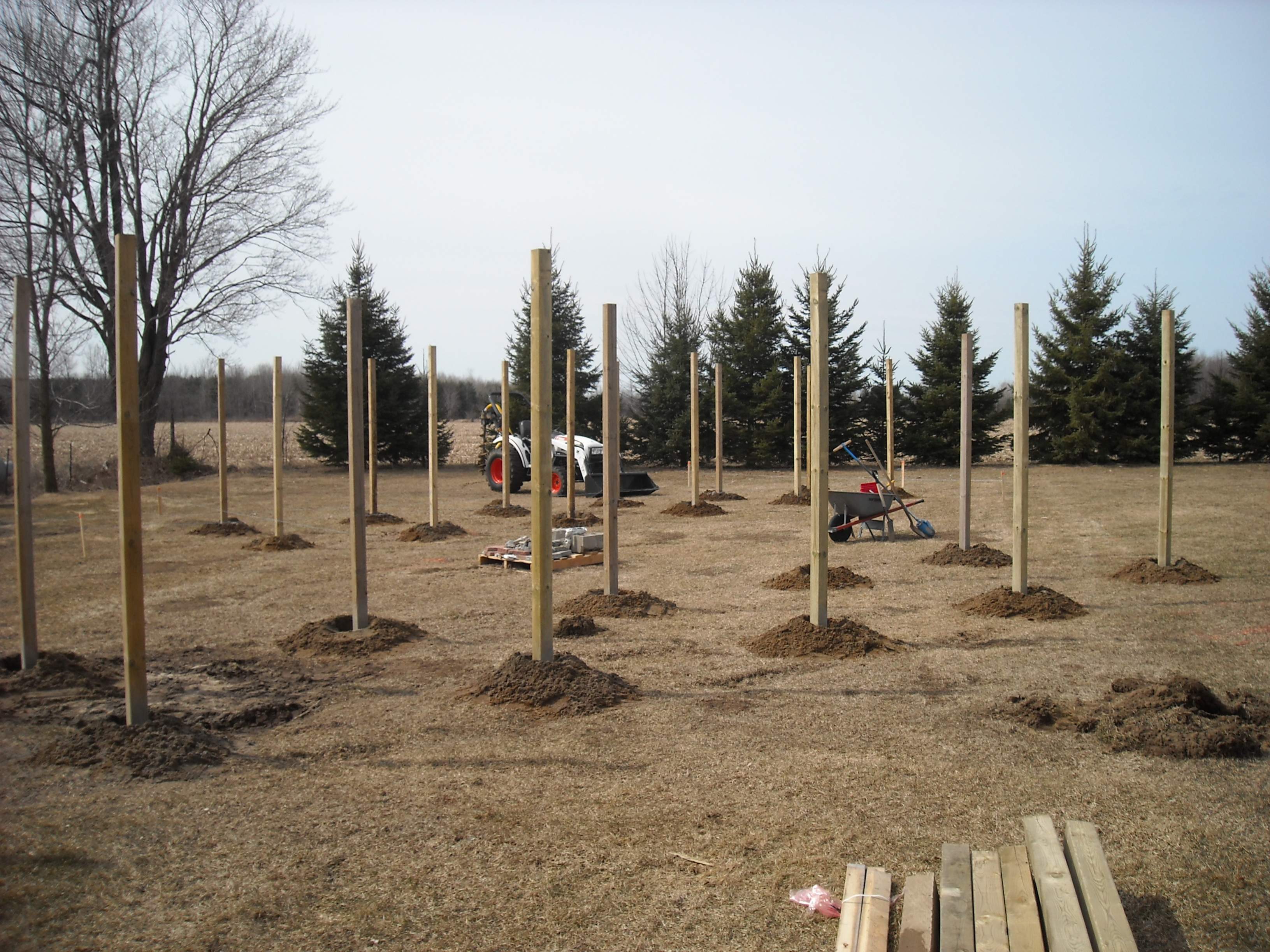

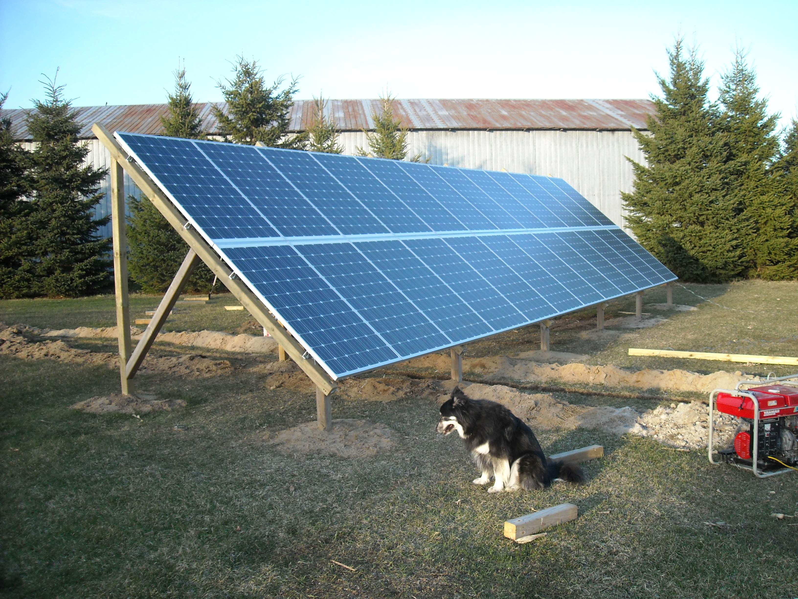

My little project that I'm just finishing up. There are two arrays like the one pictured. Total panel capacity is 11.75 kW. I'm over powering the inverters to boost output over the course of the day in contrast to installing trackers. Excess power will be discipated as heat. ( we are only allowed to push 10kW into the grid )
Gratuitous tractor pic included.

tcartwri - Very nice :thumbsup: and tnx for the tractor pix! I got a kick out of the "If I make too much power, I just dissipate it as heat".
