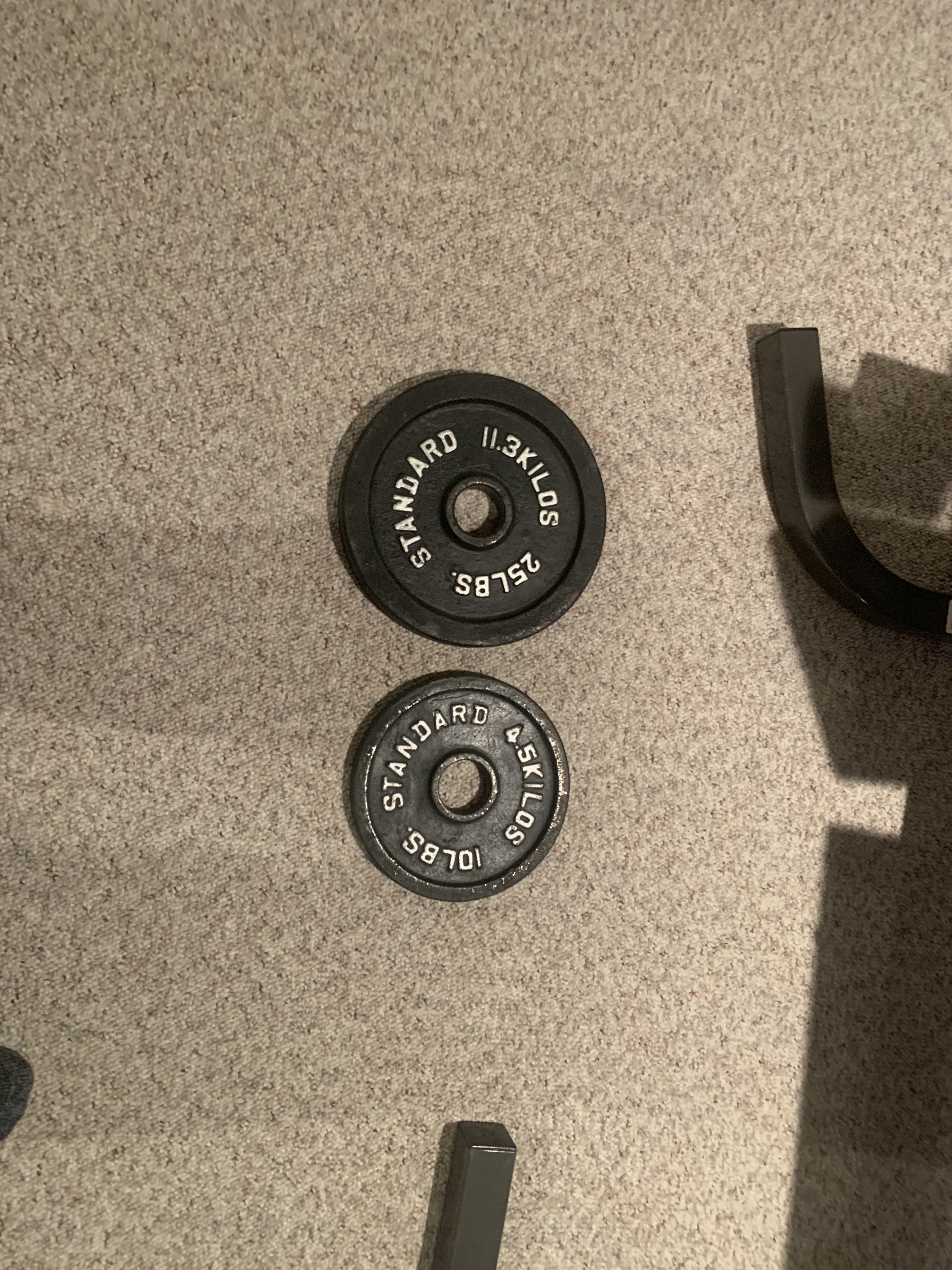

The safest and by far most effective way to remove it is with a makeshift slide hammer.
First remove the plastic shield, then drill a small hole maybe 5/16 or 3/8” near the end of the shaft.
Get a 10 or 25 lb cast iron dumbbell and slide on the shaft, put a rod or bolt with head removed through the drilled hole , this will be your slide stop.
Grab the dumbbell with both hands and rap it against the stop. I’ll guarantee it will come off with out much of a fight.
