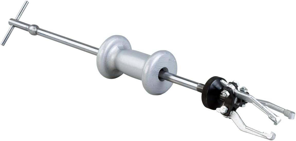

Could you take the u-joint apart and then possibly use a puller.
late to this thread, but this is the ONLY way to do this job. It's possible you already damaged the PTO by driving the shaft end onto it, but why double your chance of damage pulling on it?
They are not made to handle a lot of thrust force, and there are plenty of printed warnings about damaging one just by having a PTO shaft that's a bit too long, to where the telescoping driveshaft may bottom out and push on the stub as the implement goes up/down.
There's a rubber seal at the stub/housing interface, so torch heat is not your friend, here. Use a puller. If there's not enough space between driveshaft end and PTO housing to get standard gear puller jaws onto it, then use a bearing splitter type puller. A $30 puller could save you $1000 in repairs, and a lot of lost time.
