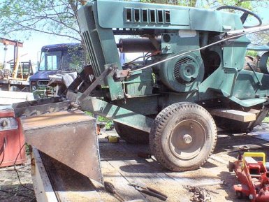

Started yesterday and here it is 13.5 x13.5 x 44.125 .

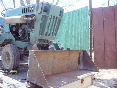

Here's #2

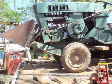

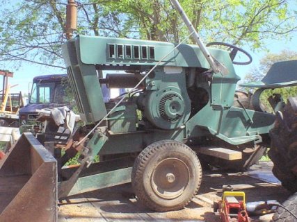

I did something wierd with that last one but here's the last.

Looks like you're ready! Is that a Sears SST framework?
   / My Style Johnny Bucket
To the best of my knowledge it's either '71 or '72 Suburban from Sears.

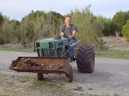

Just had to try it out /forums/images/graemlins/grin.gif /forums/images/graemlins/grin.gif scraped up 4 buckets with ease, but must do a little more on the release/ latch. Need to add spring to keep from over pulling , as it will not latch back when over pulled with out dismounting.

Here's a pic with partical bucket, as when full I couldn't lift it. Guess it's time to add the hydraulics.

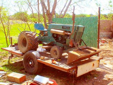

You know, I looked at that first picture and I thought the tractor was twenty feet tall. It looked huge. Then later on the trailer and especially with a driver, it looks quite small. Perspective, I guess.
Interesting work on the bucket. You seem to have many clever and useful projects.

Picked up Hydraulic pump, filter housing, lovejoy coupler and three lever spool valve for $16.32 from salvage yard. Now I got to work some more.
