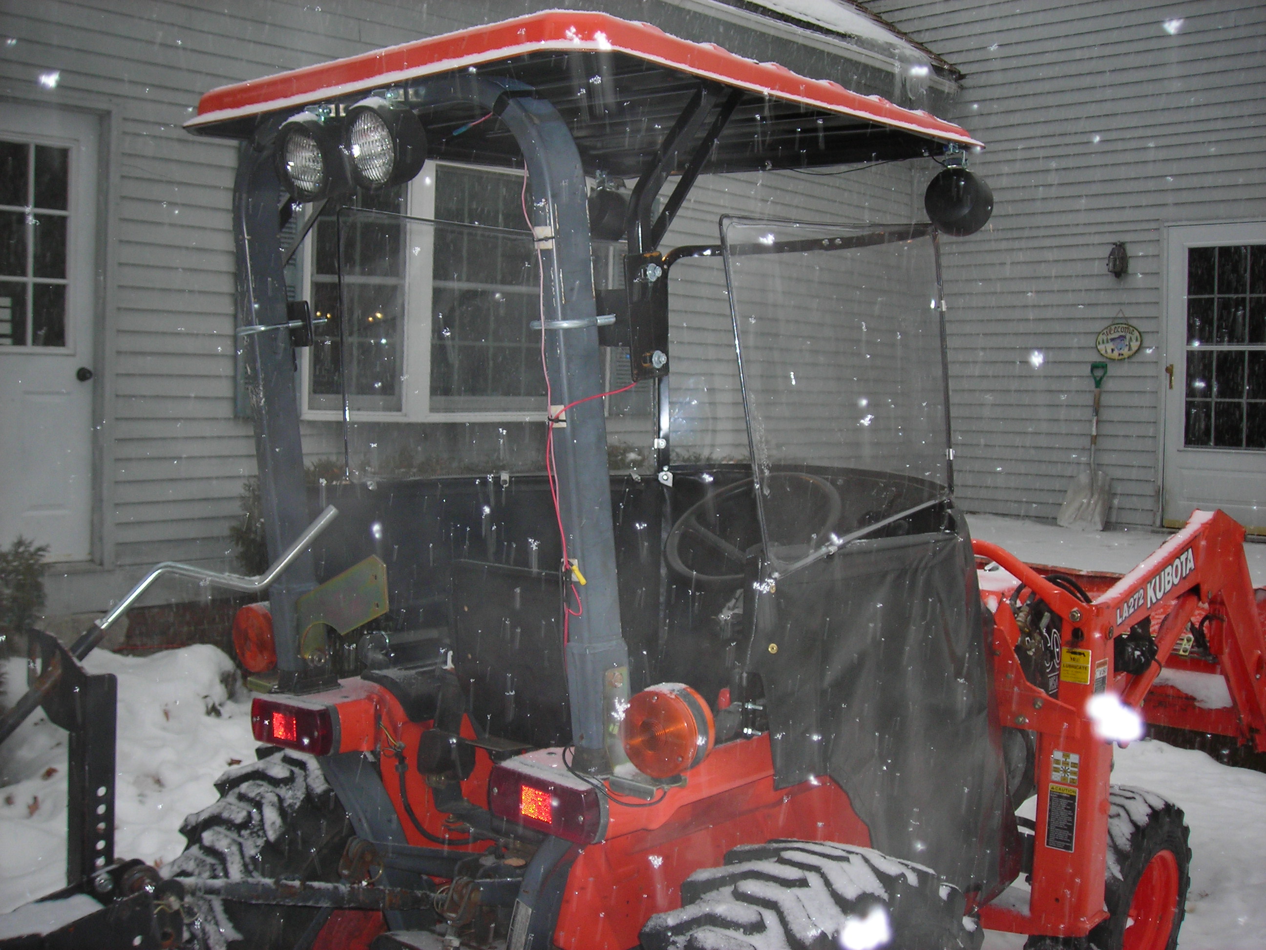

I finished my improvised cab just in time to go out and snow blow after our first nor'easter....
thanks to the input and ideas from my previous post on this topic, i decided to use 1" pvc pipe and fittings $15, topped off with a half a sheet of osb plywood $7 and a $69 golf cart cover......
not pretty, but it works to keep the blowing snow off ......

Can't beat the price! Looks like it will do the job.
How did you fasten the front to the tractor?
Where did you get the golf cart cover?

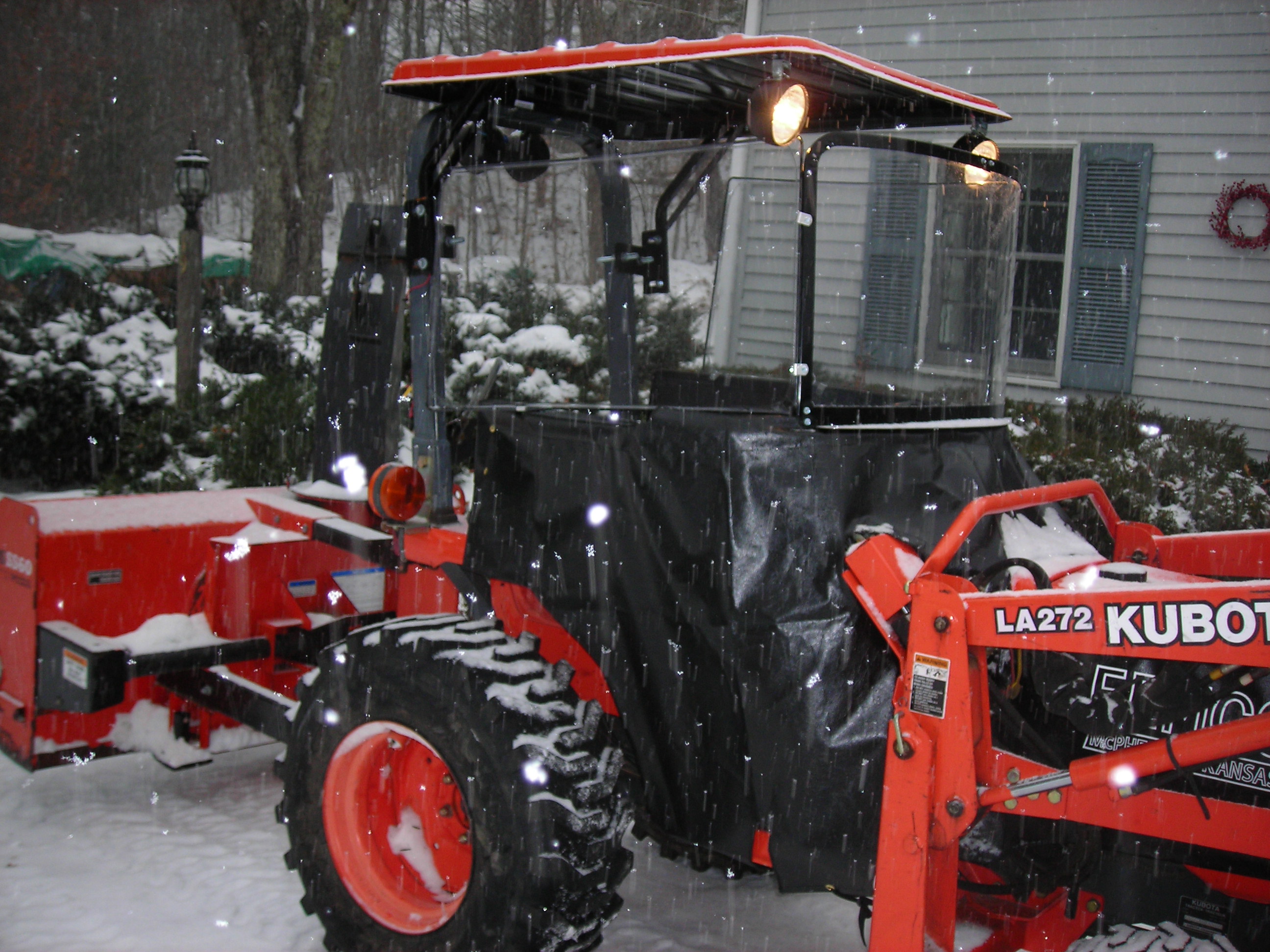

I like it Jim! Something like that may work for me. How is it in the wind?

i used 3" hose clamps around the pvc and the brace for the FEL... i also used the hose clamps to attach the back piece to the ROPS... the i used 1" u bolts to tie the plywood to the pvc frame....
the cover came from golfsmith.com it's the cheap model for $69.... next year i might upgrade to the delux model......

haven't tried it in high winds yet...... fingers crossed... that will actually happen later today when the snow stops.... winds are gusting right now...
the cover has hooks built in that would attach to the golf cart.... i'm using the same hooks to attach under the operator platform and fenders......
it's certainly not air tight but the main purpose is to keep the blowing snow out....
