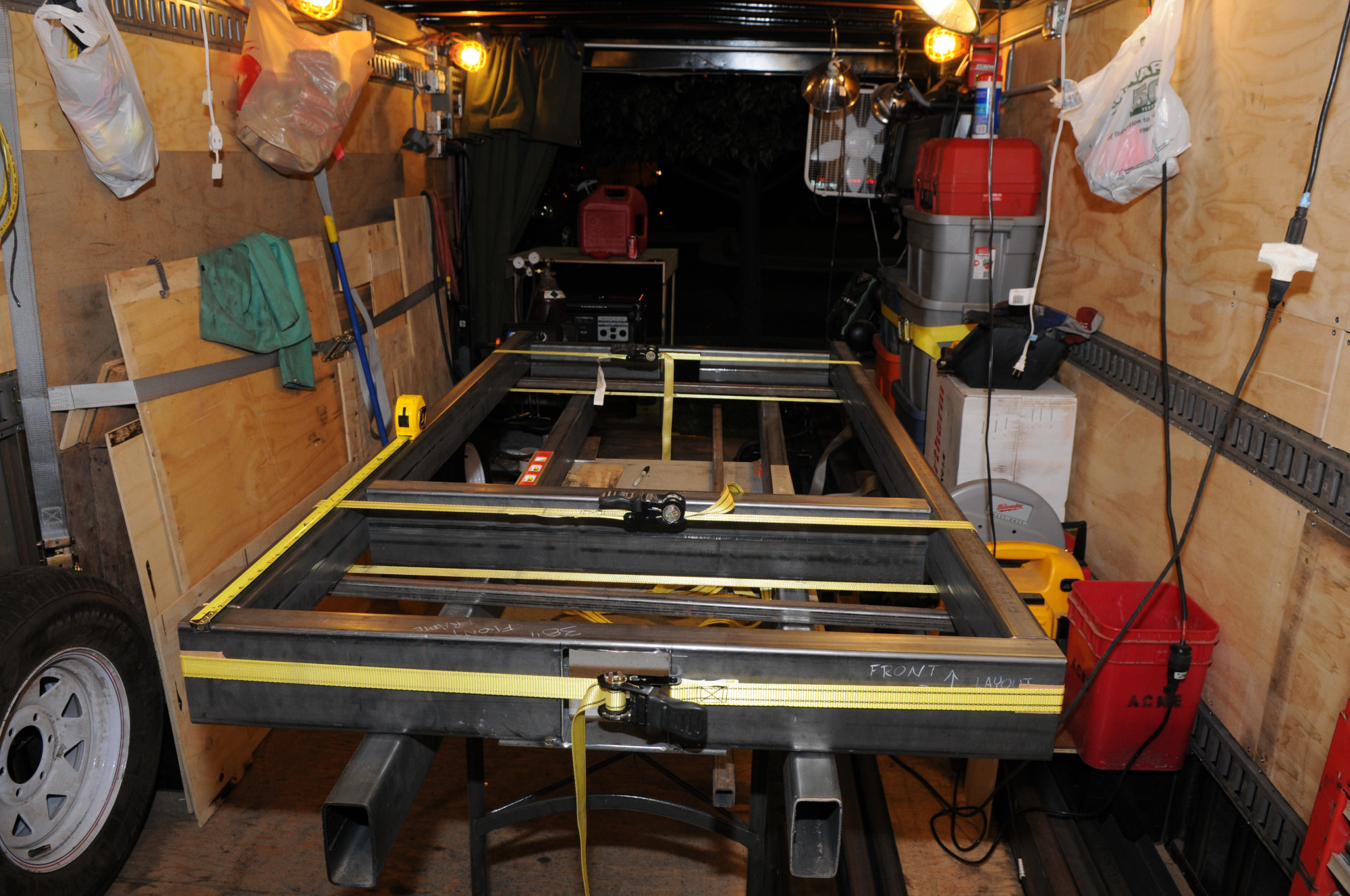

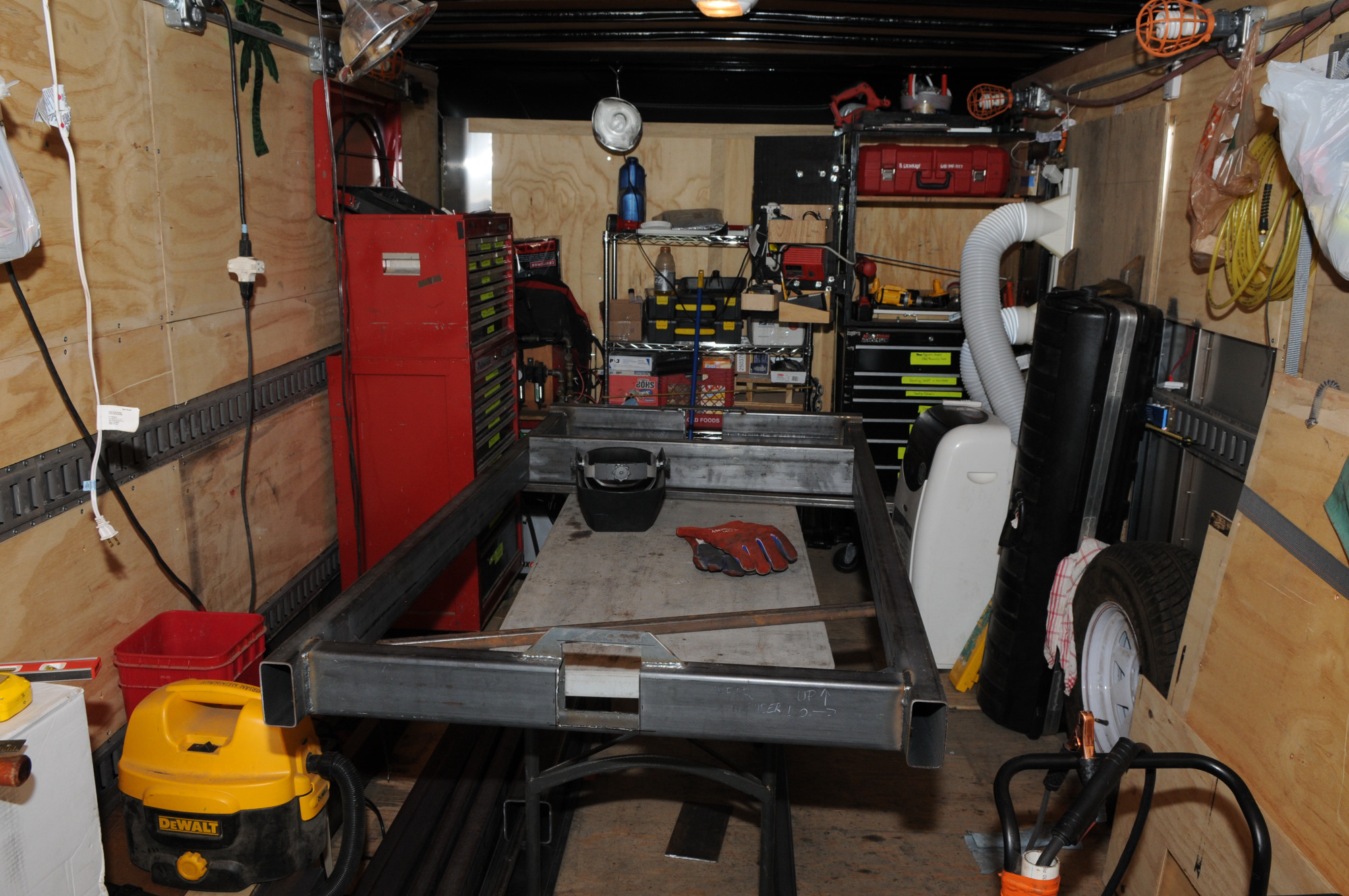

Here's the update.

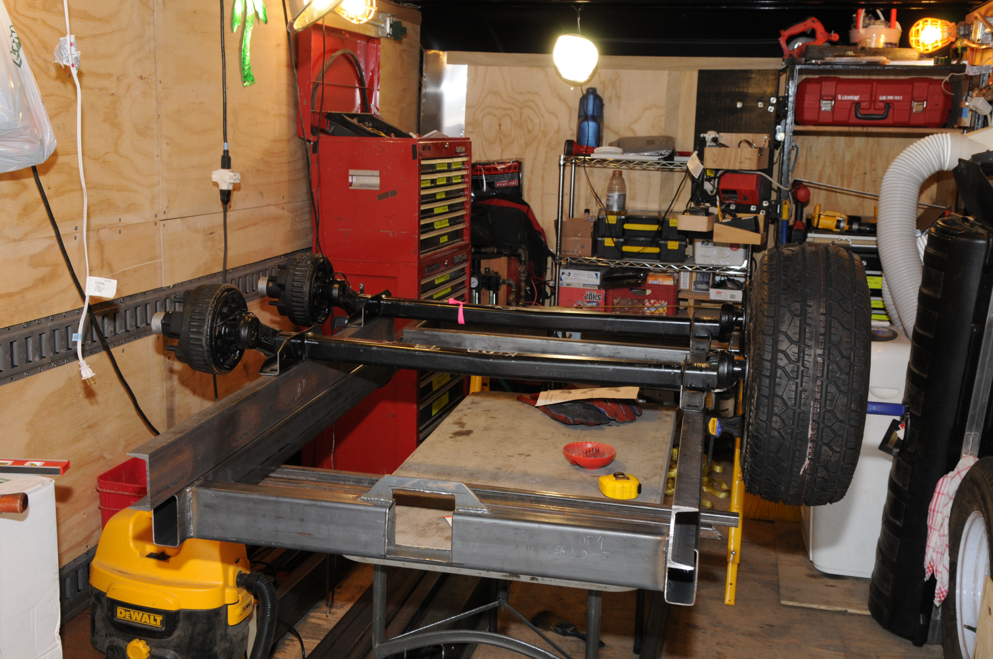

I got the 2x4x11ga. main frame welded up. Used my new plasma to cut the notches for the receiver tube and the helper/holder tube. Got it all laid out and mostly welded up. Everything was dead on square. Then I added small gussets to the back corners. And now I'm a 1/16th out! Can live being out only 1/16th, but I was so excited to be dead on to begin with such little effort.
The last picture is laying out the sub-frame and the axles. Only having one wheel was tough. The subframe (4"x5.4lb/ft channel) got a 45 cut on the front end. The back was cut 14" in on the bottom to the top back corner. A replacement flange was welded on the cut edge. No pics yet of the finished subframe rails.
