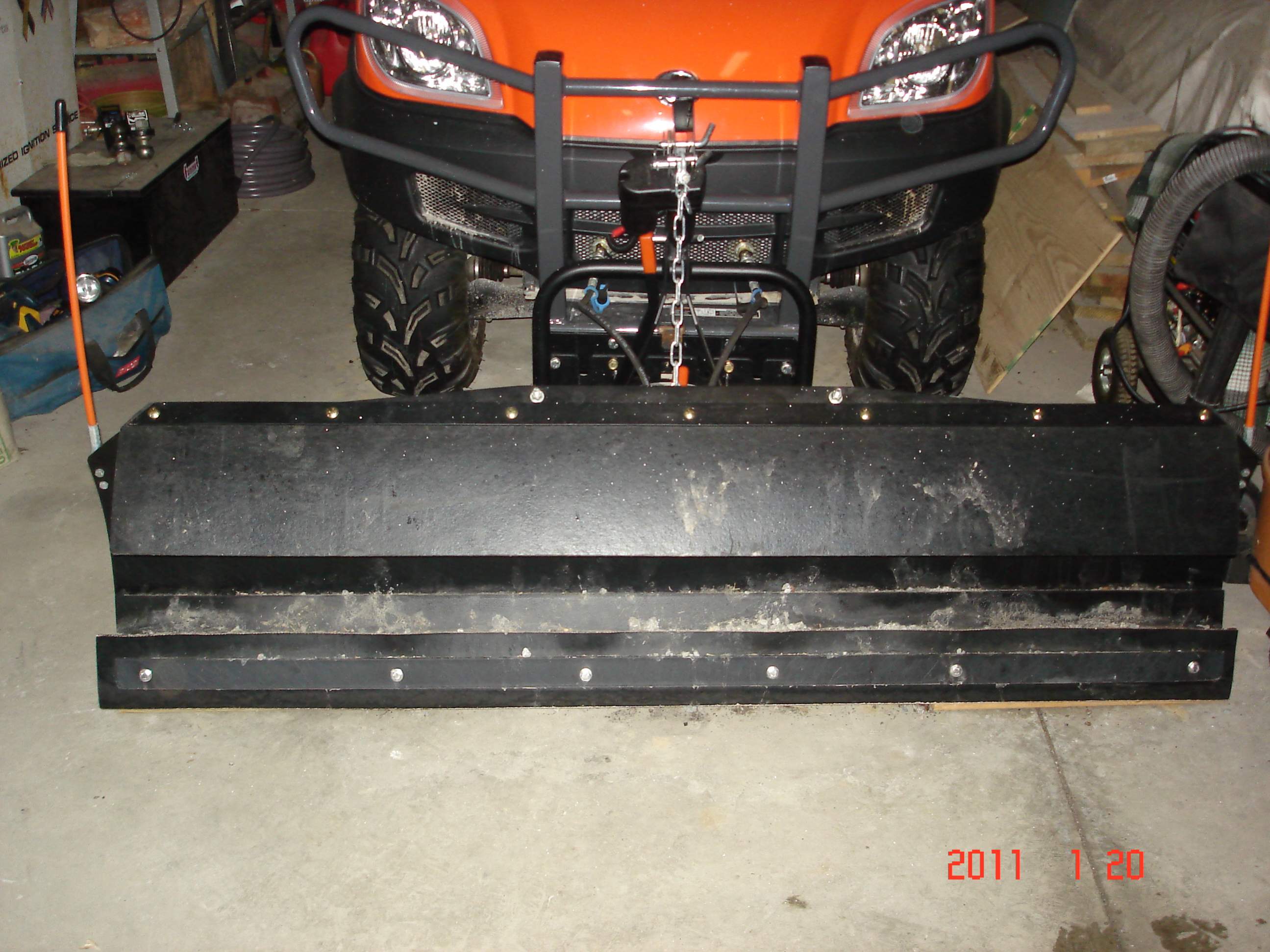

I've been doing that for years using machine belts..Works great. Weled 2 pieces of Lowes 1/8 plate together and drilled & bolted with stainless fasteners. Left equal amounts above and below the retainer so it can be flipped when worn.

I agree about the steel prices but I ponied up for the convenience. No rust removal, cut, MIG, grind and paint. If I needed 200' of it I'd be hunting too.
Don't know much about snowmobile belts but I'd guess they have some degree of similarity to machine belts in terms of construction...Don't use a dry-rotted belt though, they fall apart faster than you can imagine..The horse stall mats at TSC make sense given they are fresh. I had access to new discarded 3'x20' belts from a mill that is now leveled. Have to care for my remaining inventory.:(
