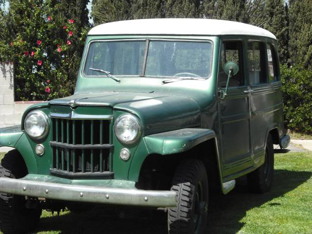

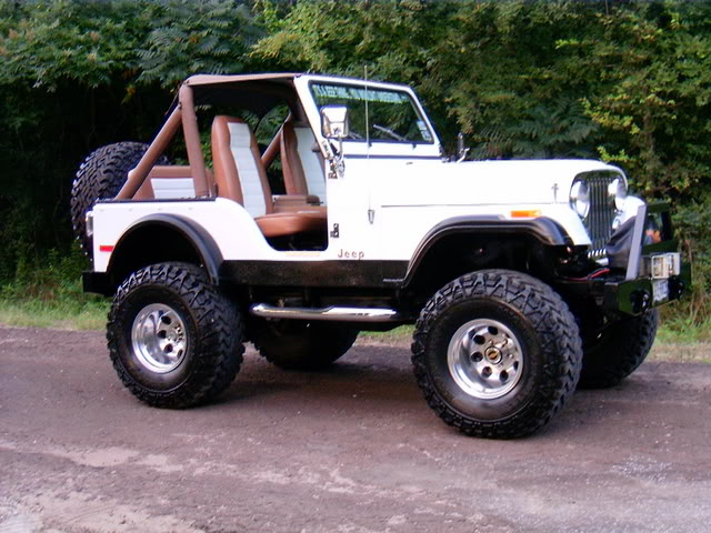

I'm not offering an opinion on duallys vs singles. When I was a young buck, I had a Jeep CJ5 with big/wide Desert Dog tires on it. We got a good snow, and I tore across the fields with snow 18" deep, and promptly got stuck. I also had a 1954 Jeep Wagon, with tall skinny Plain Jane snow tires. I drove the old Jeep out as nice as can be and pulled the new Jeep with its fancy tires back home. Never came close to getting stuck.
So, if I'm traveling across deep snow, I would prefer tall and skinny. That said, those duallys are probably traveling behind the plow in snow that is not deep at all. In that case, maybe having more surface area gives you more traction for pushing - I don't know. I just wish I still had that 54 Jeep wagon.
