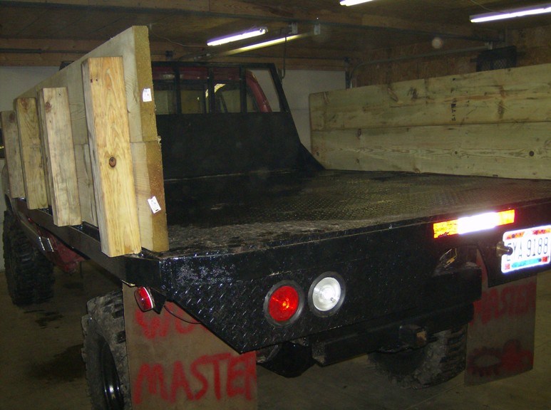

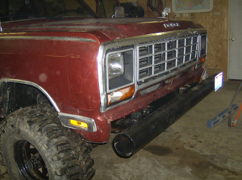

I had a 1985 dodge that had 35x16 r16.5 Boggers on it. I never could get that thing stuck in the snow. I could go through drifts till I was plowing snow with the front pipe bumper back in the fields, and if I couldnt go forward anymore, I'd just back out and go again.
According to you guys it should have sucked in the snow. But my 1/2-ton truck at the time, with comparably tall skinny tires, didnt make it far off the road at all. The dodge would go where ever I wanted.
View attachment 493710View attachment 493711View attachment 493712

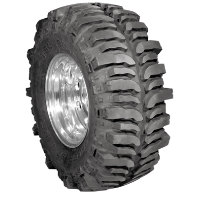

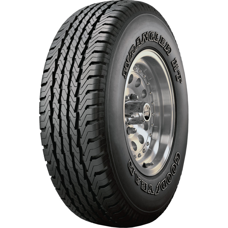

It all depends on the tread depth and if you want to float on top, or sink down and dig in.
Your boggers had a very open tread design, so they would dig into the snow well and they were wide enough to float on hard snow.
If your half ton had "road tires" with a more closed tread pattern and less spaces, it would do poorly in the snow even if it were narrower.
Some examples:
Goodyear Wrangler HT (Goodyear - Page Not Found | Goodyear Tires
Bogger (Page not found | Interco Tire

Point was that everyone keeps saying that a wide mud tire dont do well in the snow. And my 16" wide mud tires did just fine in the snow.
