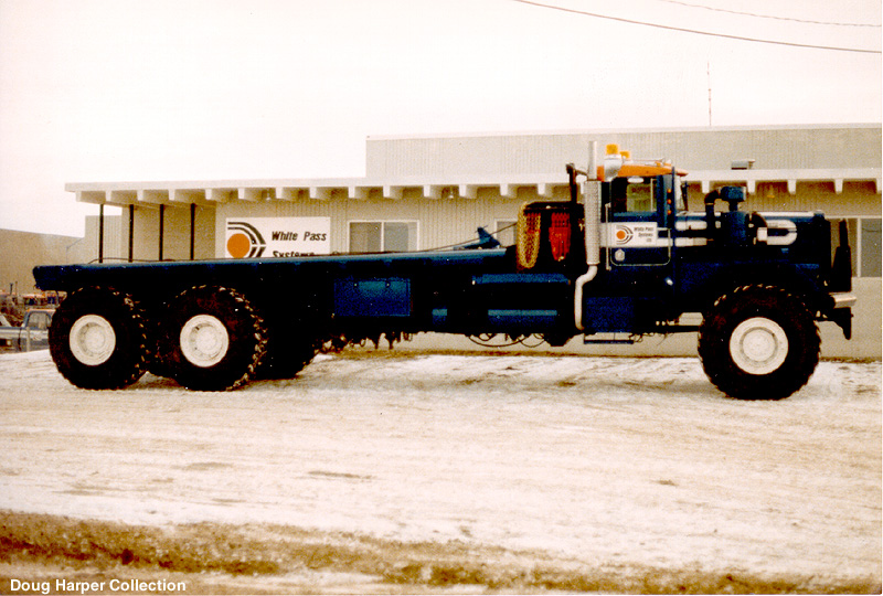

Interesting truck from the Yukon:
Bruce
   / My truck is in the ditch! #172
The traction isn't from the snow, the idea of the skinny tire is to cut thru the snow down to the bare road or dirt and find its traction.
If you are in a situation where you need flotation in snow, you better get a set of tracks!

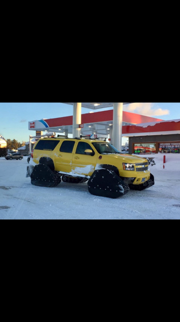

Probably the wide tire floatation concept versus skinny tire digging in and biting more depend on numerous variable conditions. As long as the floatation tire is actually floating on the surface, things are fine and dandy, but once they break through the surface and dig down in, all the physics change and things suddenly aren't so rosey. The two vehicles pictured above seem to indicate that both concepts could work quite well, but something halfway in-between (a status which duallies can fall into under certain conditions) may not.
Yep, plenty of variables.
Traversing snow off-road vs. pushing a 1000# plow plus 1000#+ snow load down a track are very different applications.
Bruce
Thats a winch truck for moving skid type equipment. The tires are so large due to the very heavy loads they are able to move around. When we would move a drilling rig in or out of a location, a winch truck was used to move various pieces around location for cleaning or assembly. There is a winch or most likely two right behind the cab of that truck and a tail roller on it. They drop a loop of heavy cable down around the end of the skid mounted equipment, pick it up and pull it up over the tail roller until it heavy balances. Then they drive to where they want to put it and slack the winch off. Really neat to watch!
