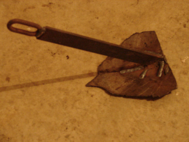

Without actually seeing a picture the advice is going to be more general than specific. What I can tell you is snow makes it much easier to pull tires sideways. I personally would try to find a way to get an anchor to pull from so you can pull the front back onto the road. I'm not sure if I would use a tractor as an anchor as once attached if things go wrong it could drag your tractor with it. If the ground isn't frozen (if it is you'll most likely have to bust through it but it could help the anchor) then a land anchor would most likely be what you want. If you have access to a welder and a set of torches you can make one pretty easily.

When we were 4 wheeling' in Alaska - we would always carry a double fluke boat anchor with a "pull out" cable. There were very few trees that could provide a good anchor point. Just hammer the flukes into the ground - attach the winch line and "pull" will bury the anchor. The "pull out" cable was used get the anchor out of its buried position without having to dig it out. Provides an excellent anchor point for a Warn 10,000# winch.
