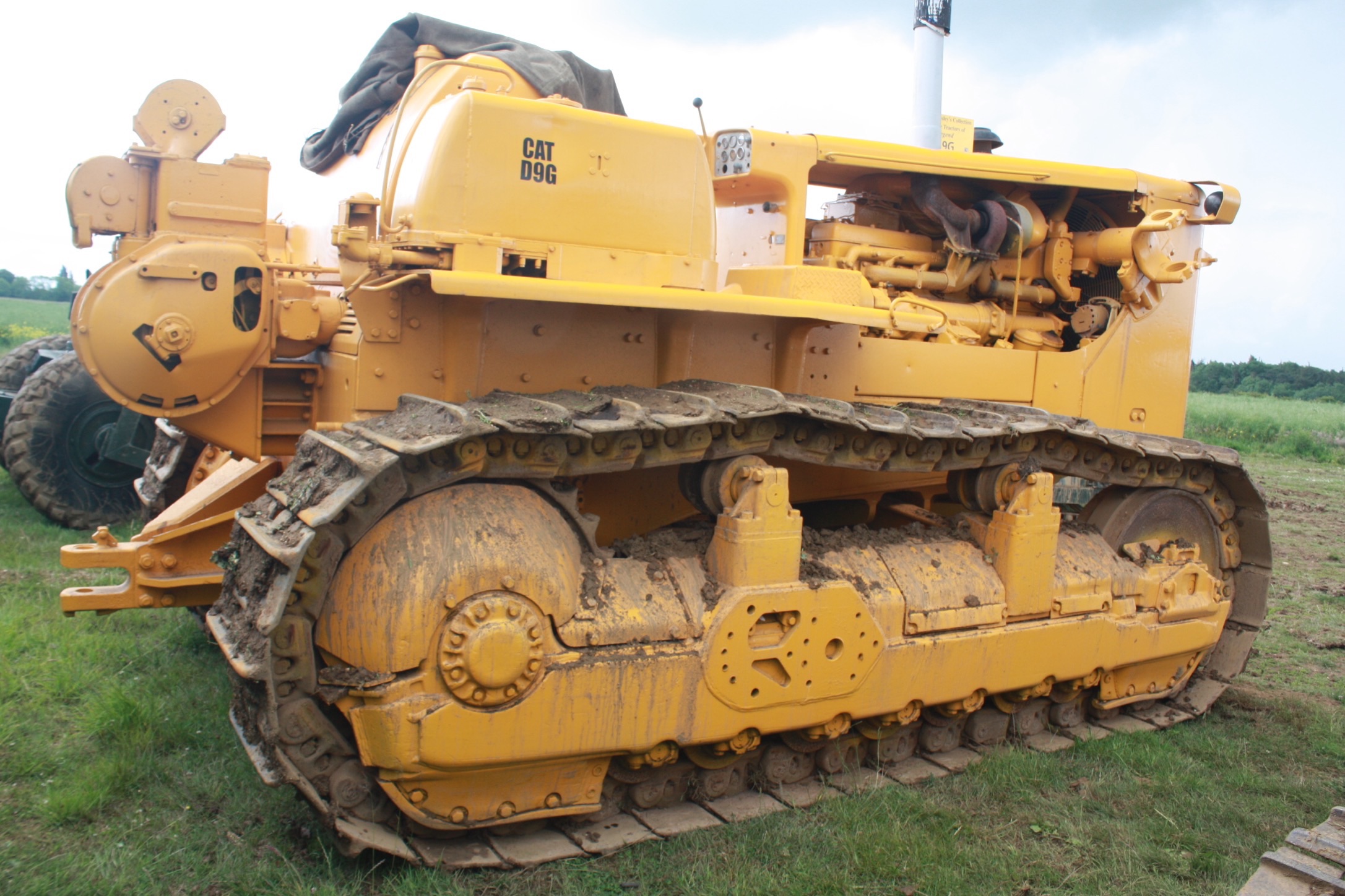

   / My truck is in the ditch! #34
A regular dozer track on ice is just a bunch of ice skates when it comes to sideways motion, as the video shows
Bruce

   / My truck is in the ditch! #36
Bruce
Yep. But forward is a different story.

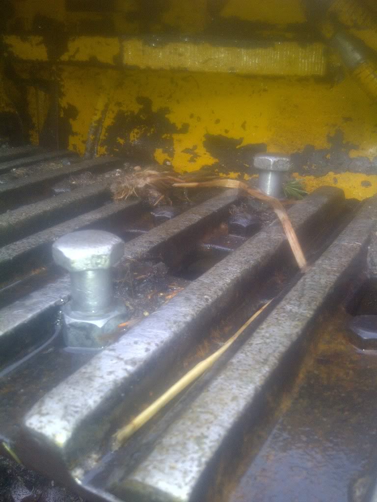

   / My truck is in the ditch! #38
Winter use tracked stuff may have cauk's welded to the cleats/grouser's. Works well or at least it did fifty years ago. The welded on cauls shown are a little too long for real ice.
