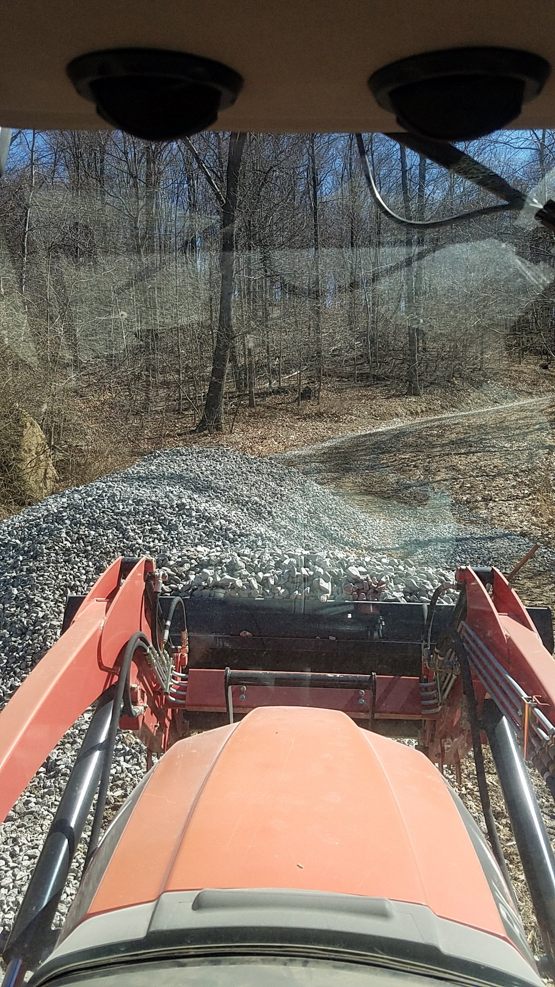

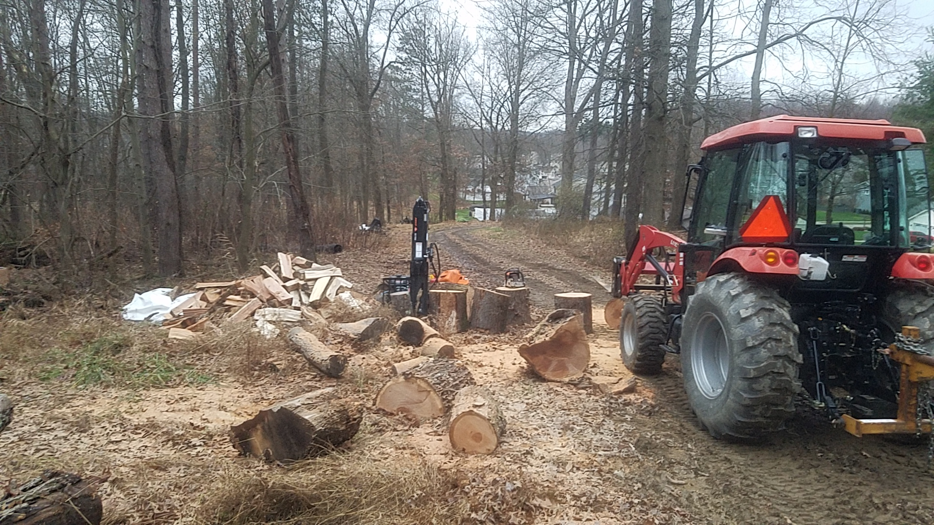

Thank you for the welcomes and participating in my post. I am surprised at how few pictures I have if my machine, but here are the first 2 I i found.
PS: big fan of Mike and Melissa Morgan. Our properties, lifestyle and equipment needs are similar. He does a superb job sharing his life and experiences in YouTube. I wish he'd been able to keep his RK'S long enough to get the hours I have. Just into my first scheduled service post- break in, I expected better, but it's the lack of service that finished me as an RK customer.

Can’t really tell much by the pictures but it does look like a pretty decent tractor, very unfortunate that you don’t have a decent dealer nearby
