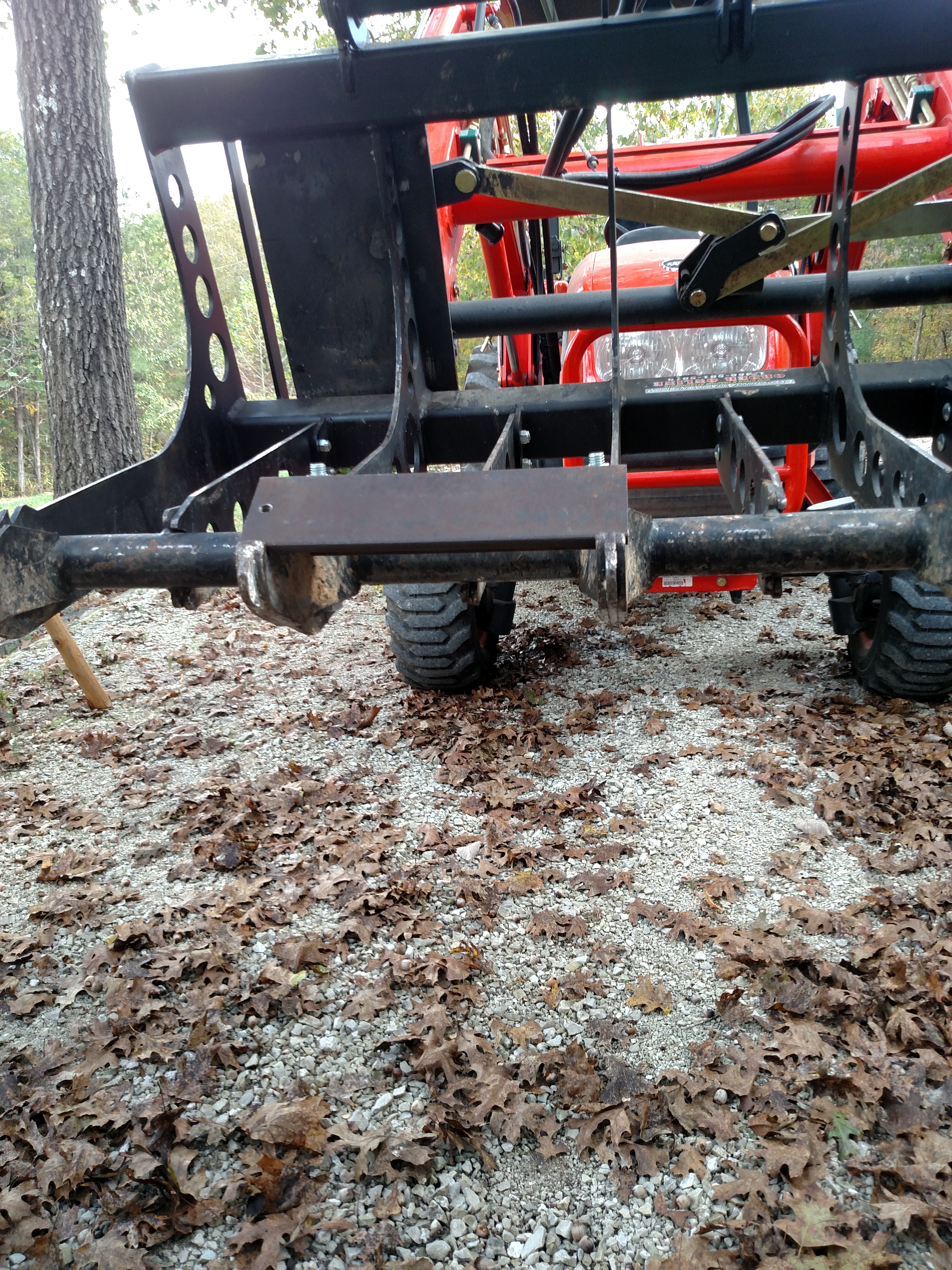

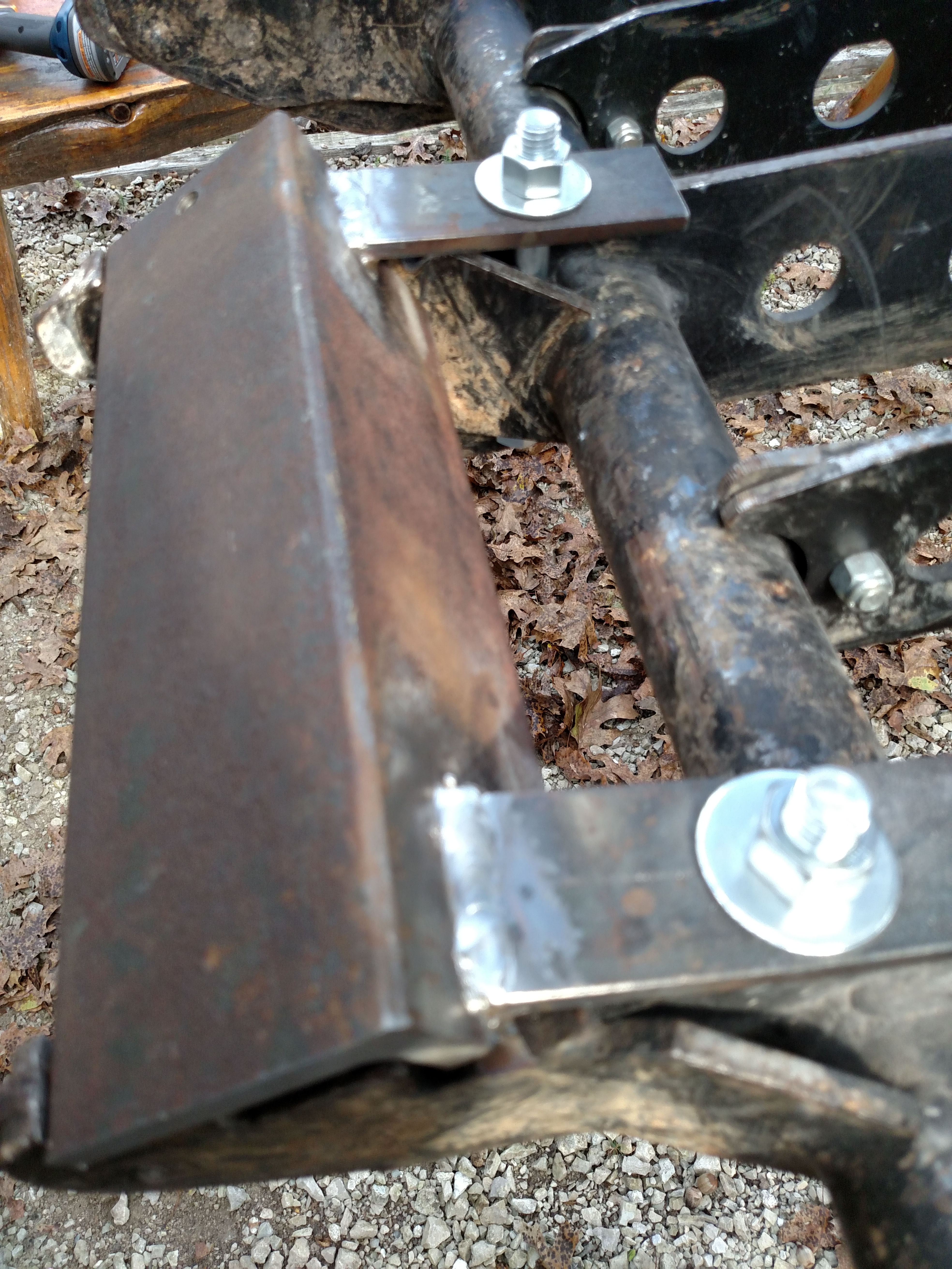

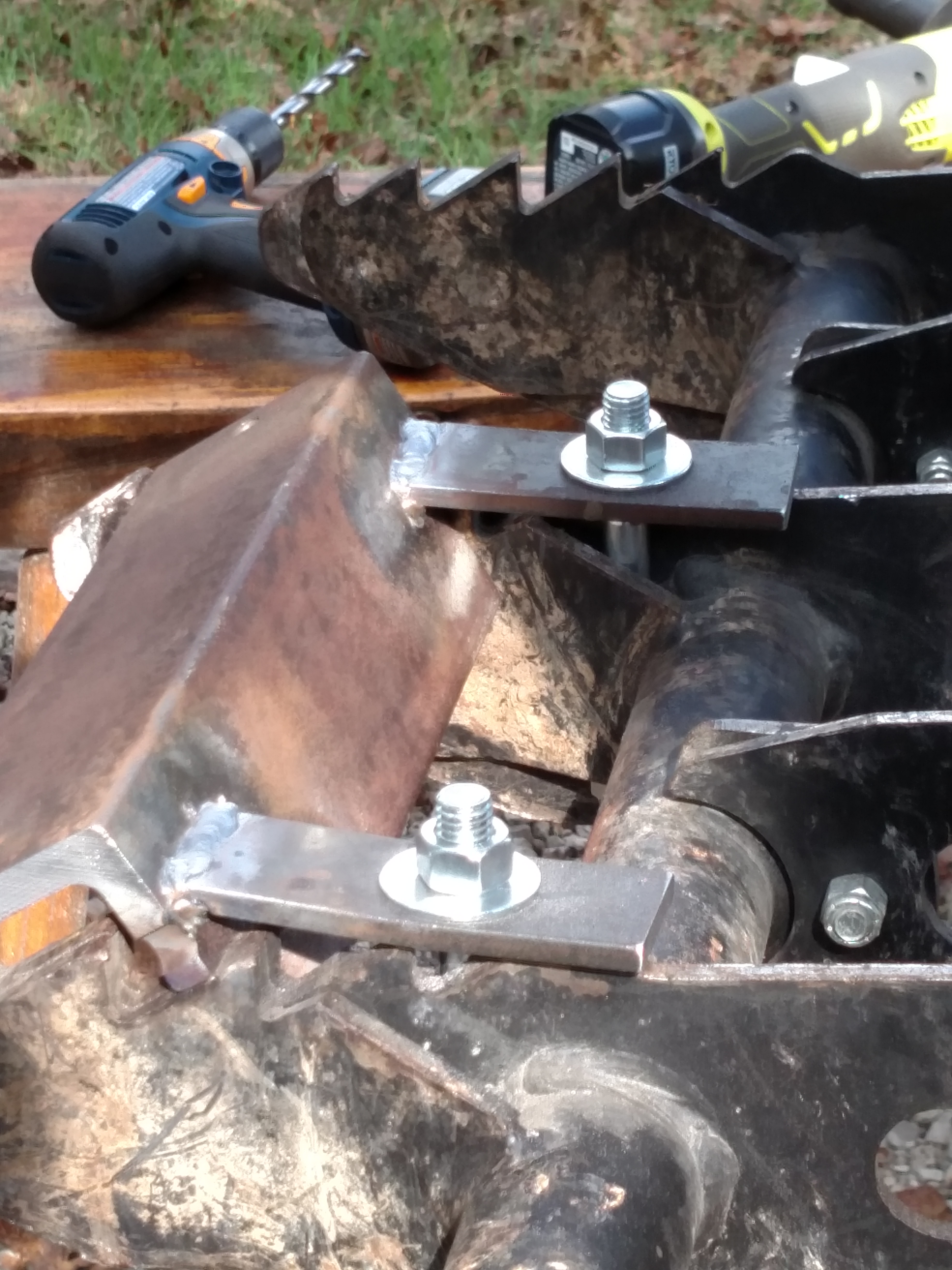

OK, Revision 2 has been manufactured and placed into operation.
Lessons learned:
1: While the lower jaw with the long 1/2 inch all thread "bolt" seemed like a good idea at the time, and met the criterion of no modifications to the grapple itself, when using the grapple for it original purpose of root grubbing without taking off this attachment, some problems were noted. OK you say, why in heck didn't you just take it off? Heck it unbolts pretty easy. Yes, but I wanted it to work better. What was happening is if you hit a rock while grubbing it would bend the all thread and "booger" the end, making the nut hard to get off. So I decided to modify the lower.
2: The upper had started to bend just a bit on one side from lack of support so I welded in some support. Lets see it bend now!
I went ahead and welded the heads of the bolts to the plate so no second wrench would be needed to tighten them as this would have been difficult after the support was welded in anyway. All in all a win win situation as no bolt to drop on the ground.
3: This new lower should be strong, made out of a piece of structural building steel and it is thicker as well.

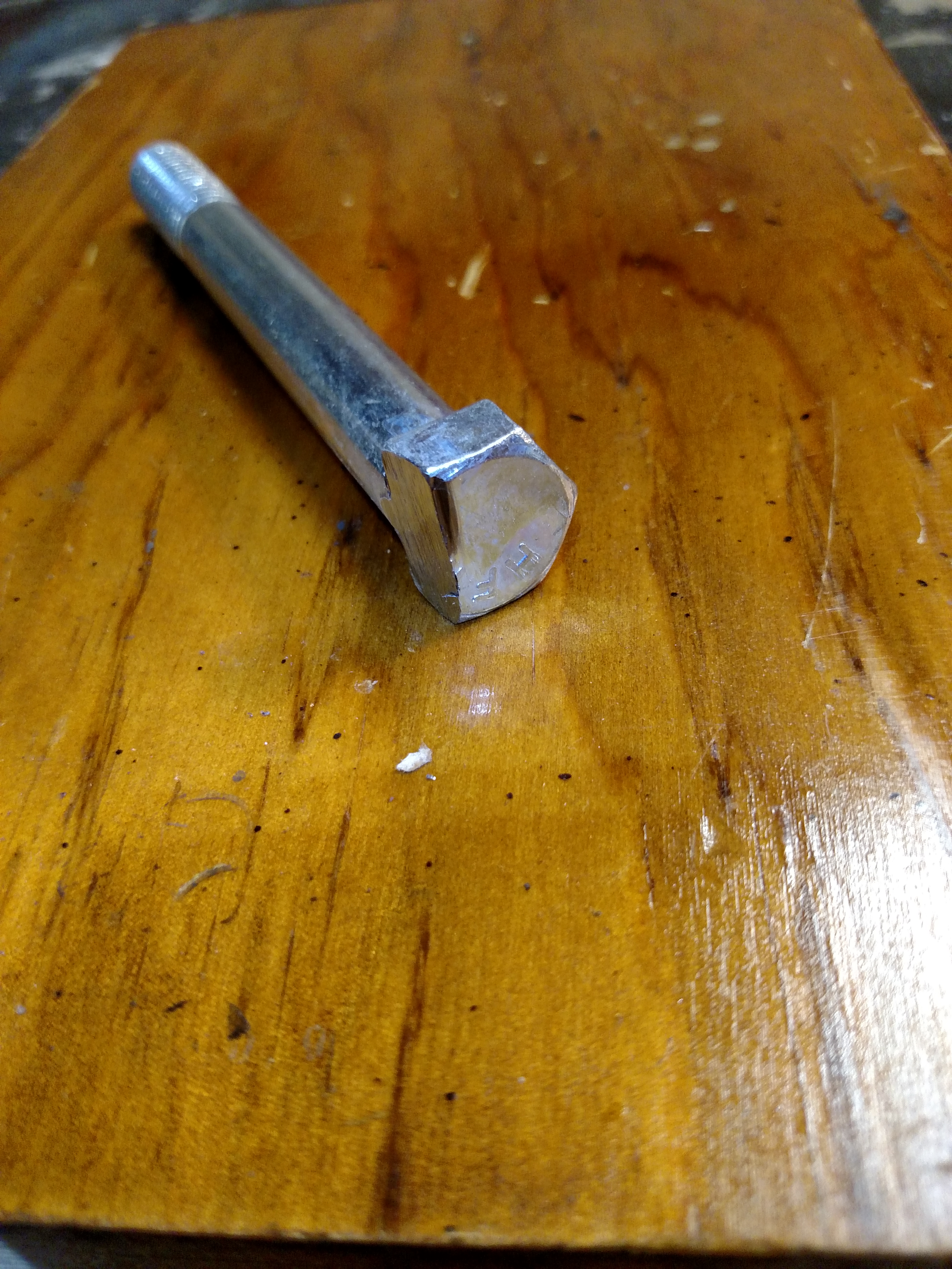

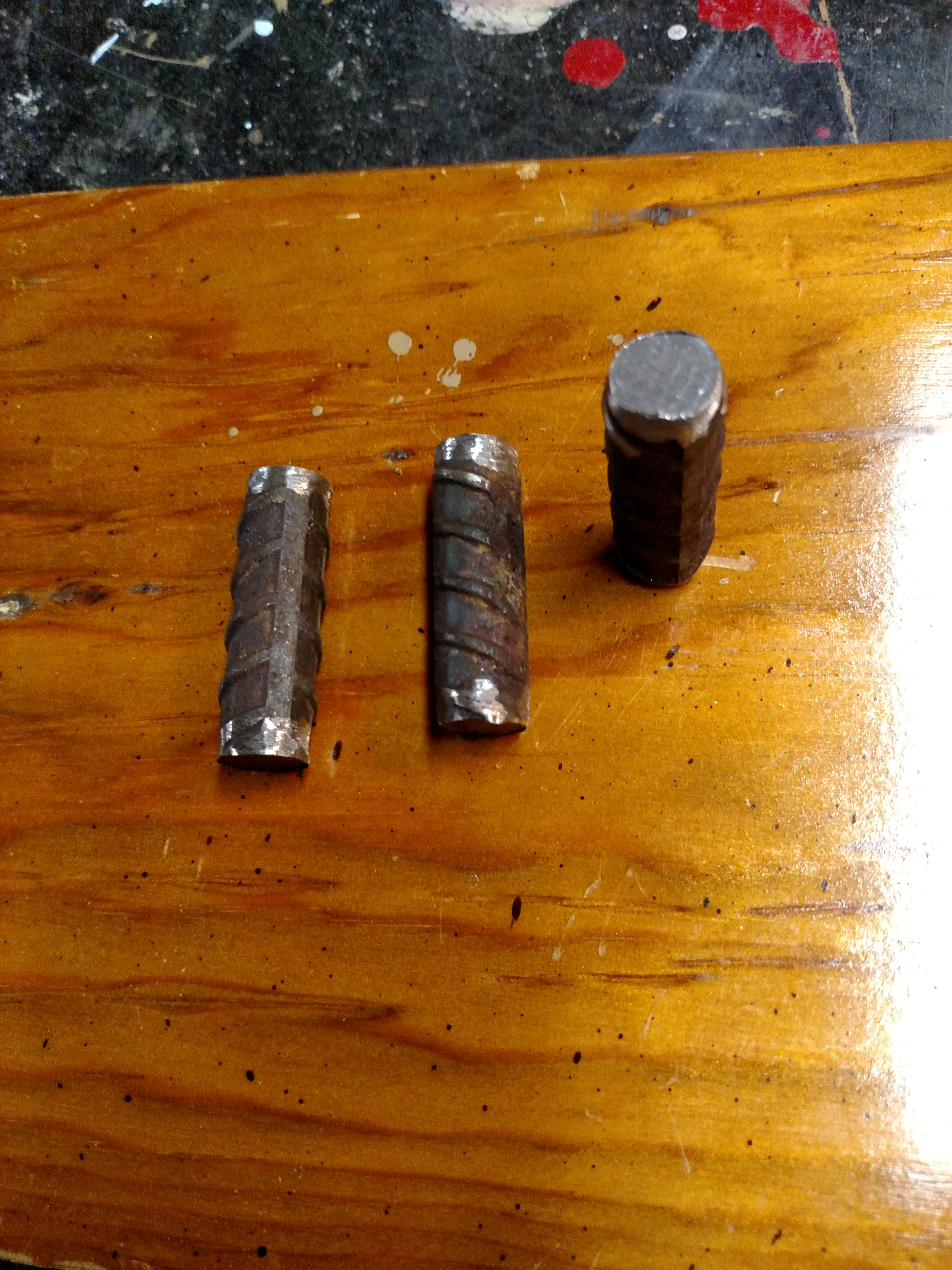

4: I decided to use the existing "holes" at the back of the grapple tine to hold a 1/2 inch bolt with its head cut on one side to flatten it so that no wrench would be needed on the bolt head as the grapple tine would hold the bolt head rigid when cut in this manner. Again the goal was no modifications to the original grapple, and side benefit of only one 3/4 wrench needed to attach the unit.

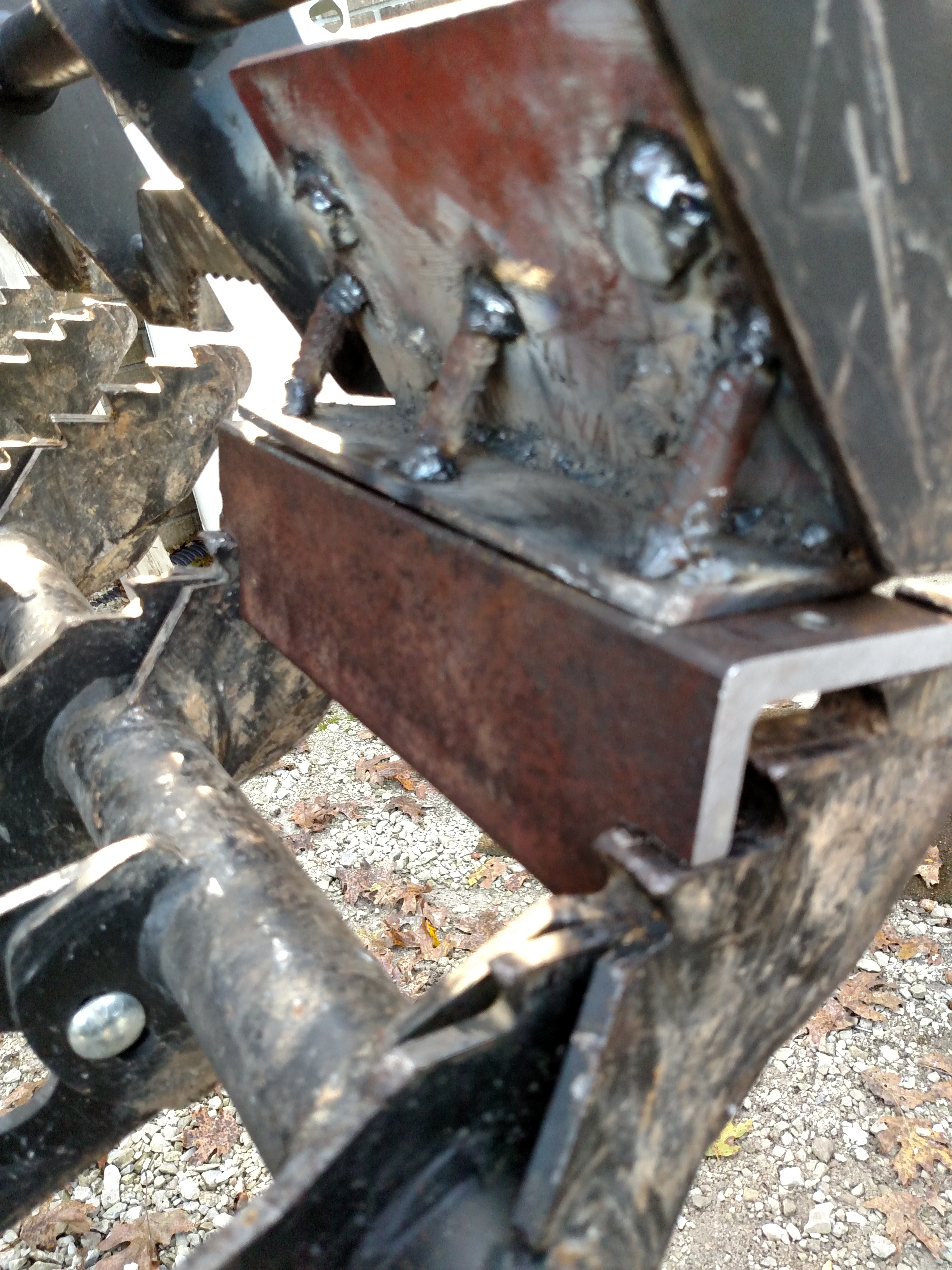

Here are the upper jaw supports prepped and ready to weld in to the existing upper jaw assembly.
This is the upper assembly after welding and then cooling while laying on the ground
Upper is now complete.

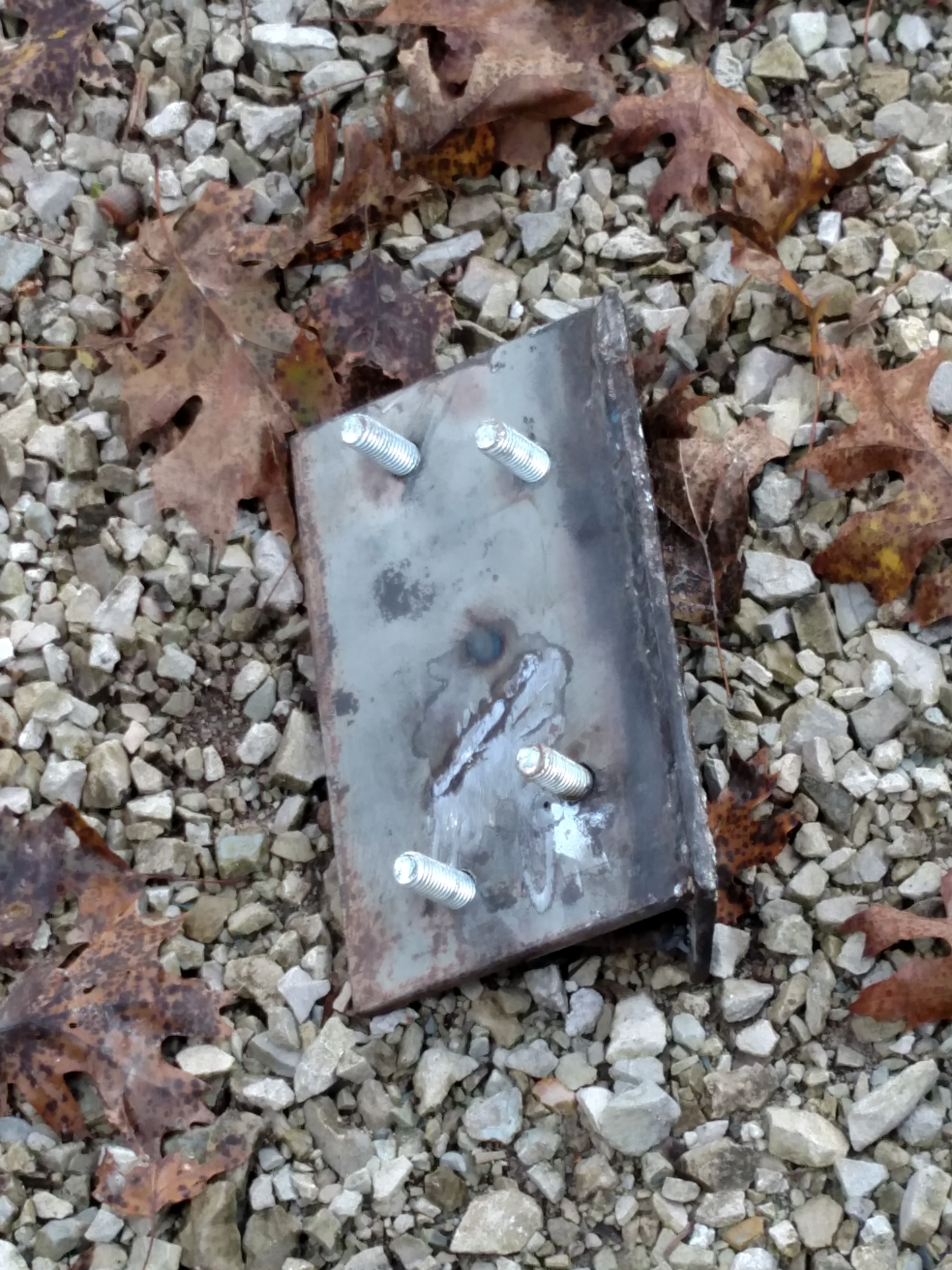

OK, upper modification is complete, lets move on to fabricating a new lower out of that structural steel angle

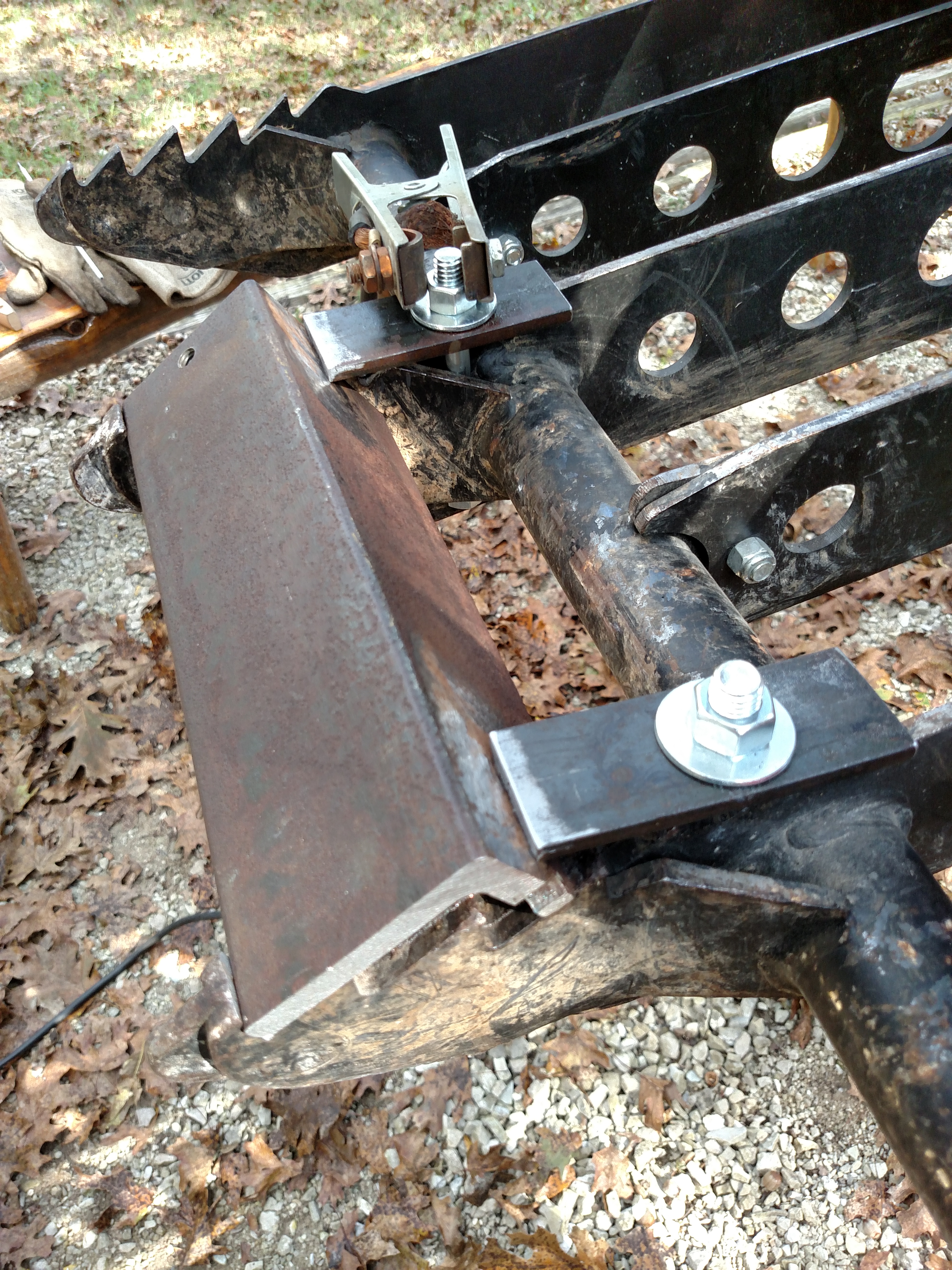

Here you can see the lower and upper being "fitted". Note some of the lowers material comes down between the existing grapple tines so this prevents side to side movement of the lower.

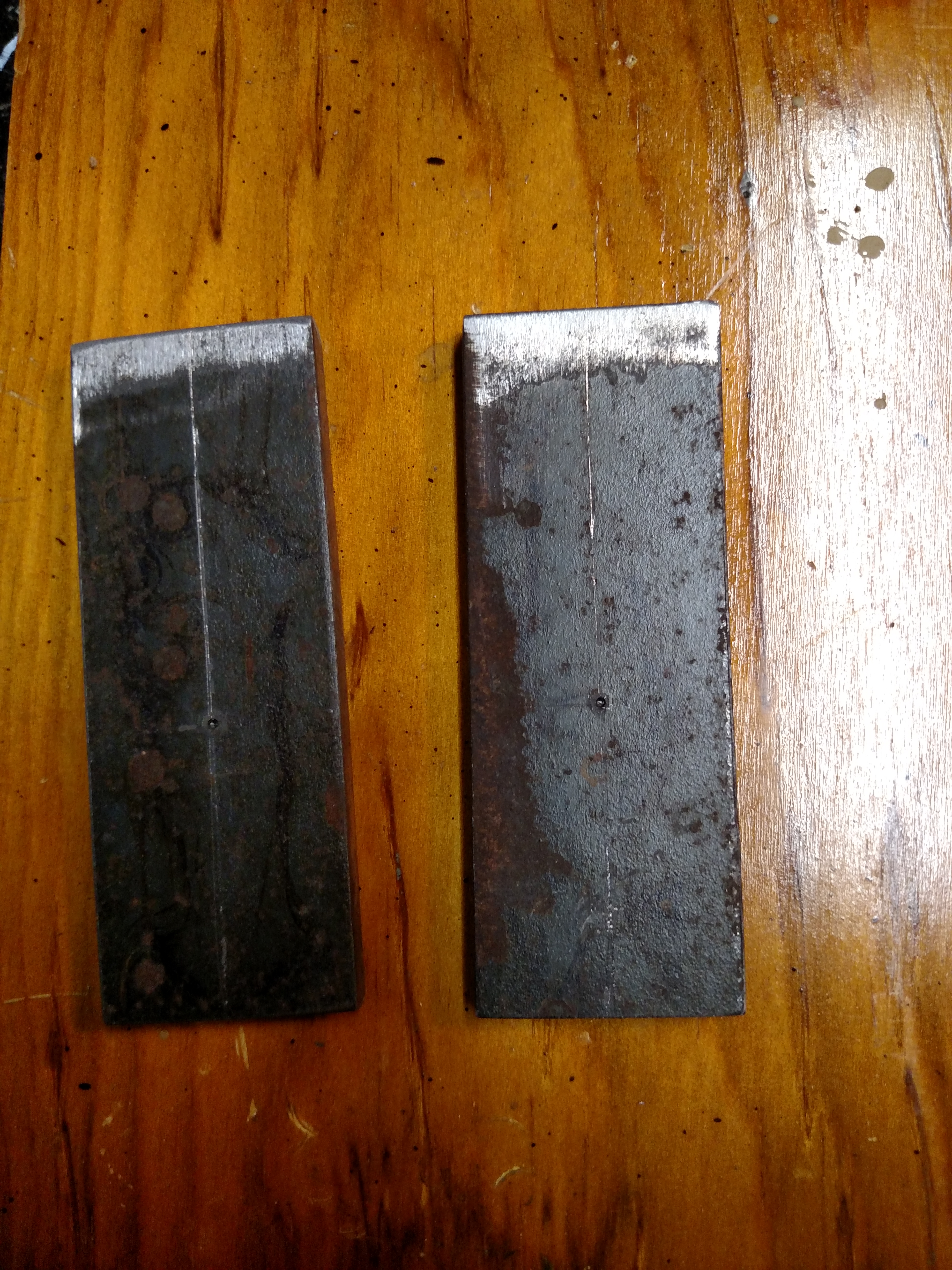

These are the back support straps center punched and ready for drilling. This will prevent the lower from moving either forward or backward
Straps are now fitted and ready for welding on, and here also is a detail shot of the ground off bolt head that is on the bottom of the grapple so that the head cannot turn, and only one wrench is needed to attach the lower unit.

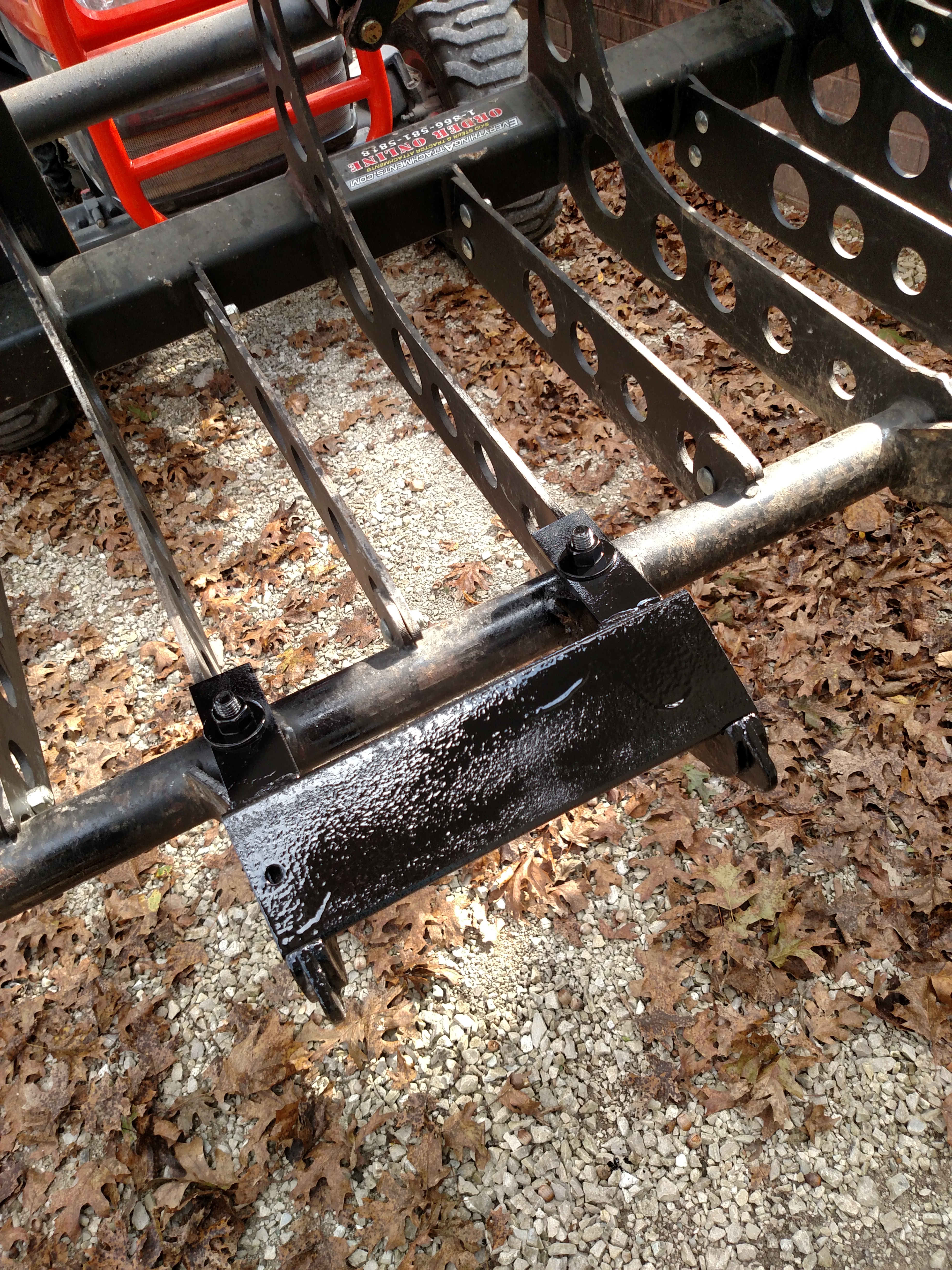

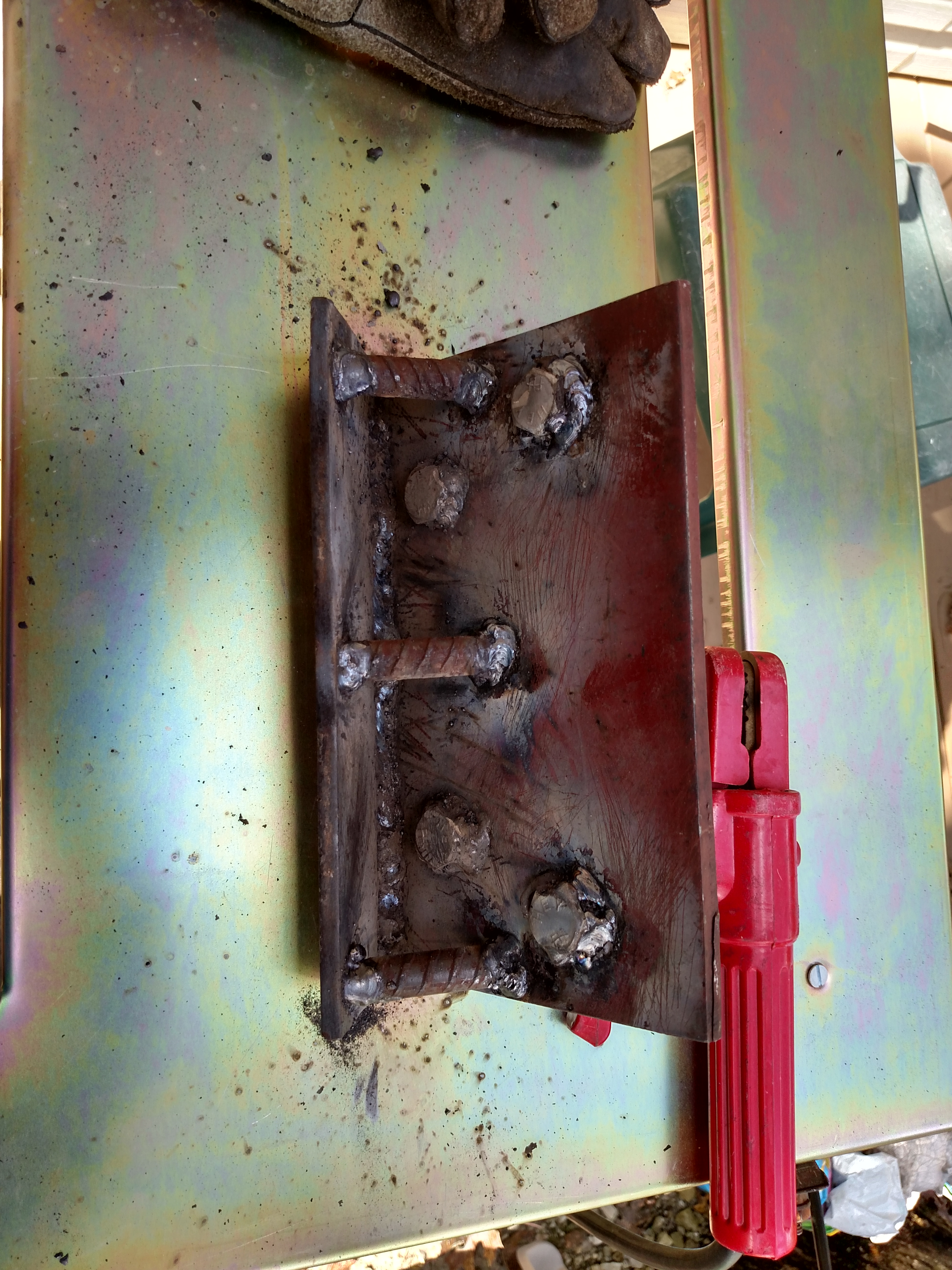

This is the lower showing it welded. I did take it off and weld the back side too, but that is not shown. Also not shown is how I had to elongate the holes slightly after welding as the metal stretched after all that heat application.:)

I think the original design goals have been met and the entire structure has been beefed up a bit and it now has a cleaner profile to grubbing in the dirt if need be. The cost is still just for the bolts and nuts and a few pieces of metal I purchased at some time in the past. The majority of the metal was from the scrap pile on the property when we purchased it. Most of it is structural steel plate and angle. I am not sure what that would cost if you had to buy it, but overall the cost of the project would still be fairly low even if you had to buy everything.
I used it for about an hour this afternoon and all looks well so far. I will keep you guys posted if any more mods are to be made. I may make some weld beads on this new lowers jaw facing, but I didn't feel like doing it today. In any case, that would be no big deal, because I have a welder. :cool2: If you don't have one, you should get one.:thumbsup:

James, great re-design! The two bolt end threads exposed look like they could be in harms way? Perhaps add a second nut, on each side, for thread protection?
