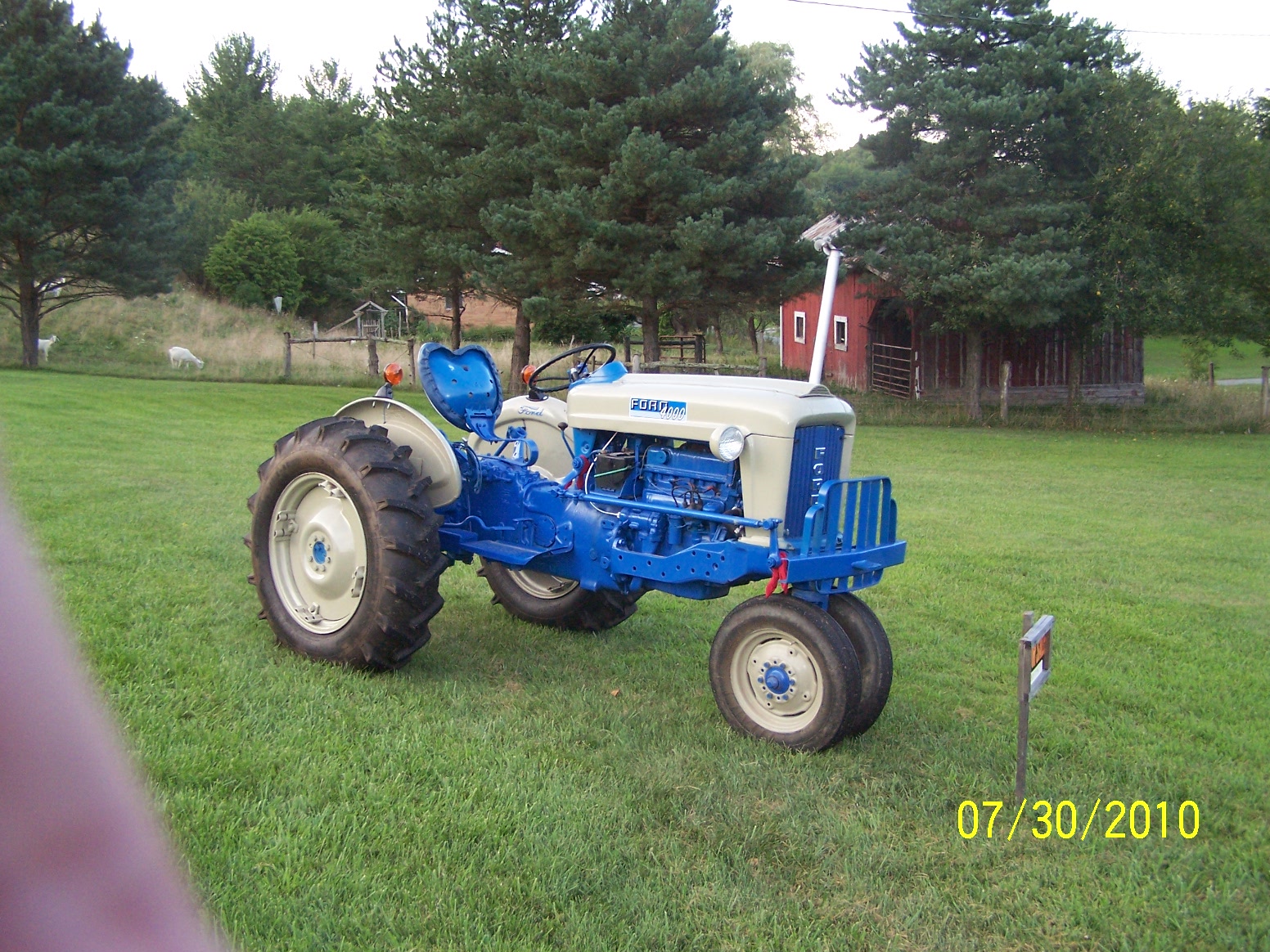

this was my summer project, 1964 ford 4000. new everything, except sheet metal.
   / my winter project #92
so can someone tell me how to use the power adjusted rear wheels? i know i have to unbolt the stays but how do i know when to stop the adjustment at the place where the stays hold the wheel? can't see them unless i get off tractor.
   / my winter project #93
Nice looking tractor. It looks almost identical to my 58 961, except for the paint colors of course. I've adjusted my wheels and haven't come up with a way yet to line everything up without getting off the tractor and looking. It's sort of a guessing game, but it is not hard and didn't take but 15-20 minutes to do both sides.

   / my winter project #95
I meant lining up the bolt hole on the inner rim with where the retainer goes on the outer rim. When the wheels are adjusted out you can see from the tractor seat, but as they are adjusted in it becomes very diffficult/impossible to see from the seat.

could set stops...
soundguy
   / my winter project #97
At the risk of asking a stupid question, how would I do that?
Thanks
   / my winter project
#98
depends on the PA rims you have. the ones on my ford 5000, I merely bolt the stop in and adjust till they stop moving.. then clamp stuff down.
soundguy
   / my winter project #99
I will take a look at mine again and see, it's very possible that I just missed the obvious and am doing it the hard way.
Thanks
   / my winter project
#100
if you have the pa rims like my 5000 you remove/reset the stop, loosen bolts, lube rails and then adjust.... then button her back up.
