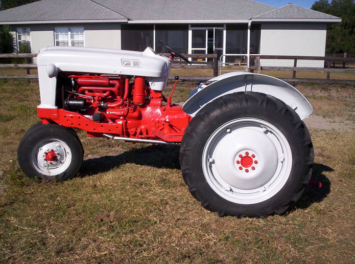

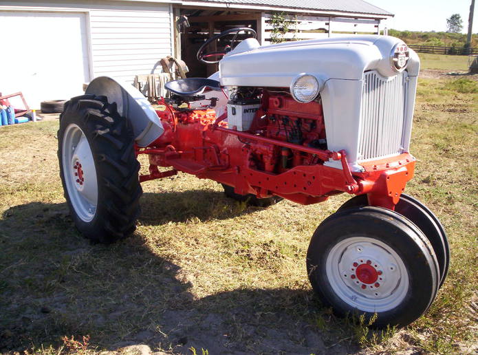

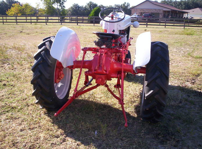

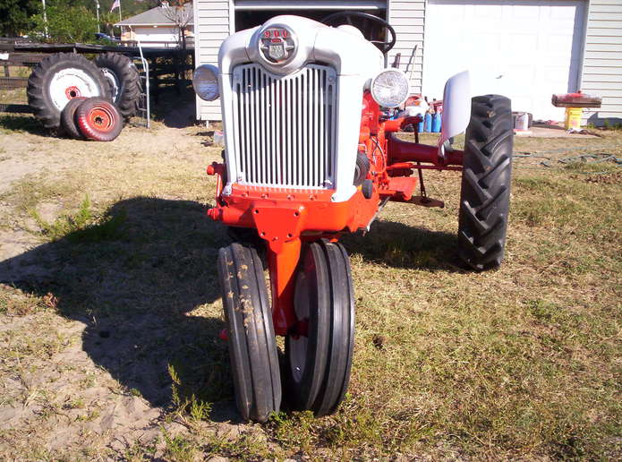

technically still got some 'winter work' left from this project. the oem power adjust rims are gonna take alot of rehab. someone welded them up solid. i'l demount the tires this winter, cut the welds out and at least get them adjusted the same, then remount them back up.
too hot to set outside with a grinder, sawsall and cutting torch right now.
soundguy
   / my winter project
#78
wired up the lamps this am.. solved a peculiar no start problem centered around the fact that I had only put in the old 1/4 gallon og gas I had drained out of her old tank, remarkably, after adding a couple gallons of gas left over for the lawnmower she kicked right to life.
preliminary report.
cold oil pressure 50 psi at mid throttle
hot oil pressure at idle 38
oil pressure with starter spinning and ignition off ( test ) up to 20 psi
Note.. I like the ford 12v genny better than a lucas 12v genny.
at mid throttle the ford genny was kicking 14.28v
lamps are run with seperate ground wires, left a 3rd stud out for a rear work light if needed.. wired and fused for 20a total lighting -if- needed.
starts as soon as you hit the starter button.. perhaps 1/2 rev.
crude spark test.. she'll make a 1/2" spark from secondary wire to block on the old set of points I got her with.
darn.. shoots lightening bolts for sparks and starts on 1/2 rev....begging for an electronic ignition 'upgrade' huh?
ps.. the 11.2 rears didn't ruin the experience. sure she sets a few inches lower.. but nothing terminal. probably make the mower ujoints happier than they are with the 740 and 13.6 tires on them..
