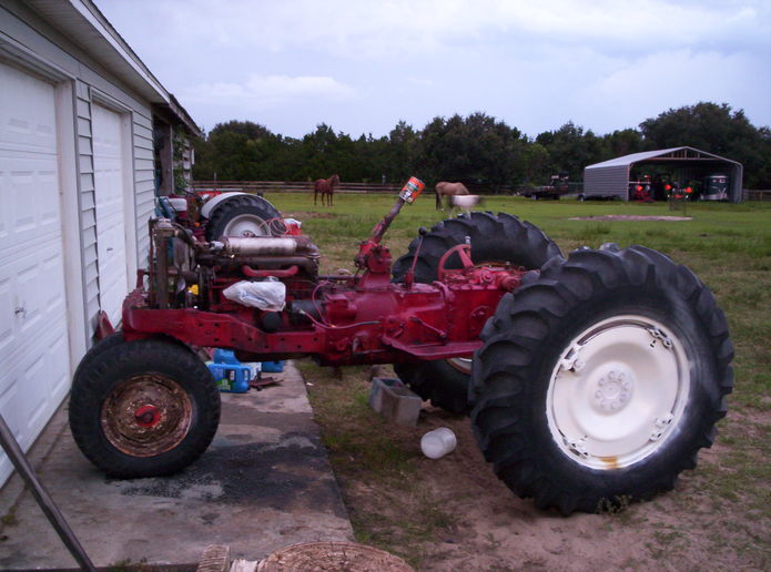

#15
here's a pic from yesterday.

   / my winter project #16
Man on mission going at it tooth and nail. ;)

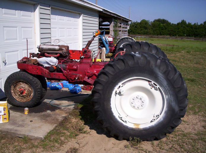

#19
pulled rad and fan off.. doctored a couple more bolts and broken studs.. ho hum..

   / my winter project
#20
well, finally finished lubing the steering pedistal. then started to look at the front wheel hubs.. hub ont he left appears to be from a later model.. it has the small cast in ears with a grease fitting between them like my 5000 does. also someone had drilled the cap for a zerk and proke it off. i extracted it and instead installed an inverted hex 1/8" pipe plug. while down there I notices some play in the right side so jacked her up toinspect and repack the front bearings. both sides had 2-part repair nuts on them.. and I'm not sure why.
left side had perfectly good threads.. right side had the first few threads wore down, but the threads after that were fine.. a castly nut would have had NO issues holding it all together. oh well.. cleaned it all up, packed and reassembled. front end is decenlt tight now.
decided it was time to start taking the beat up tin apart and salvage those doglegs. removed the gas tank tied tot he hood with a garden hose and bailing wire... set it safelt FAR aside.
got the o/a bottles out and started on the hood. there was some brazings on the outside connections, and the internal flanges were tack welded every few inches.
got it all apart.. and Imust say.. I am getting DARN good with that torch. glad I got it. so far it is my favorite tool purchase this year. one thing though. I did find out that once you torch the doglegs off the hood, and then you go to rotate the hood around to get the other side.. don't let the inside of yer right arm contact the hood near the warm spot! Yep.. it was so hot outside today I didn't wear my welding jacket.. only my long welding gloves.. got a nice half dollar round spot burned on the underside of the right forearm.. dropped the torch! torch stayed lit and landed right on the hoses!!.. snatched it up quick.. man.. that woulda been bad.. :( oh well.. no melted hoses.. but Imust say.. I won't have hardly any grinder work on the doglegs... I torched them out nearly perfectly.. I'm still tickled with myself..
that was pretty much it for today.. had to go in.. wash up wrap the arm and get to work!
