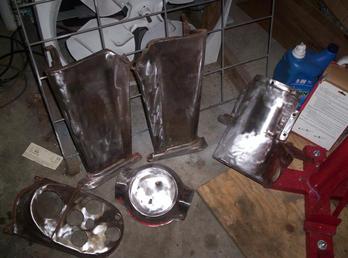

got home from work at 10:30pm.. didn't feel tired.. so got the grubby work clothes on and went out to the shop.
I had a few things on my mind to try.. I had picked up a decent looking set of wire cups, and wheels, knotted and straight, plus a couple arbor adapters. these are made to fit 'most' 4.5" angle grinders.
I figure these things will tank paint off good.. but I didn't want to tie up my good angle grinder with one of them..
I had a box of 3 broken chinese angle grinders, and decided to see if I could make 1 from 3.. and did.. armature from one.. head from another and field and brush body from another. it has 2 handles, and is quite decent looking. i fit the biggest guard of the 3 on there and then the knotted wire cup. use dthe best of the 3 sets of brushes.. etc.
bottom line.. it ran good. still wasn't tired.. so dug around in my goody box and found some 'still good' black 3m pads, so chucked one intot he drill press, then adjusted belts for high speed. proceded to stript he doglegs, dash, dash cowling and nose piece down to shiney bare metal. did a small bondo repair to a ding int he nose.. came out awesome, and hit it with 80, 220, 400, then 800 paper.. dash cowling is a spare one I had, and is in better shape than the one that came witht he tractor.
it has 2 cracks i will need to drill stop and spot weld, otherwise it's good. i had a spare dash as well, and it's in about 5% better condition than the one that came on the tractor.. so again.. I used my spare.
.. after that i laid the hood center section up on the bench and started at it with the knotted wire cup.. then my internal buzzer finally went off and said.. ok.. your tired!
here's a progress pic!
sorry about the size. my usual upload place is having some repairs done.
soundguy

had a few hours toady, so I worked on the hood center section and side pieces and got them polished down to bare metal. on;y piece of tin not really done is the grill..
I have the tinwork dry fit on the tractor right now with the fasteners loose, just to check fit.
*MIGHT* get some tinwork priming done tomorrow...

an updated pic as it was too dark last night for pics
