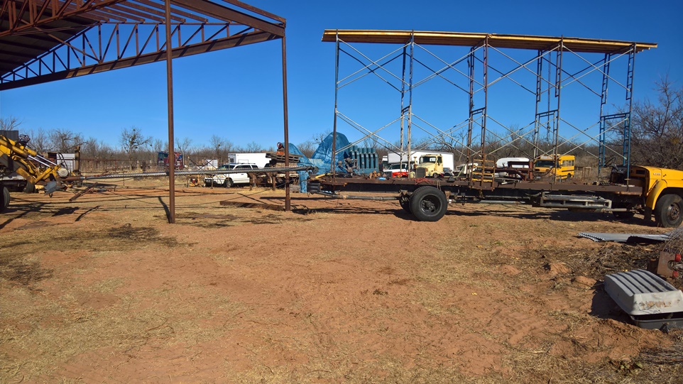

That bus scaffolding is pure genius!!!
It is a fair amount of a work out getting it moved around into position by myself using either a 1 ton pickup or the back hoe to push and pull it getting in and out or up and down and wrestling the steering. but so much better than trying to move or set up scaffolding where I need it and I am sure not going to do any extended work that high up from a ladder

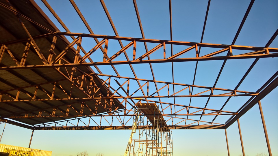

only 3 more purlin to weld in place then I will be excavating holes for some columns in the end walls

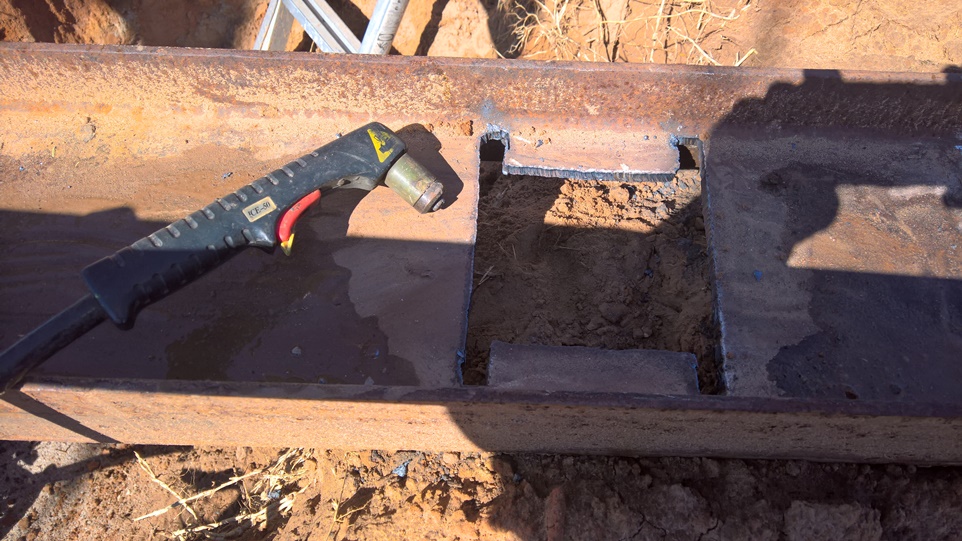

Now that all of the purlin are in place and the bus scaffold is relocated
It is time for something else

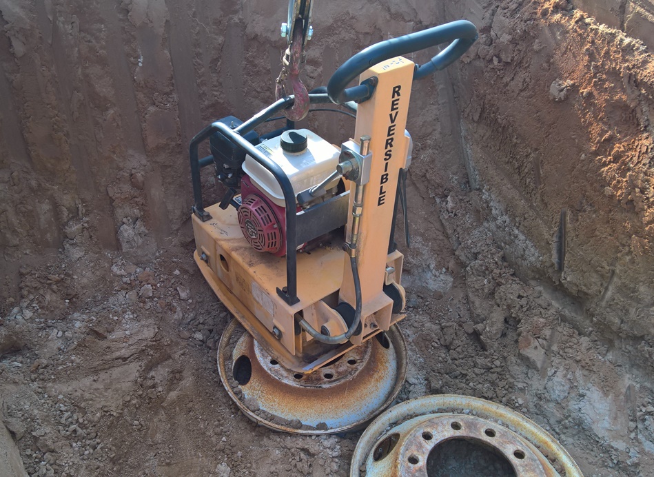

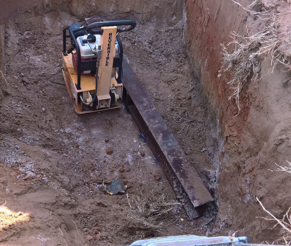

I'm preparing the base for the beam column that will be in the east wall. Later on more steel will be added to the column to make it the head piece for a rotisserie , which will also double as a weld positioner and an anchor post for frame pulling it will also the door stop for the double sliding 26 ft. door that will be on that side

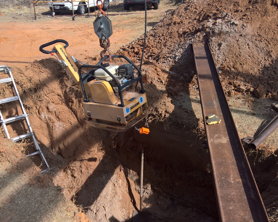

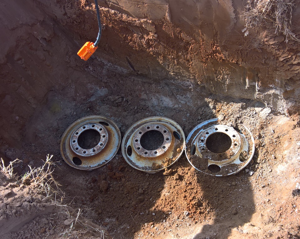

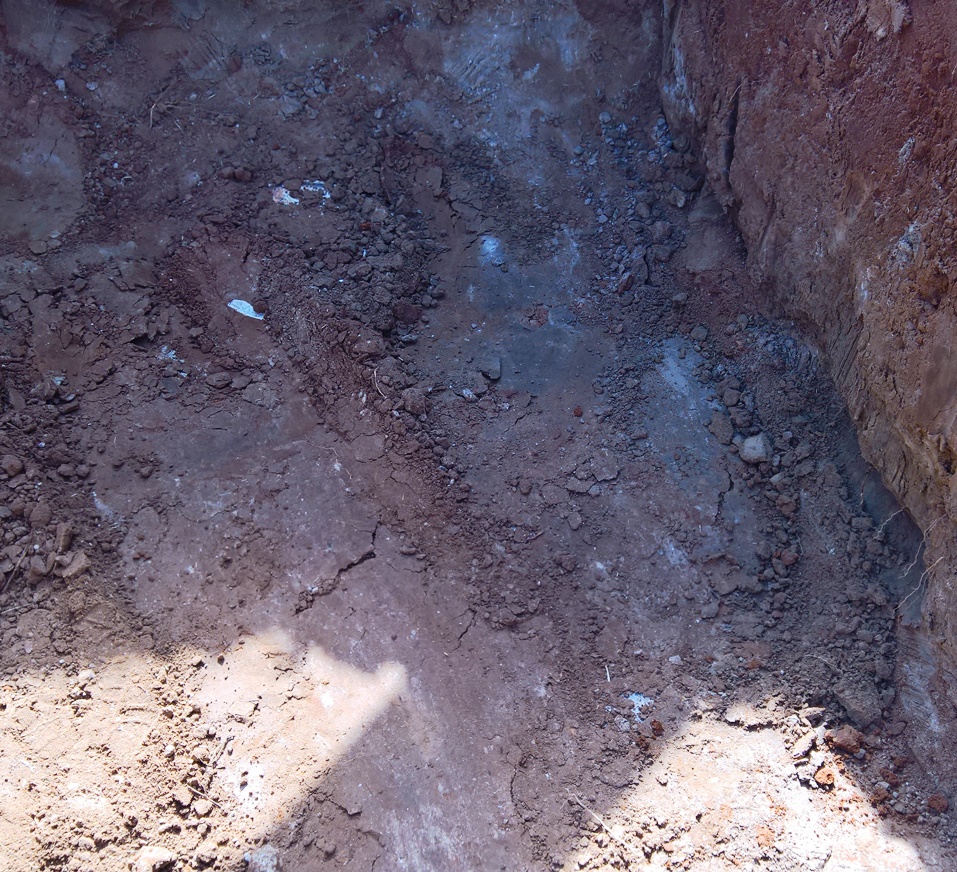

But I wanted to have an extremely solid embedded base under the column so I started by excavating a hole just over 6 feet deep or about a foot and a half into blueish white clay

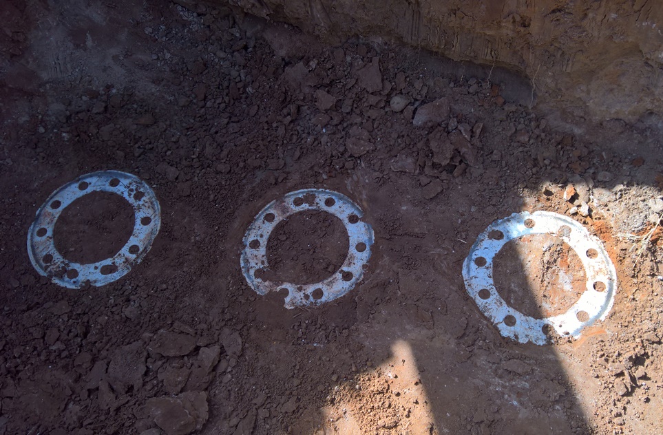

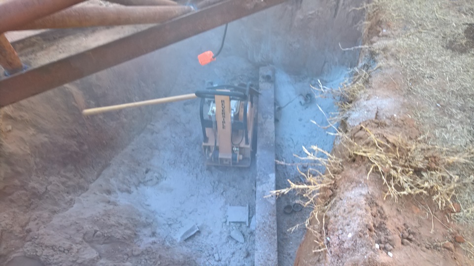

then dropped in 3 truck rims and used my plate packer to vibrate them into the floor
The worst thing was before I could even get started compacting I had to pull the carb off the engine and clean it as the last time I used it I forgot yo drain the gas and pour in a small amount of $30.00 a gallon stabilized chainsaw fuel then run the compactor a couple minutes on that stuff
As you might see the gin pole set up is proving to be quite the asset
dirt back filled and packed
scrapped away to expose the rims for welding a connecting beam to them
The connecting beam welding in place, more wheels and beams to be added tomorrow

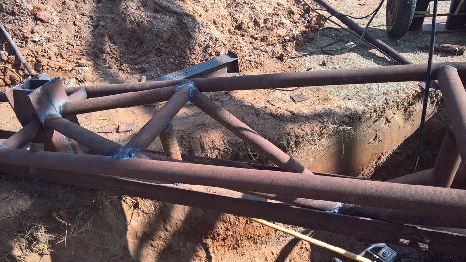

Had a little snow interrupt progress, well to be exact nearly 14 inches of the stuff
Most of the snow was gone in 3 days and on the 4th all of it was gone in the 76° temp. we had that day.
had 2 clear days to get some work done then on Monday back down in the low 30s and rain most of the day rained off and on all day Tuesday and Wednesday morning then dropped to the low 20s before warming to the low 40s in the afternoon although a little windy.

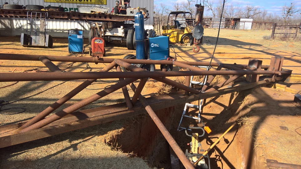

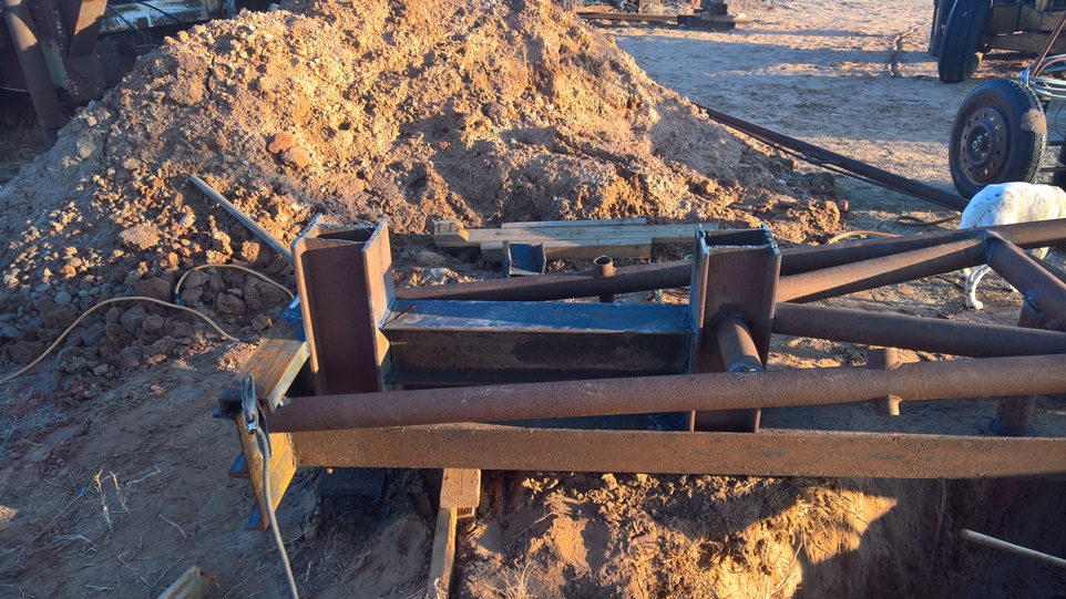

This is what I am trying to get finished fabricating to go in the large hole I have dug
In the construction industry it could be called a HERO or HERCULES or Master column which is usually the strongest column in an building and may or may not have more than a single specific purpose.
Which this one will be and will have.
More that just being a column to support the near center of the end truss and to help prevent racking or twisting of the building in high winds. this column when calculated in conjunction of the to corner columns on the opposite end of the building form a triangle of support but this one will be employed to serve as the basis of a rotisserie or power end of a spit for turning trailer or other large items on their side or upside down this will also serve as a rotary positioner for fabrication of large weldments as well.
Given the nature of the future intended use and strength I wanted to build into the column I figured it would also be prudent to include a hard mount for future jib cranes to be swung from the column. Once the column is in place and later the corresponding tabernacle bracing which will run the length of the building connecting the trusses together and radiative bracing leading from the attachment point of the master column to the next truss I will be more than able to secure a pair of 20' long jib cranes from the hard mount I have fabricated, which will allow me to hang 2 ton hoists or larger from them. If I were to limit the length of the jib cranes to 12 feet or less I could safely install 4 ton hoists from them once every thing is tied together as I anticipate eventually doing.
Part of the reason for the elaborate pipe work on this column was due to the 12" beam I had planned to use turned out to be about 8 feet too short so I had to use my 10" beam which was only 19 lbs to the foot and only has a 4 inch flange making unsuitable as a standalone beam for the column without a lot of build up. Of course the face which will have the elevating power head would eventually have more structure added to it anyway but that would not ad sufficient section to the column to resist twisting forces and bending moments of jib cranes so other that the power head it would be little more than a glorified door stop
Now as it is with over 80 feet of 3 inch pipe welded to it I think all will agree I have accomplished 80% of what I was seeking with a safety factor of 2.5 or better
