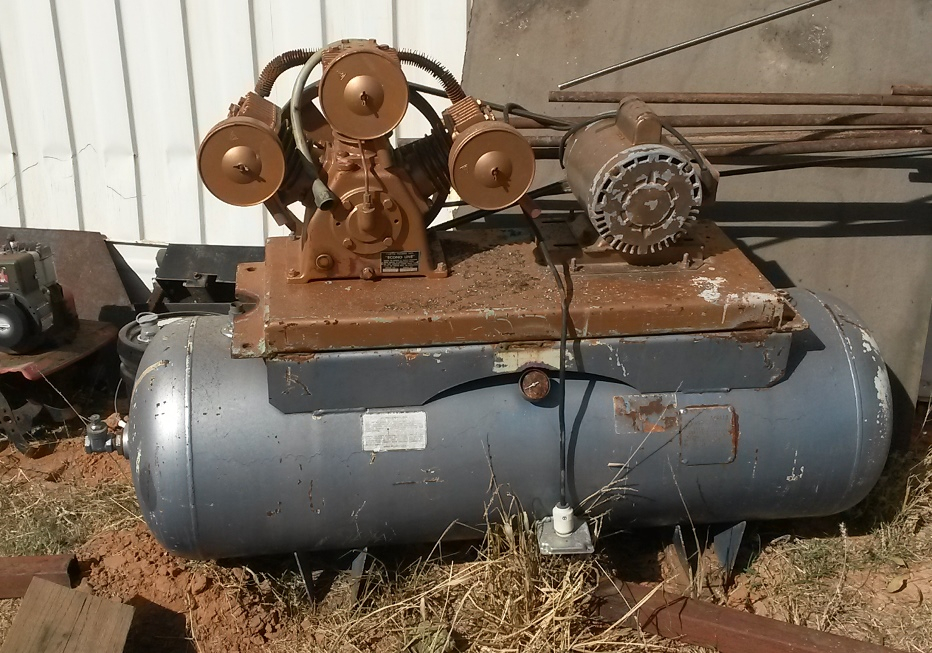

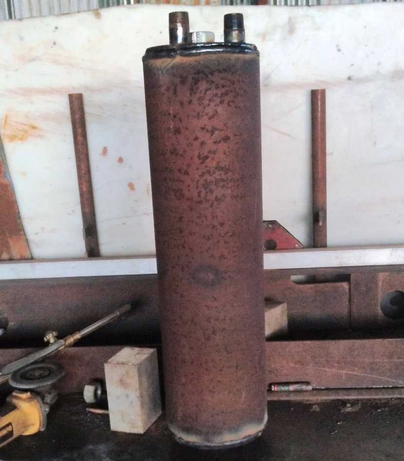

Finally getting around to start plumbing an air system in the shop I will eventually be running a 1 1/4" sch 80 steel pipe system throughout with surge tanks and water traps at every drop station
Currently I just have a single air compressor connected to the initial start of the system the Compressor is a 3 cylinder single stage with a 15" dia. pulley powered by a 5 HP 1740RPM 215or 230 frame don't remember which, single phase motor with a 3.5" pulley mounted on an 80 gal tank. I just tossed the whole thing together using components I had laying around.
Right now with about 30 feet of pipe installed and a single surge/ water trap bottle installed it takes 10 minutes to go from "0" to 110PSI I still have a yet undiscovered small leak in the system it could be the quick connect at the hose end as it takes 6 hours to lose enough pressure to cycle back on @80PSI then shuts off @110 in under 2 minutes. If I shut off the main valve it takes 10 hours before it cycles in either case I can live with that.

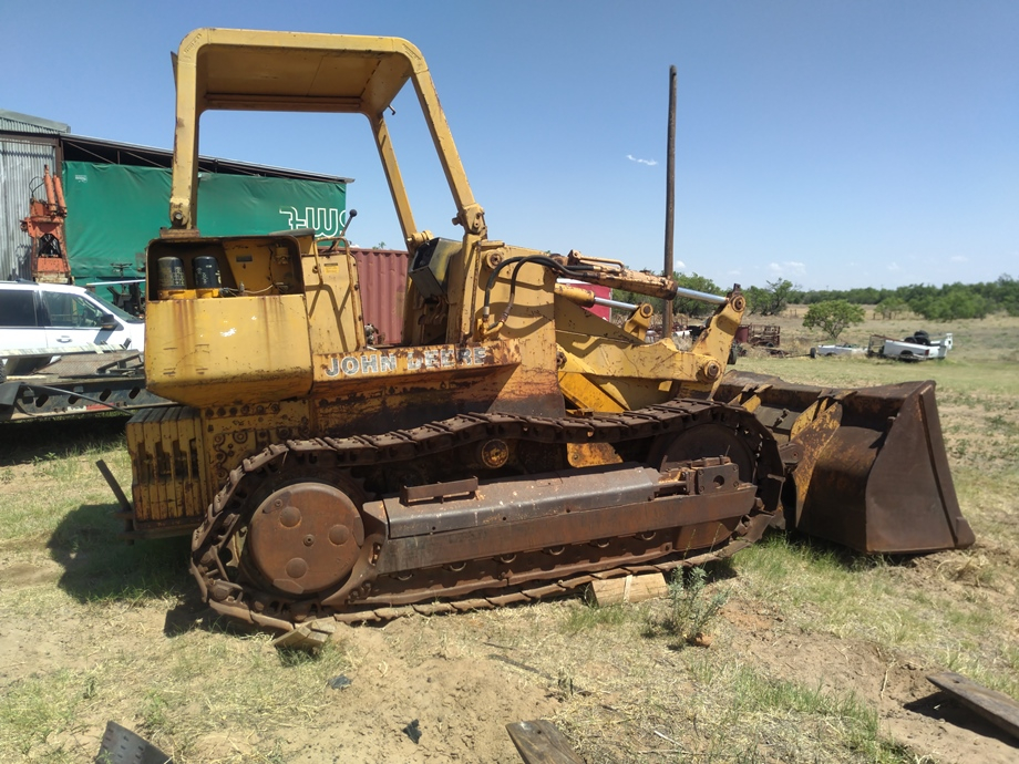

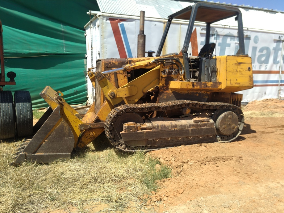

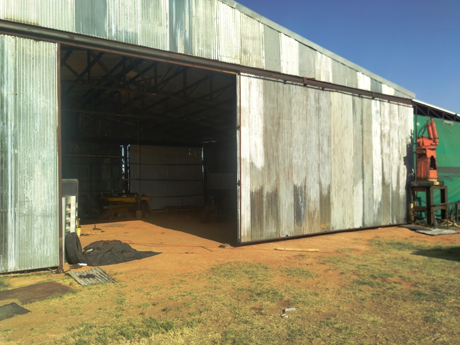

I now have a 33 ft door hung on the front of the building so I can close off all but about 15 or 16 feet the door rolls all the way to the east except for the last 4 feet of the opening so I still can have a 44ft wide opening if needed
Also 2 of my latest additions toIMG_20220513_152426jd2.jpg my tractors and equipment
My big forklift moving the loader that does not have an engine
